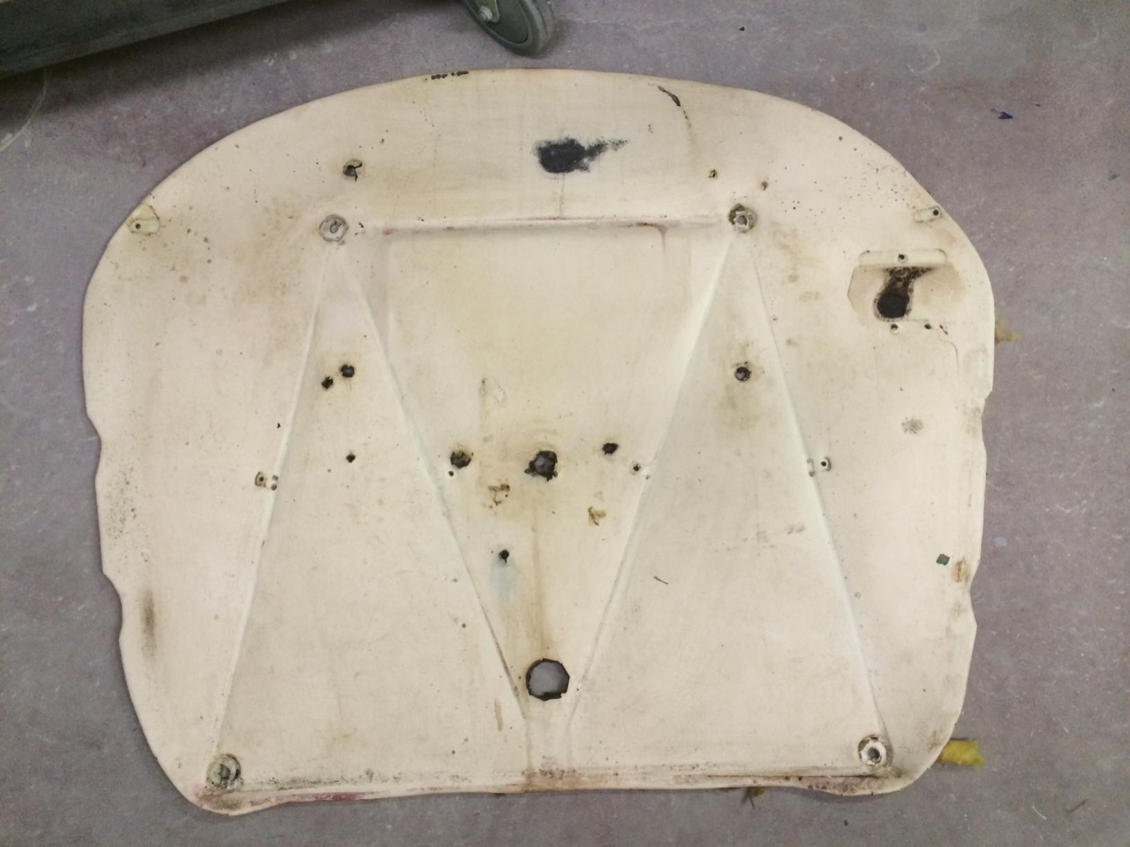

    Ever since I've owned this airplane, I have had three interior panels on the inside of the boot cowl.
    In the interest of weight savings, I've decided to leave those panels on the ground and just paint the inside of the boot cowl.
    But my IA is questioning whether the panel behind the firewall needs to be there (because it was squashed between the firewall and the fuselage frame).
    Does everybody have something between the firewall and the frame? Or do some folks have the firewall bolted right up to the frame?

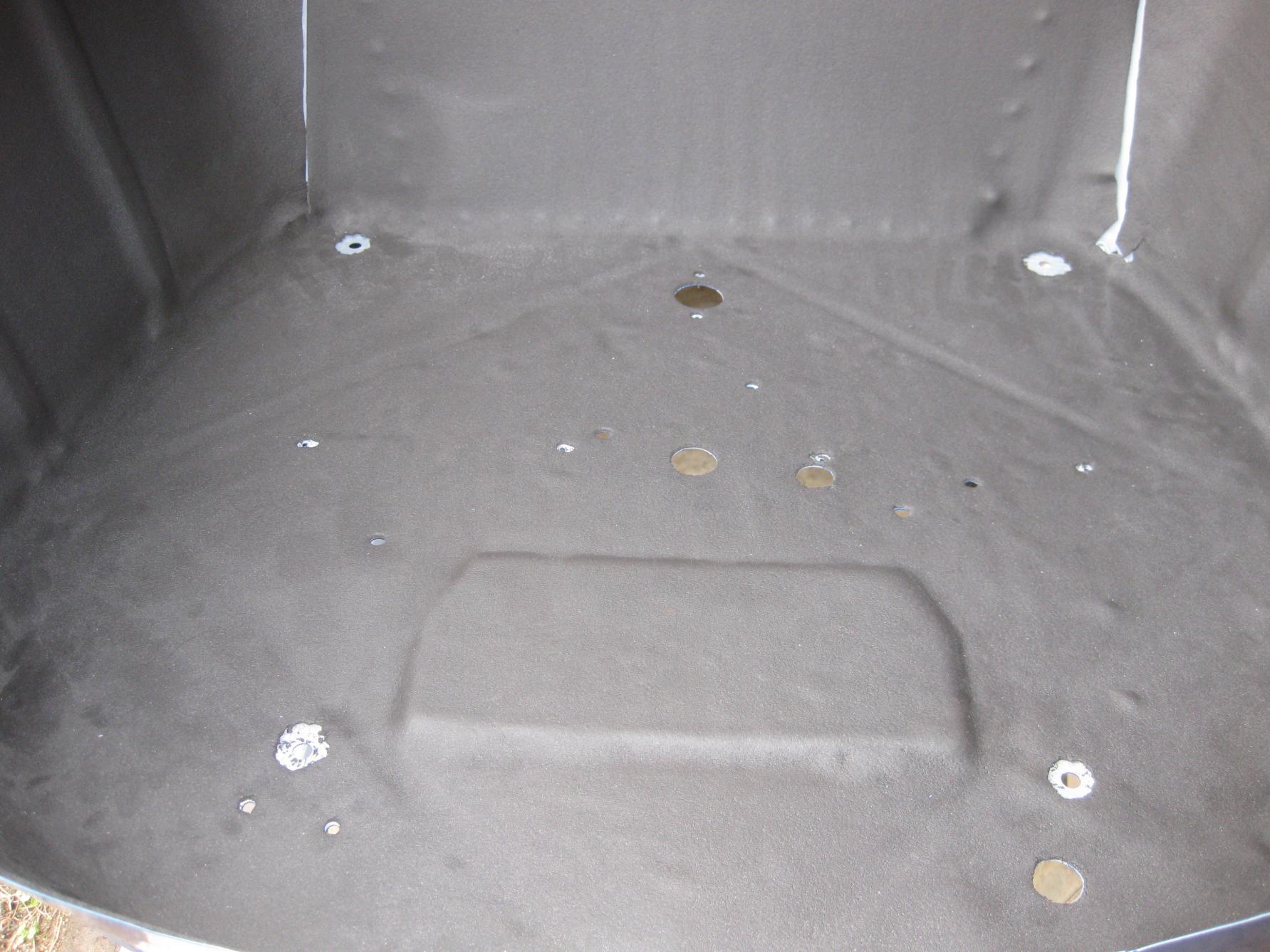

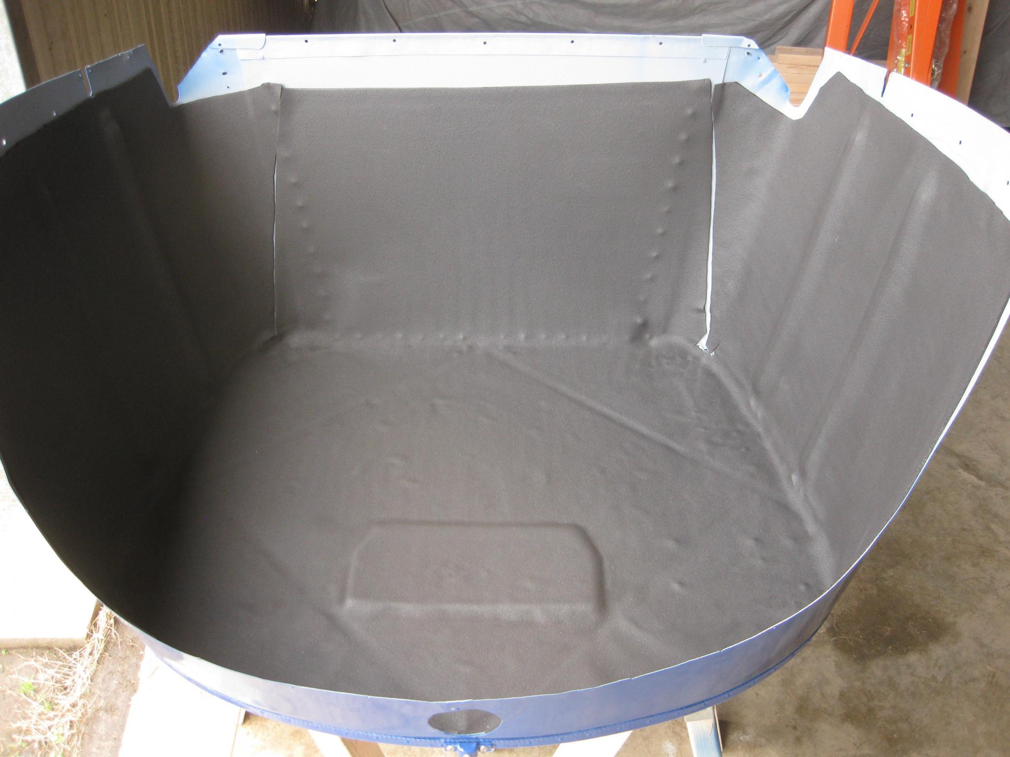

                  Mine came without it, I installed it, 1/4" fire resistant foam with a foil backing. Made a big difference. That steel firewall is like a bell with an aluminum sound ring....the weight is negligible and the reduction of heat in the summer helps too.

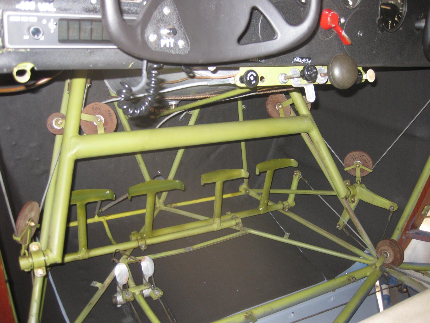

                    When I got my "T", it had closed cell aluminum foil backed foam insulation glued to the firewall inside the cabin. About 1/2" thick. Whoever installed it did a good job of fitting it, but it had some gaps along the steel tubes. I.E., it was not sandwiched between firewall and tubes. This foam was also stuck to the kick panels and inside the doors. And underside of glare shield. Even the fuel tank was covered. I removed all of it, installed new Airtex door and kick panels a few months ago. I don't perceive any difference in noise levels, but I always fly with ANR headsets. Also, I do not feel any increase in heat, but weather has been cooler. I am waiting to see if August will be hotter in the plane this year.
                    BTW, the foam insulation is the same stuff Mooney factory sent me to replace original fiberglass to comply with AD on my '62 C Model. It did reduce noise, but I bought extra and did entire cabin/baggage area.

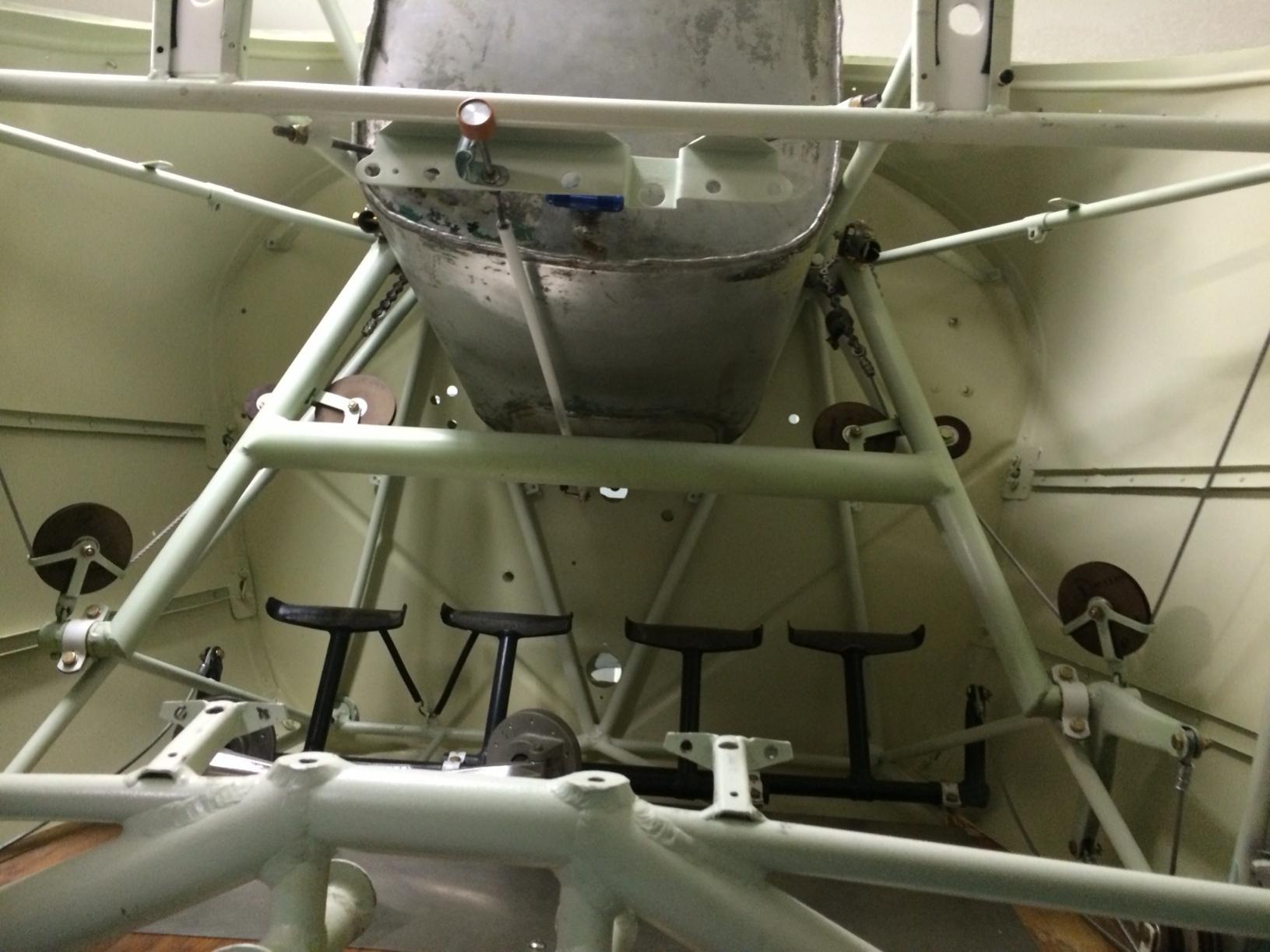

                      Tim there is nothing on my fire wall it's not that noisy.

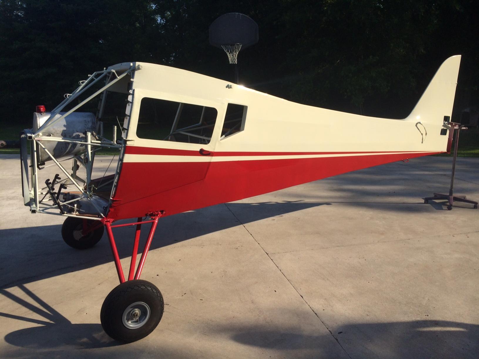

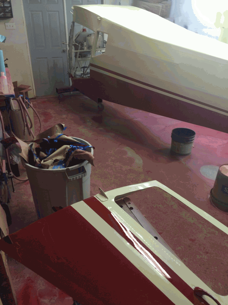

                        Below is a picture from last night after painting the red trim color on my fuselage and doors.
                        The boot cowl is all masked for red paint. So the timing is right to figure out what to put on it before I install it.
