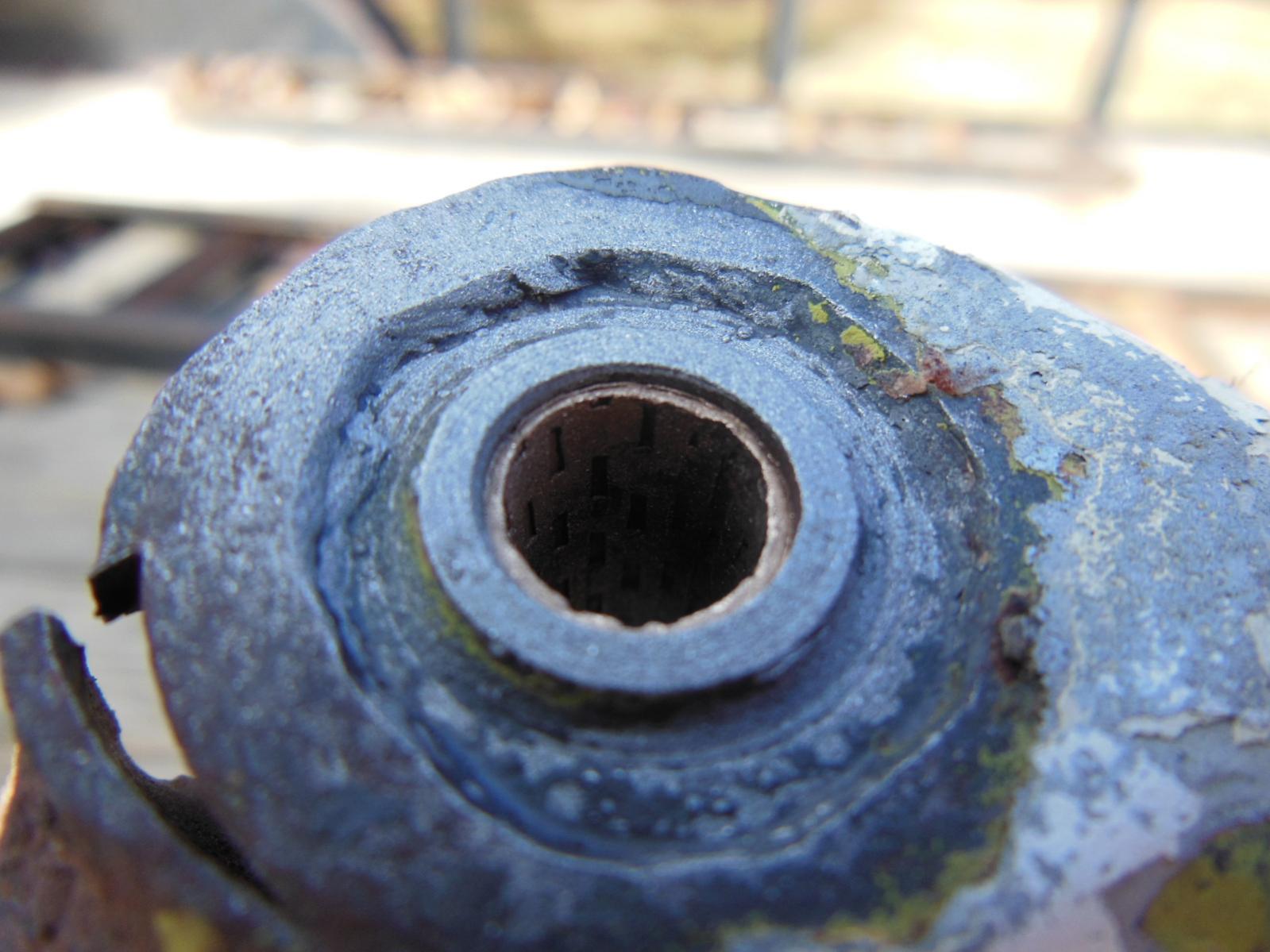

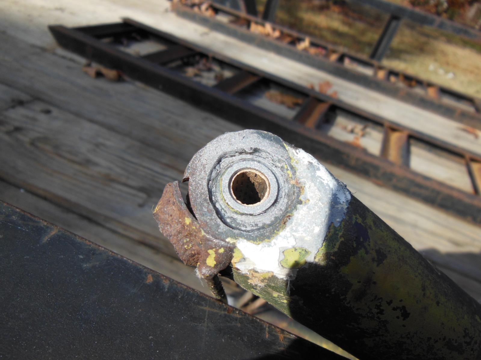

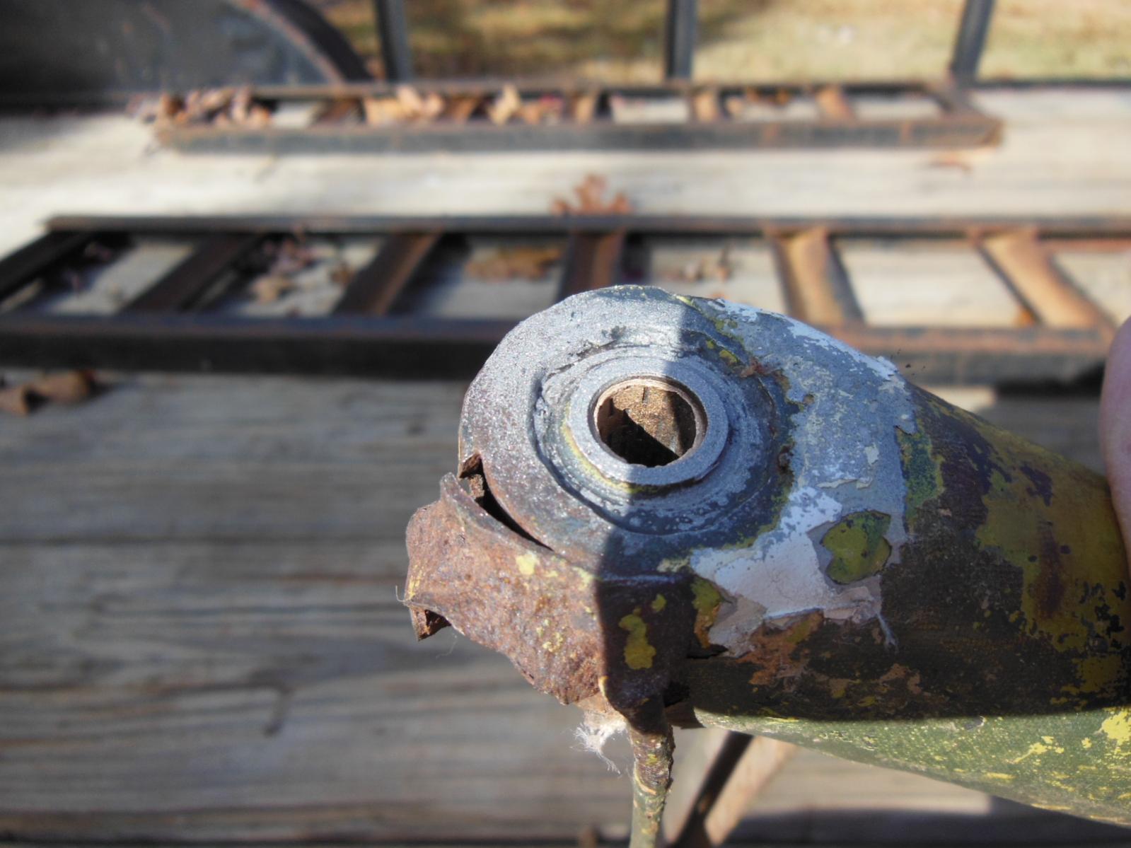

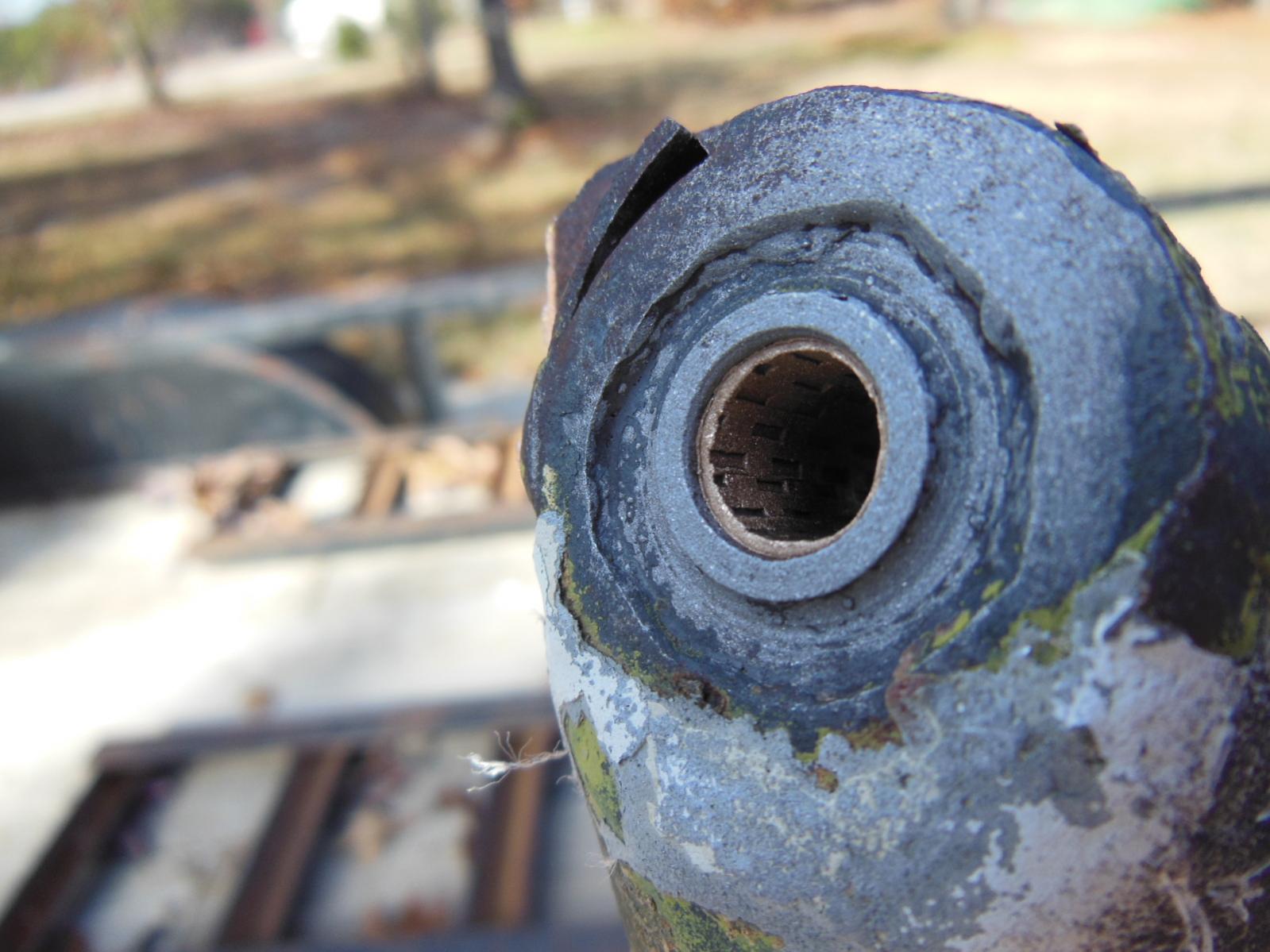

                  a picture is worth...
                  this is/was a "B" model gear that got busted up
                    Re: Landing Gear Bushing Size Needed or Source
                    Thanks Dave! A picture answers a lot of questions. My measurements earlier were wrong. I was measuring the outside of the area where the bushing presses in. My bushings are flush with the end of the hole they press into. With all the paint on them, I thought the 1/2" diameter part was the end of the bushing. Makes a lot more sense now.
