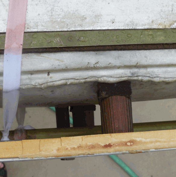

Well, Tim, at least they padded the ends of the broom handle. That almost looks like closet clothes rod. Well, whatever is hanging around the work area apparently gets used.

Right. I replaced all of the 3/8" channel in my wings. These pictures are about two years old. My wings are all back together, ready to cover. My ailerons are covered already.

Tim,
Looking at picture #2, it also looks like the 3/8 channel angle renforcements are corroded on the ends. This seems to be a fairly universal problem as any water that bypasses the drain holes in the fabric pools in the aluminum trailing edge and corrodes these steel pieces badly. Since the channel is readily available, i just made new ones.
I have seen additional drain holes poked in the very rear of the trailing edge in (I guess) an attempt to clear this water pooling tendency.

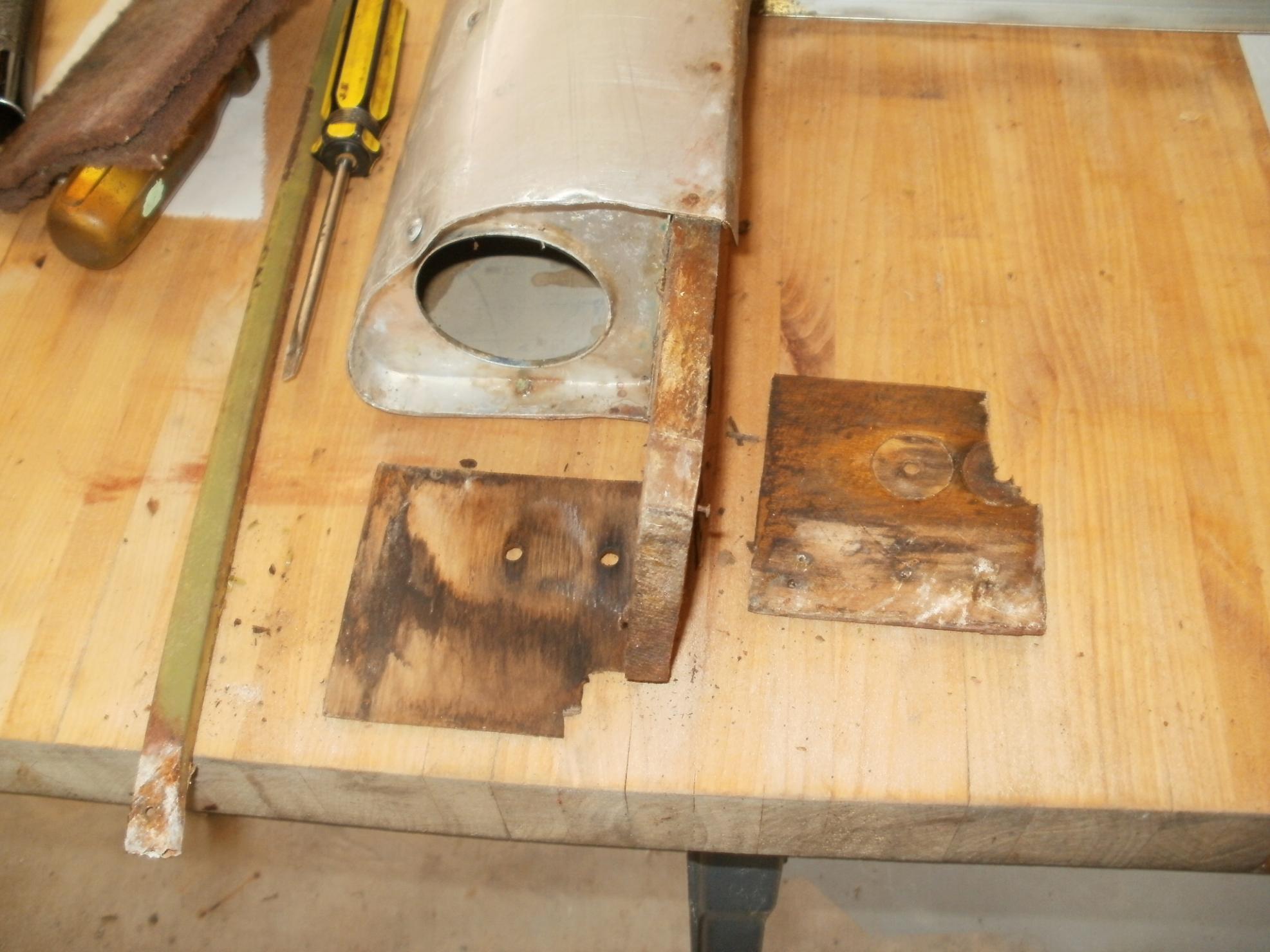

Re: Things to look for , when rebuilding wings
The picture below of the broom-handle pieces that I found in my wing (between the butt-rib and the wing tank) are just a reminder to look out for any questionable work that may have been done in the years between the factory and your ownership.
Also, the 1/16" plywood reinforcing plates beneath the aileron hinge hardware (on the aileron spar) just fell off when the hardware was removed. I cleaned up the area and glued on new plywood.
