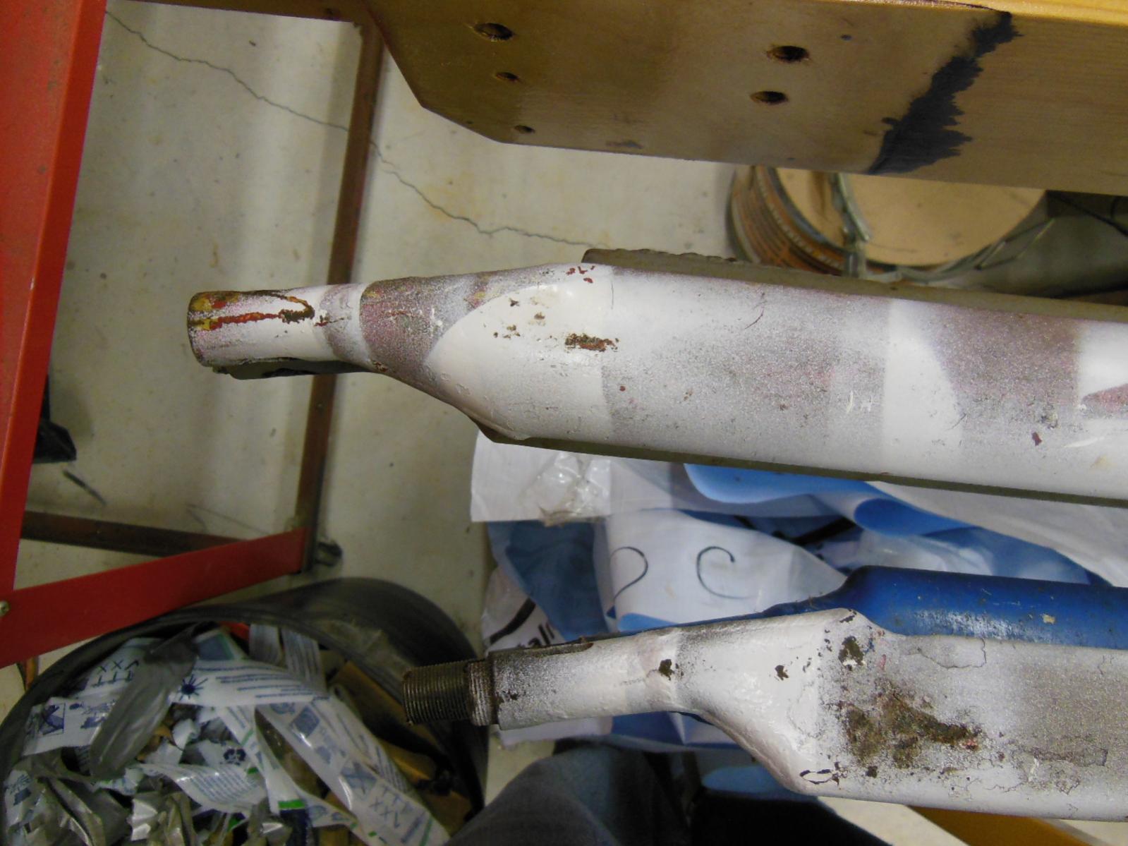

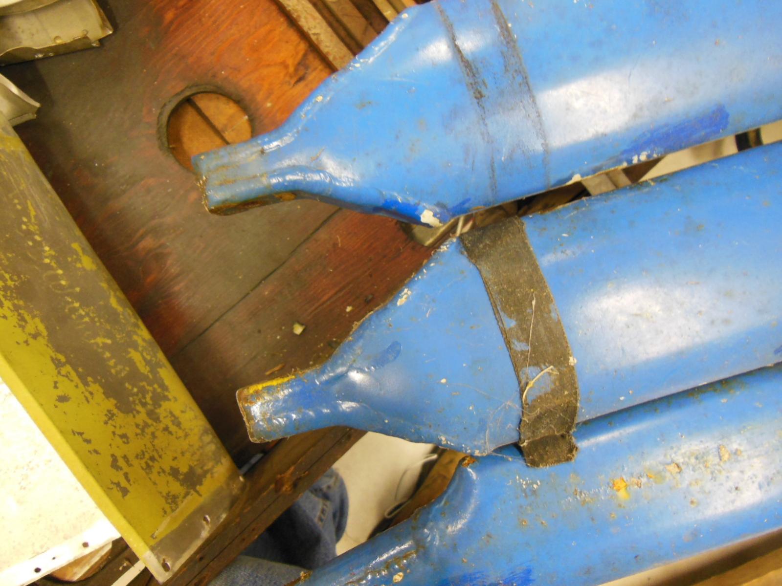

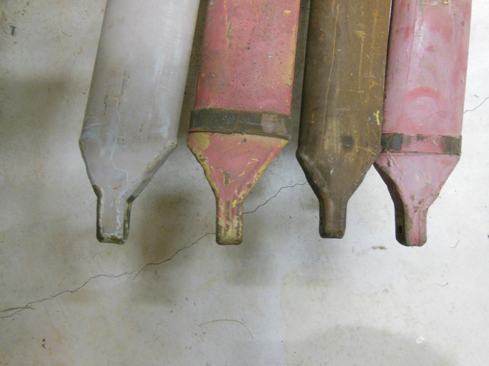

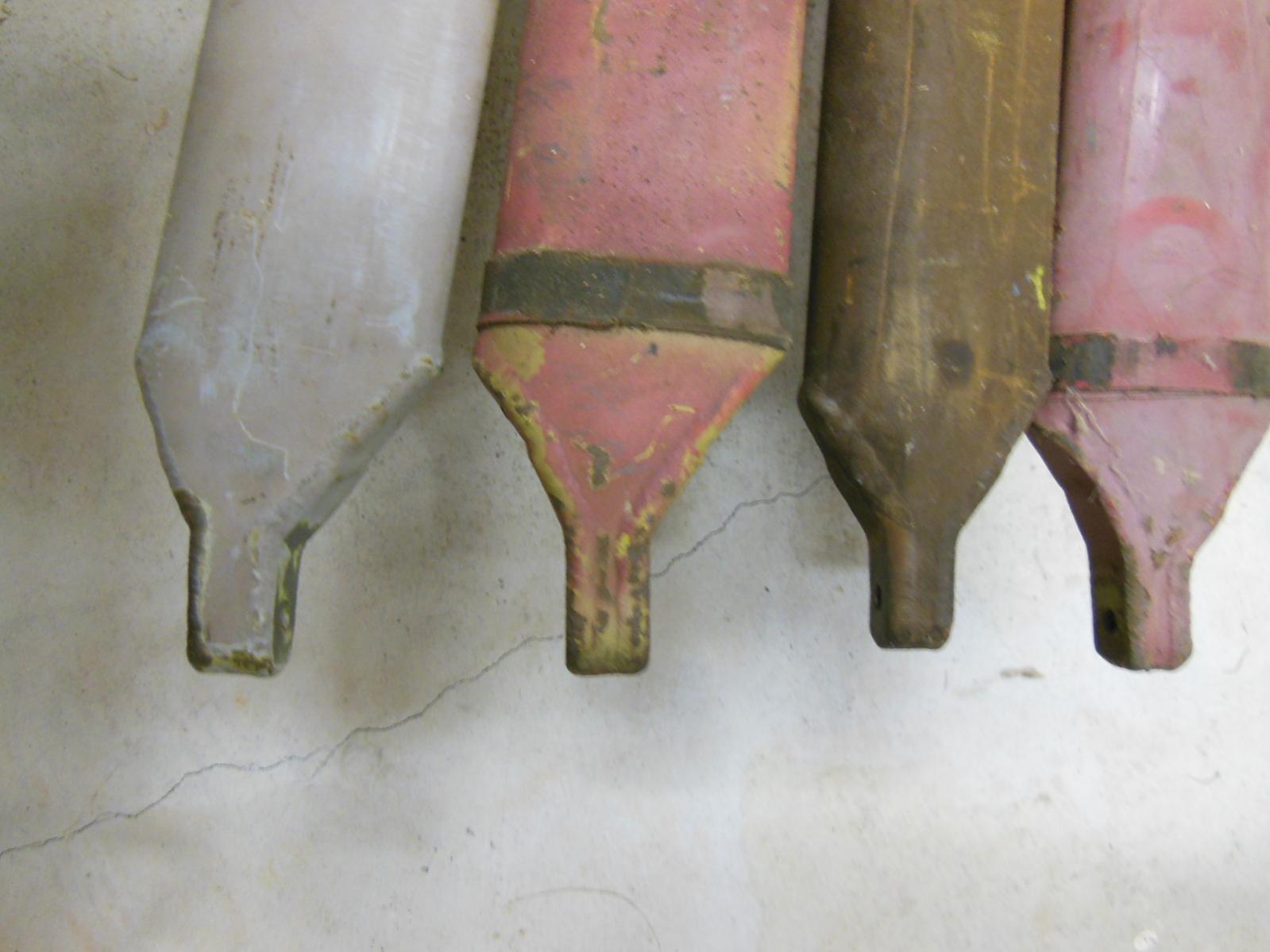

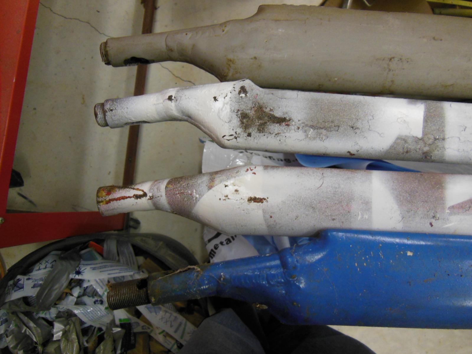

                            I took out 4 rear struts from my pile and photographed them side by side and then the pre wars on top of the post wars. They all look the same to me. The pre wars are real skinny tubing.
                            I also took out some front struts and photo graphed them side by side. You can see the 6 degree angle difference on some of them. The brown one and the blue ones are the ones with a shallow angle.
                            I noticed this; the ones with the big angle feel like the strut material is buckled up on the aft side of the end fitting. This suggests to me that it is possible that the angle difference is due to damage that bent the tip fitting. BTW- the struts that I photographed do show signs of damaged but I has not analyzed it.

                              So why is there a 6* differences between the struts? How much did the fuselages change or was it a change in the strut attach fittings in the wings? The only differences I have found was the angle of incidence on the wing attach fittings. Tim
