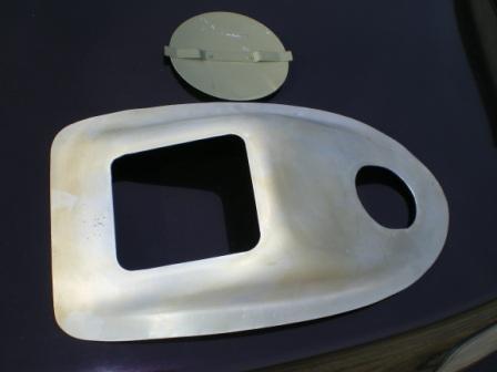

              I have an aluminum one that I bought new from the factory when they were open in Texas for a short time.
              See the picture below. Is this what you are looking for?
              I've been holding onto it thinking that mine was in rough shape and would need to be replaced one day.
              But I just went through my lower engine cowl and fixed a bunch of problems but decided not to replace this part.
              Send me a PM if you want the new part (shown below).
              FWIW, I also have a '46 BC-12D. But I have not verified that this part fits correctly. It looks like it should.

                Whoever gets it should make a splash mold so we can make more. Probably easiest to lay some plastic wrap over a box with wet plaster and press the fairing into it. From the plaster you can make a series of Bondo bucks that will be good for several aluminum ones each (you can make as many Bondo bucks as needed from the plaster since you don't tap the aluminum on the plaster one, just don't forget to put some plastic in so you don't "glue" the Bondo to the plaster....don't ask).
                It is a nice simple shape that would be great for learning metal bumping.
                You can also make a FG one in the female mold
