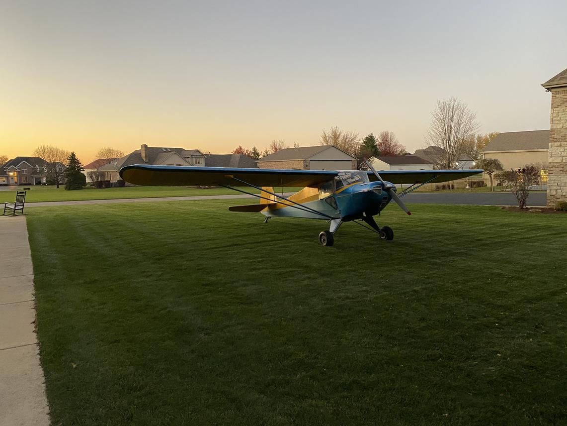

          ModelTop.jpg​
            When I restored my BL I stripped off paint and was able to get to the bottom factory layer. It was a metallic blue, and it did have a very fine metal flake. Maybe just some aluminum past added IDK. The closest current day color to match it was Randolph Newport Blue. I sent a upper gear fairing with the layers of paint removed down to the factory layer to Stits to have an exact match blended. I had it mixed in Aerothane and flattened to look like dope. My wings were silver being that it was a trainer, and built as inexpensive as possible.

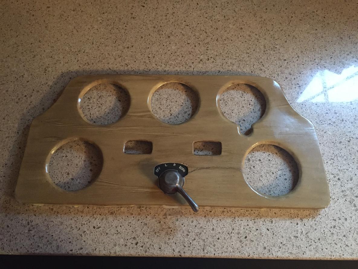

                E0AE733D-D70E-452A-B0C3-D3B4E33CC2BA.jpeg Not best photo

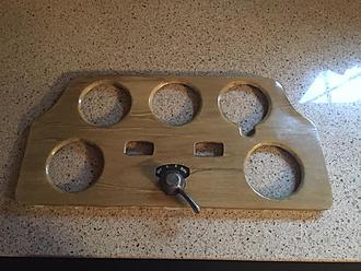

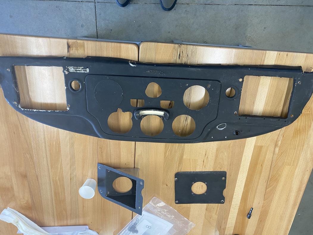

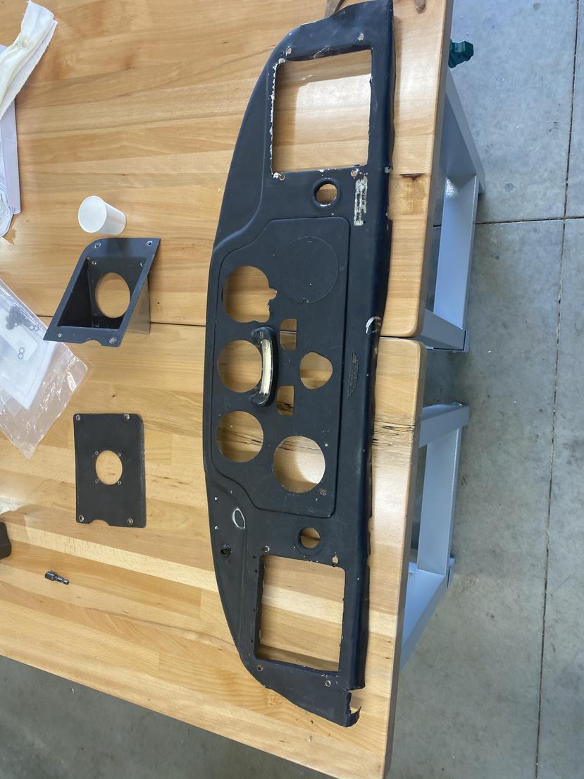

                i have collected the trim, yikes, compass, new struts, cowl trim is correct. Have a rough panel. Need to find instruments, wheel pants and mag switch and whatever else it’s missing.
                  Paul, I have info on the panel I made. Can you post photos of what you have now?
                    i will be home Wednesday. I wi get some better pictures.
                    it is pretty butchered up
                    thanks

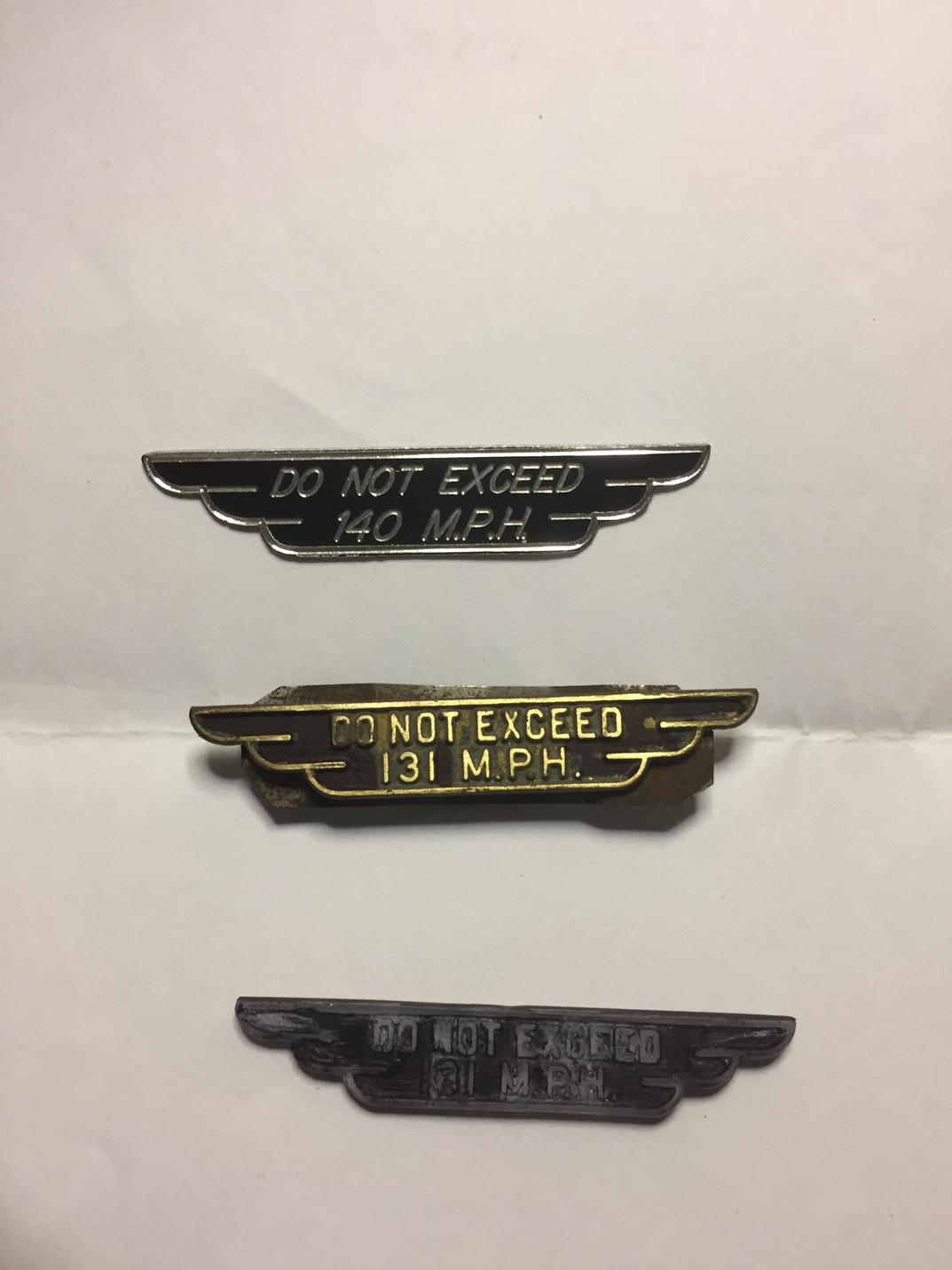

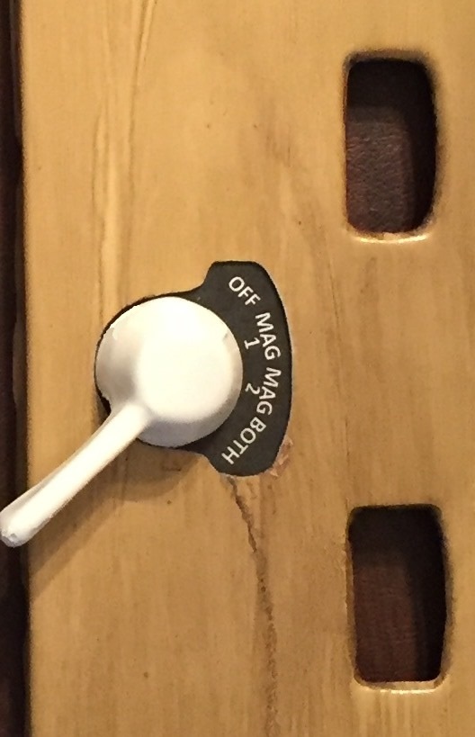

                      Really it is NOT that bad! The panel itself is VERY repairable and with a bit of work the insert could be brought back too. Also you have a very hard to get VNE cast placard like I have been trying to replicate (getting close, but need to do some jewelers loop work yet Top is a stamped one, middle is an original and bottom is my replica.). The placard is cast metal with a black background and gold or brass raised markings. It is pretty easy to screw up because the detail is NOT that deep. The inclinometer on your panel is NOT original and I can't imagine it being very easy to use. You are going to get good at flush patching. ;-) My A-7 mag switch for the 45 is coming along nicely and is working smoothly. Next one will be for the 41 to fit in the panel insert opening. I really like not having to use the original A-7 since I have seen several fail. Putting a key in the lever and mounting a Grimes switch behind the panel makes it non-original, but more reliable and you can pull the key out and at least slow down anyone trying to start the engine. It is almost impossible to tell it is a replica. I can send you tracings of how the insert panel hole shapes are supposed to be from an original insert tracing.

                        I do have the cast 131mph plaque
                        I will post a picture
                        thanks.
                        paul
                          They really do look a lot nicer than the later ones and I have been told they made them with 140 MPH for a while before switching to the stamped ones. ANY one have a cast one with 140 MPH?

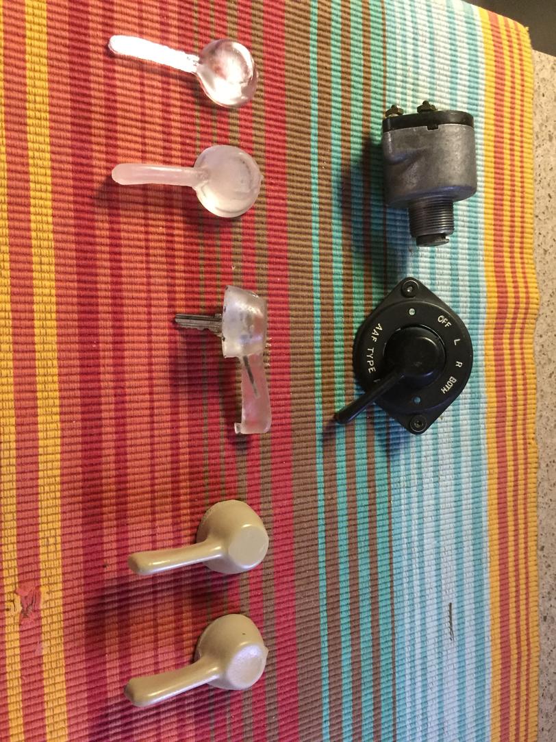

                          I should let all know that I finally broke one of the cast levers for the mag switch. I must have put 10 years of abuse in it before it broke (which was because i dropped it on a stone floor by the way). I back drilled it and put a steel wire from the center through the lever and glued it back together. Let the torture test continue!! I think I have a way to drill the hole from the key slot out but am playing with casting the wire in too. If you look closely you can see the wire in the photo. Also have 11 small knobs made and am finding ways to make the shank straight. The master is straight but they seem to take a curve in the mold. Still work, but don't quite look right when you hold them. Once under the panel you can't see it, just bugs me.
