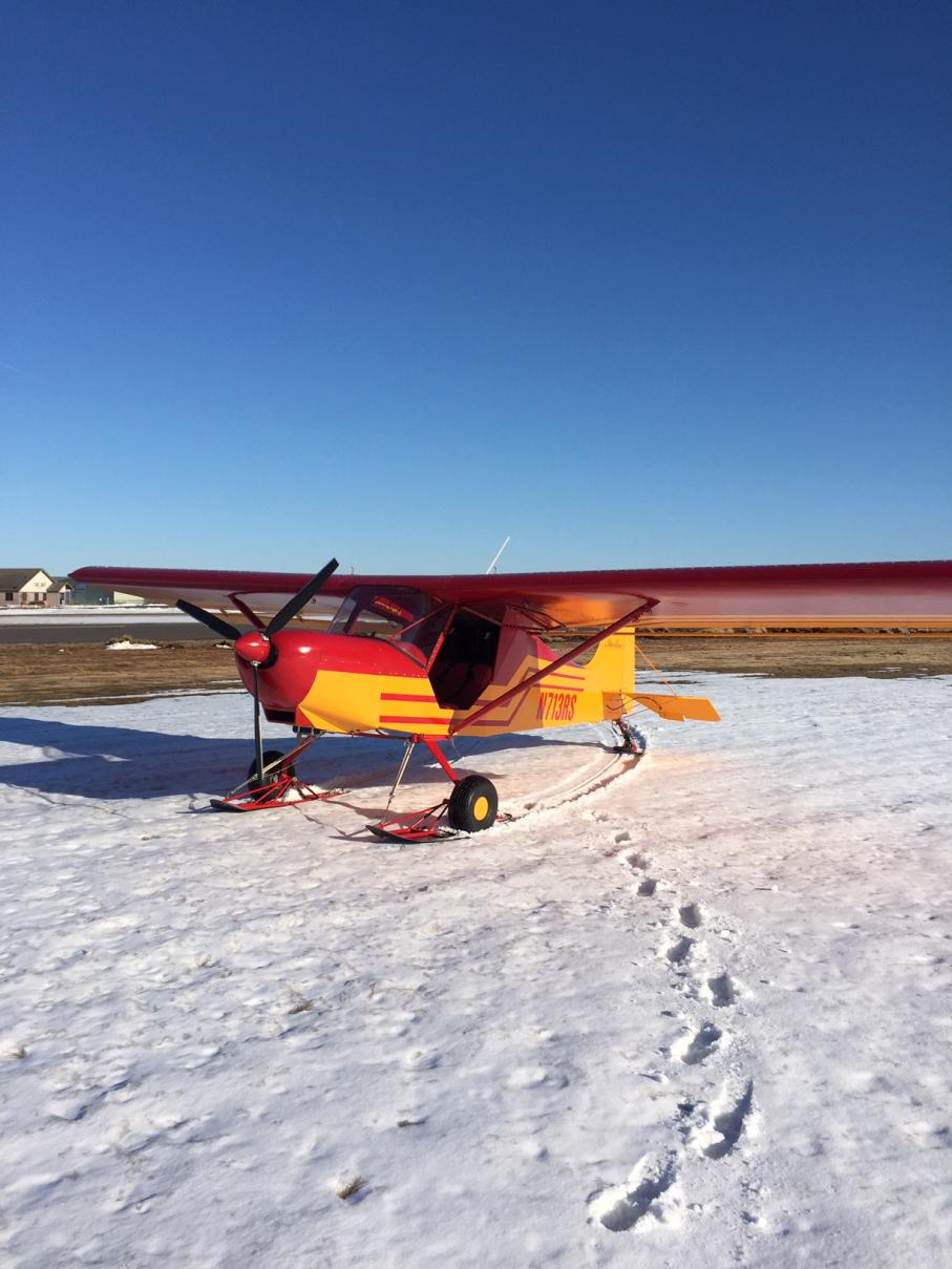

      Good luck on your choice I think a Tcraft would run fine on a 912ULS an Click image for larger version
ID:	196770 d allow you to streamline the cowl to even reduce the frontal area.
      By the way I know of builders that have had aircraft in the experimental exhibition category and fly them everywhere by stating in the annual paperwork they are attending every flyin around the country!
