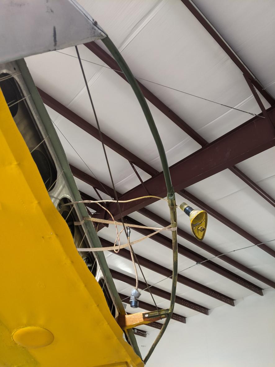

        Any thoughts on how to straighten it? I'm concerned about straightening it when it's installed due to the forces involved. On the other hand, doing it whilst installed would be convenient for minimizing extra fabric work and also acting as a "jig" whilst it's straightened. Without starting the process, I don't have a sense of how strong that 4130 tube is.

            Glenn, try a C clamp and some iron or better yet, wood blocks that are profiled to the radius. It shouldn't take that much. If it doesn't want to go, a little heat wont be a bad thing. It's far from a structural piece, but be VERY careful, as dope is quite flammable!

              Straightening went well today: Click image for larger version

                Please tell me you didn't drop the glass light dome!
                  No Hank. It's in one piece in a very safe place.

                    That part of the wing should be easily deformed by design to save the rest of the assembly. Why transfer loads to other structures in event of a minor bump or bend? Ground loops were a common event before steerable partially locking tailwheels.
                      Thanks Gary. It's a good design. Just strong enough, but not too strong.
