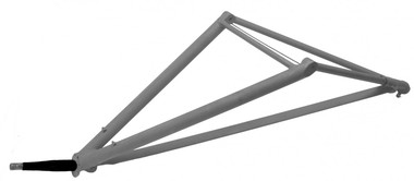

            Please respond if you know of any method successful to eliminate toe-in of a BC12D mains, freshly covered and scary to fly.
            • #21
              take the main tires off,
              put the aircraft on jack stands, placed at the inboard side of the axle
              anchor the tail down good
              take a 1-1/4" schedule 40 pipe 5' long and slide it over the axle, up to the jack stand
              reef on it hard enough to bend the gear to where you want to go.
              have 2 or 3 friends hold the airplane from falling off the jackstands.
              Use 2 pieces of 1" square tubing with a .750" hole precision drilled into it that square and the metal tube is 3 feet long and slide over the axles and measure your toe
              when you get it bent to 1/16" toe in, you are done
              reassemble the wheels onto the mains
              • #22
                Over the years I have straightened several gears like was described above with good results. If you encounter some ripples in the fabric use a heat gun to shrink the wrinkles out gently. All mine were Ceconite fabric covered, or Polyfiber.
                • #23
                  I did the same some years (decades) ago...I was in the position of the gear being uncovered, so I used a smidgen of heat at the lower cluster. But still used a bloody long bar!
                  Great minds think alike!
                  As an aside, a very experienced aircraft engineer* once told me that 4130N is better formed cold....it has more tolerance in cold bending than many other steels, including 1025 (which is essentially mild steel). He demonstrated this by cold-bending a 4130N tube of 7/8 inch diameter and (I think 0.038 thickness or thereabouts) around a formed mandrel of about 8 inch radius, and a 90 degree bend. There was some minor deformation, but he taught me about dye-pen and magnaflux NDT at the same time. There were no cracks.
