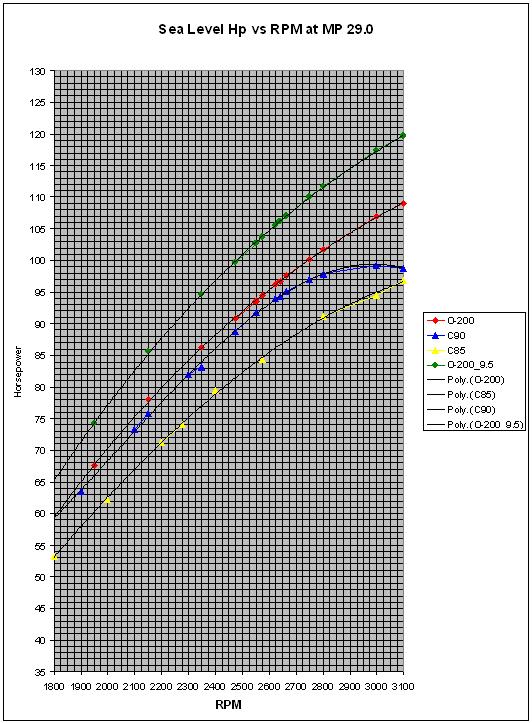

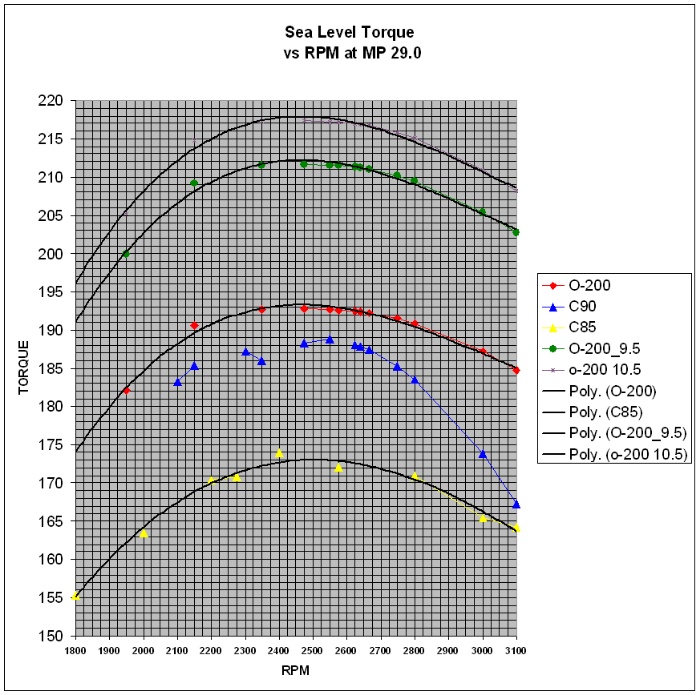

                  Here is a graph robbed from another site with information about compression ratio vs hp.

                    Tim might as well add this to the theft bag (from JimC). It's interesting to note that the C-90 and O-200 share a common compression ratio, engine displacement, and valve lift, but different camshaft and ignition timing.
                      Actually the cams are now the same per the new parts manual, so its really only timing and RPM.
                        I'm not seeing that same cam deal...can you provide a link to the current info? My 2011 Parts Manual shows C-90 531076 and O-200 628421 but that my be superseded. I do know when I sourced my C-90 cam for the stroker we had a hard time to finding one...Lycon had one tagged.

                          I know I read it somewhere because I used it as data for and STC application that I was working on...It may have been a service bulletin, but the late model c90-16 and O-200a&B used the same cam. Tim

                            No disagreement here Tim. But I'd like to see the latest parts info from Continental or China...whoever they is. Probably no more support for the C's earlier than the O-200 anyway.
                            Here's AES' take on the C-90 cam P/N 530176 being superseded by 643183: http://www.aircraft-specialties.com/...t-assy-643183/
                            I'd like to know the valve lift and I/E timing to compare with previous cams.
                            I'd stick with 8.5:1 pistons given our fuel.
