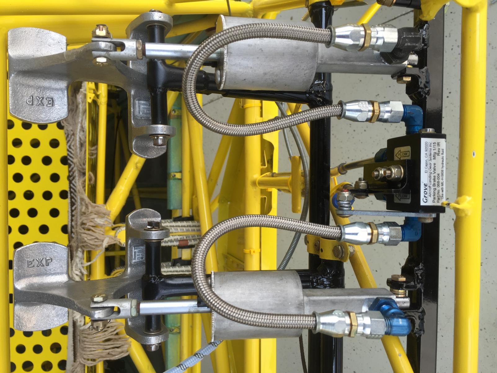

          I'm using Atlee Dodge wheel adapters and 6.00x6 Clevlands from a salvage Cesnna 177 with Grove park brake valve, the toe brakes are Spruce home builders kit.
          Dustin Blevens
          Paragould,Arkansas

            Hey that fuel valve looks good!
