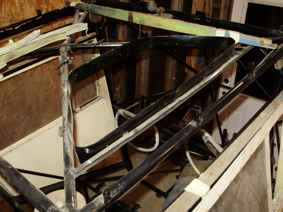

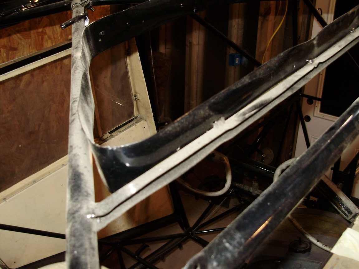

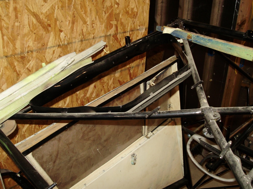

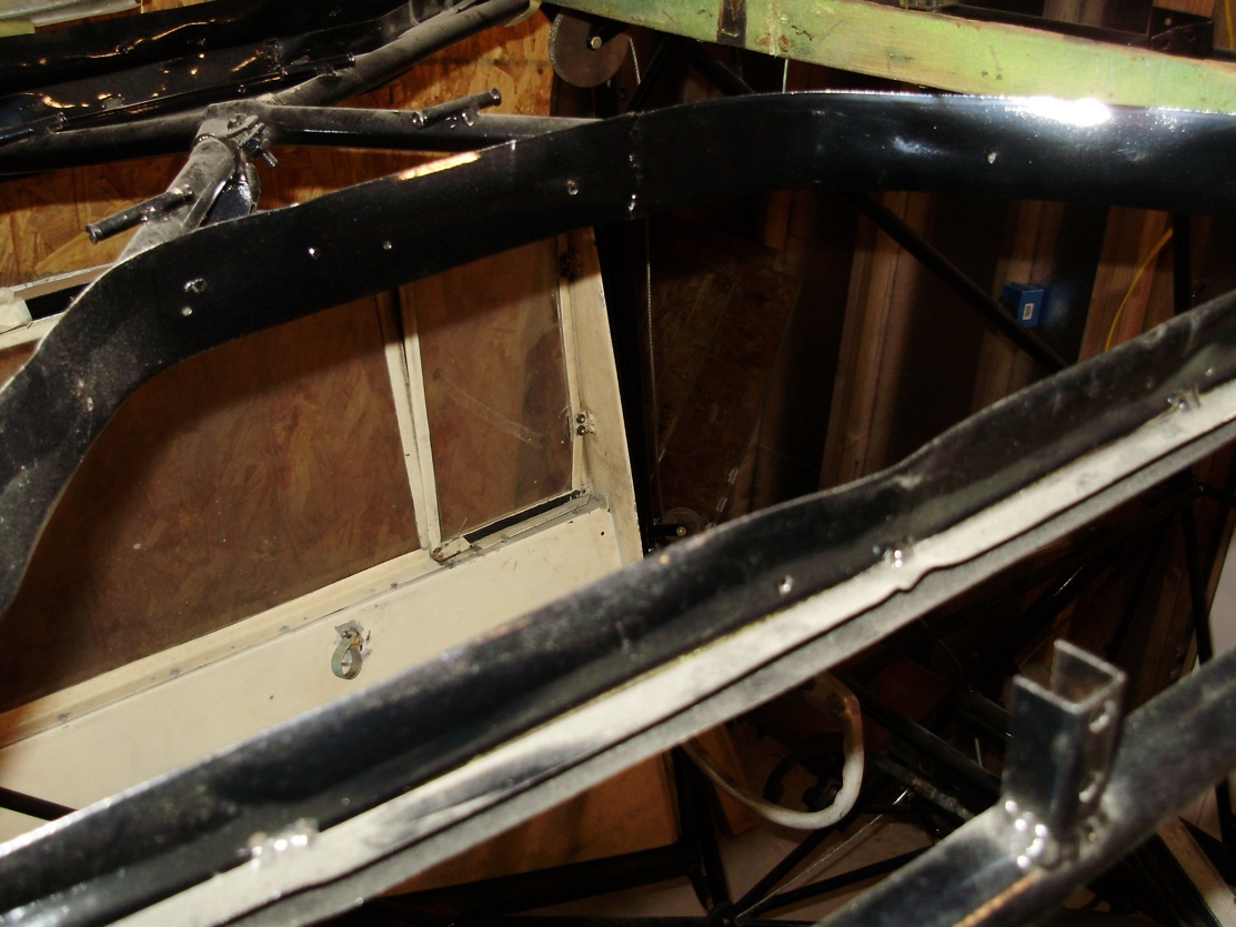

I just took on an F-19 project and discovered that this airframe has what appears to be a factory installed skylight. Can anyone confirm this is OEM? If so, how exactly is the plexiglass and the fabric fitted into these frames? I think I can kludge something together, but it would be good to know how it was originally done.

That looks similar to the factory ones from my 45. I was told that mine were an experiment they tried on the first two Deluxe models after the war in 1945 but the wood work was too much labor.
Yours has metal frame where mine was wood and my "glass" went all the way to the center with the trim cables running under the glass. Looks like to me you would still need wood around those frames to support the fabric.
I found the triangle skylights with the long side against the root rib and the apex of each at the center gave just as good visibility as the big square ones but gained MUCH less heat in the summer sun! Your head is so close to the glass when you tun your head your eyes are right next to the glass with great visibility. You also can just glance up in a turn and see through the "T top blind spot".
Best of all, the two triangle skylights really LOOK much better to me. I just wish I had them in the 41.

Yes, it looks like I need to do some wood work to fair in the fabric and retain the glass. I just don't know what that looks like ... yet. None-the-less, it is a very interesting feature and possibly a rare find. The plane belongs to folks from Corsicana, TX.
The F-19 type certificate calls out a skylight, so this may be one of only a few built this way. If I can figure it out, I'm going to do this to my own F-19.Best Regards,
Mark Julicher
