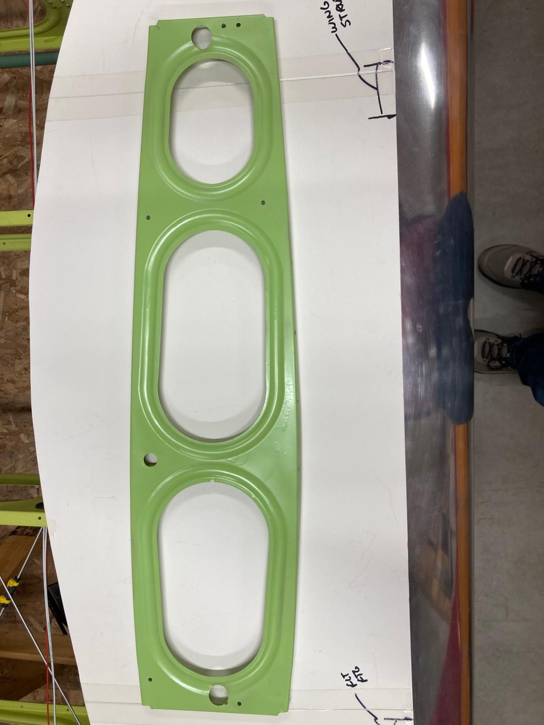

    Although the F21A has two 20 gallon wing tanks and no nose tank, the F21A and the post war Tcrafts wings have some parts in common and others modified. Here are a few that might be interesting. When rebuilding my 21A wings I used 1946 stamped ribs along with repairing some of the 21A ribs. The repair parts were also earlier Tcraft rib parts. The F21A main spar is 6in x 3/4in thick and the rear spar is 4 3/8in x 5/8in thick. The ribs assembled nicely when centered and the compression struts were easily shimmed to fit. From what I noticed all spar hole locations were the same between the models. Click image for larger version

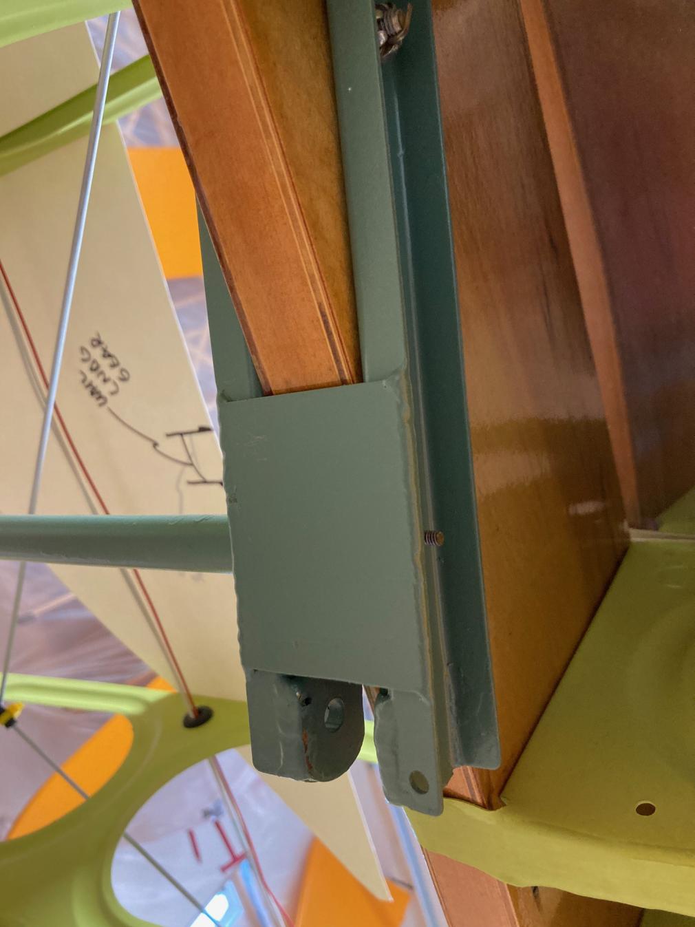

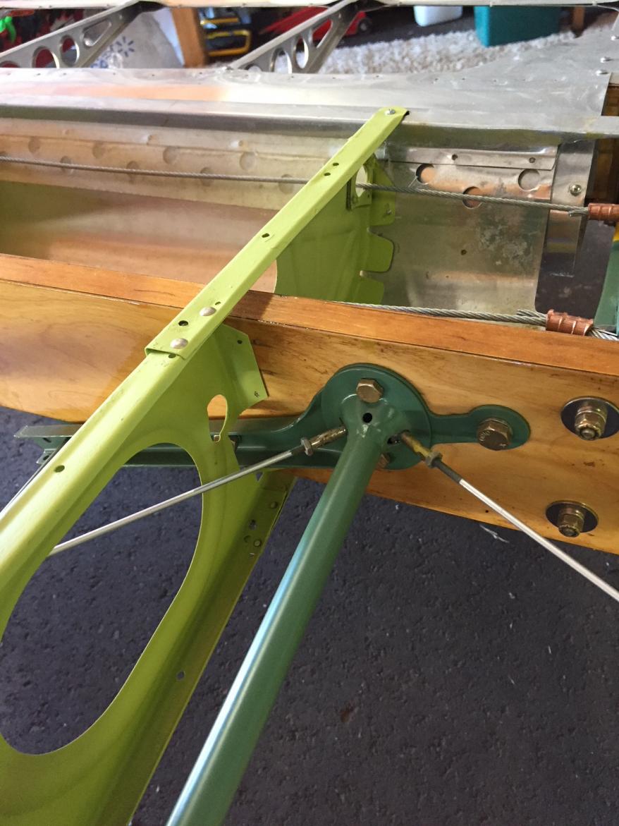

    The F21A wing strut attachment fittings have a .080 4130 plate welded between the two-attachment fittings bolted to the spar Click image for larger version
Name:	wing strut attach ftg.jpg
ID:	196968 as indicated in the picture. This is done for both front and rear spar attachment fittings.

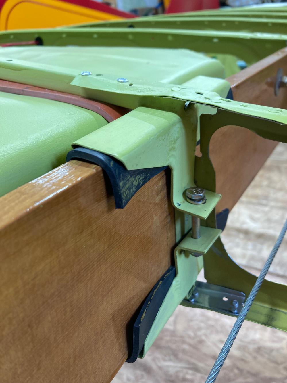

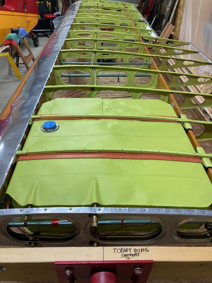

    The wing tanks are held in position similar to the Piper design except the 21A attachment square tubing top and bottom also acts as the wing rib airfoil. The factory design riveted the tank angles to the tubes which caused cracking of the tanks due to fatiguing the tank angles. A simple correction of sandwiching the tanks between silicone using the original tank tubing within the tank angles holds the tank firmly
    when the tubes are clamped together over the spars. All of the original square tubing and spar clamps are used and are not modified. Click image for larger version
