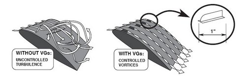

    3) Does anyone run Vortex Generators on their airplane? I'm curious what you think of them. They work well on a Chief we have and I was seeking some feedback on the TC as well.

    VG's, do it. They are a great add-on. The cowl bumps, if you have a decent one, just get some fiberglass and make some using the original one as a mold.

      I'd not fly the Taylorcraft's NACA 23012 airfoil without VG's if slow flight and steep turns were normal ops, especially when heavy. Load the wing and the stall gets more abrupt. The VG's smooth the pressure peak near the leading edge at high angle of attack and ultimately the stall behavior.
      Helio Courier figured it out and added leading edge slats to that wing.
        There is definitely more abrupt stall when heavily loaded. Can be useful for short landing, but can also be dangerous.
              The NACA 23012 airfoil as fitted to our beloved Taylorcraft is also the same airfoil section fitted to (for example) the outboard sections of the DC3, and the whole section of various Beech designs including the so-called "Doctor-killer" Bonanza. It's a very efficient aerofoil, in terms of lift over drag. It's one of the reasons a Cub will be slower than a Taylorcraft on the same horsepower.
              The 23012 airfoil has a wicked sudden stall characteristic, particularly at high wing loadings; fortunately for us, CG Taylor knew his stuff and used this section because of its efficiency. Also, because of our low wing loading (weight) and long span, the stall is very benign, with the appropriate use of rudder.
                I believe the VG's reduce that leading edge discontinuity Robert. This link at page 272 plus or minus describes the NACA 23012 airfoil and its behavior. Scroll down for a free look.
                  Indeed you are right Gary! But Vgs get in the way of washing chores, and I don't fly into such short strips in the UK where Vgs become important! If the wind is over 15kts, I just land into wind!
                  Take care; fly safe!
                    I owned an F-19 & an F-21B years ago -- recently bought another F-19 with VGs --- not quite sure if I like them because the slower stall speed seems to make landings a bit more challenging than I remember with my non-VG TCrafts. 1) your nose/AOA needs to be higher during 3 point landings = more difficult to see over the nose. 2) you need to wait longer to let the tail down during a wheel landing so your directional control is limited to rudder and drum brakes. - David
                      ^^^^David, yes the VG's allow a % slower stall without a sharp break. Doing a falling leaf maneuver after stall becomes easier with the rudder. Having VG's under the horizontal stabilizer adds some elevator and trim tab authority. I added rubber elevator seals for a Pitts from Aircraft Spruce to add even more control at low airspeed and forward CG. But it took my effort to slow the plane more on landing to cope with the lower stall speed in ground effect.
                      One thing to consider is to remove a few of the VG's in front of the fuel tanks and maybe a bit more outboard. Micro left them off in that area in their original designs, mainly for Cubs and Champs with larger wing fuel tanks. Then they extended them to the wing root area and under the tail. Without VG's inboard that portion will stall earlier than the outboard wing. That may offset some of the floating effect.
                      Also confirm your wing washout is correct. Some have flatter wings that can change their slow speed behavior. I like 1.5 or more degrees of washout measured with a digital level wing root to last full outboard rib.

                              In theory the VG's will allow the leading edge to fly at higher AOA, which moves the practical Cl/CP further forward.
                              David notes: "1) your nose/AOA needs to be higher during 3 point landings = more difficult to see over the nose. 2) you need to wait longer to let the tail down during a wheel landing so your directional control is limited to rudder and drum brakes​. The plane needs to be slowed more with VG's to counteract the tendency to float on landing."
