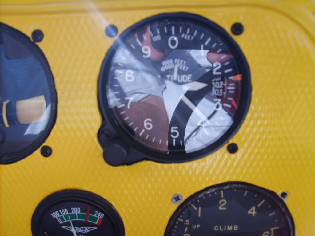

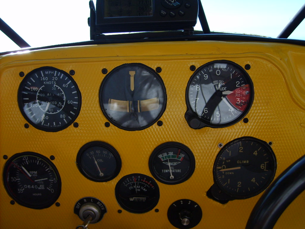

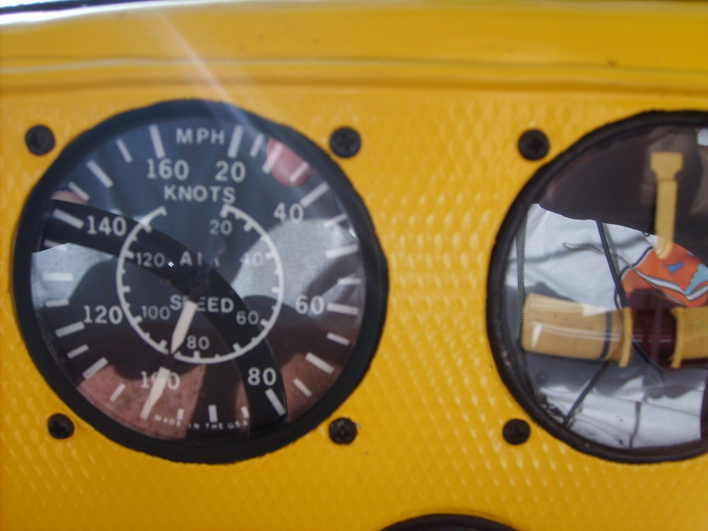

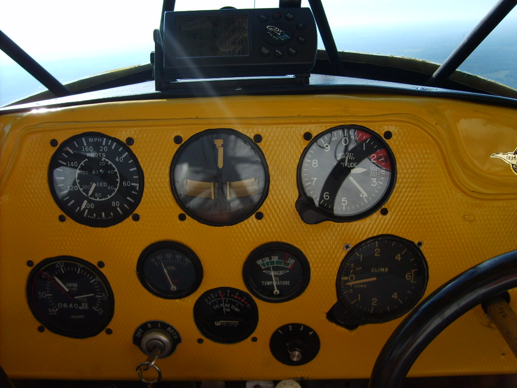

            josh here are some photos i took this morning on the way to Winchester Tn eaa pancake breakfast of my panel
            1940 BLT/BC65 N26658 SER#2000

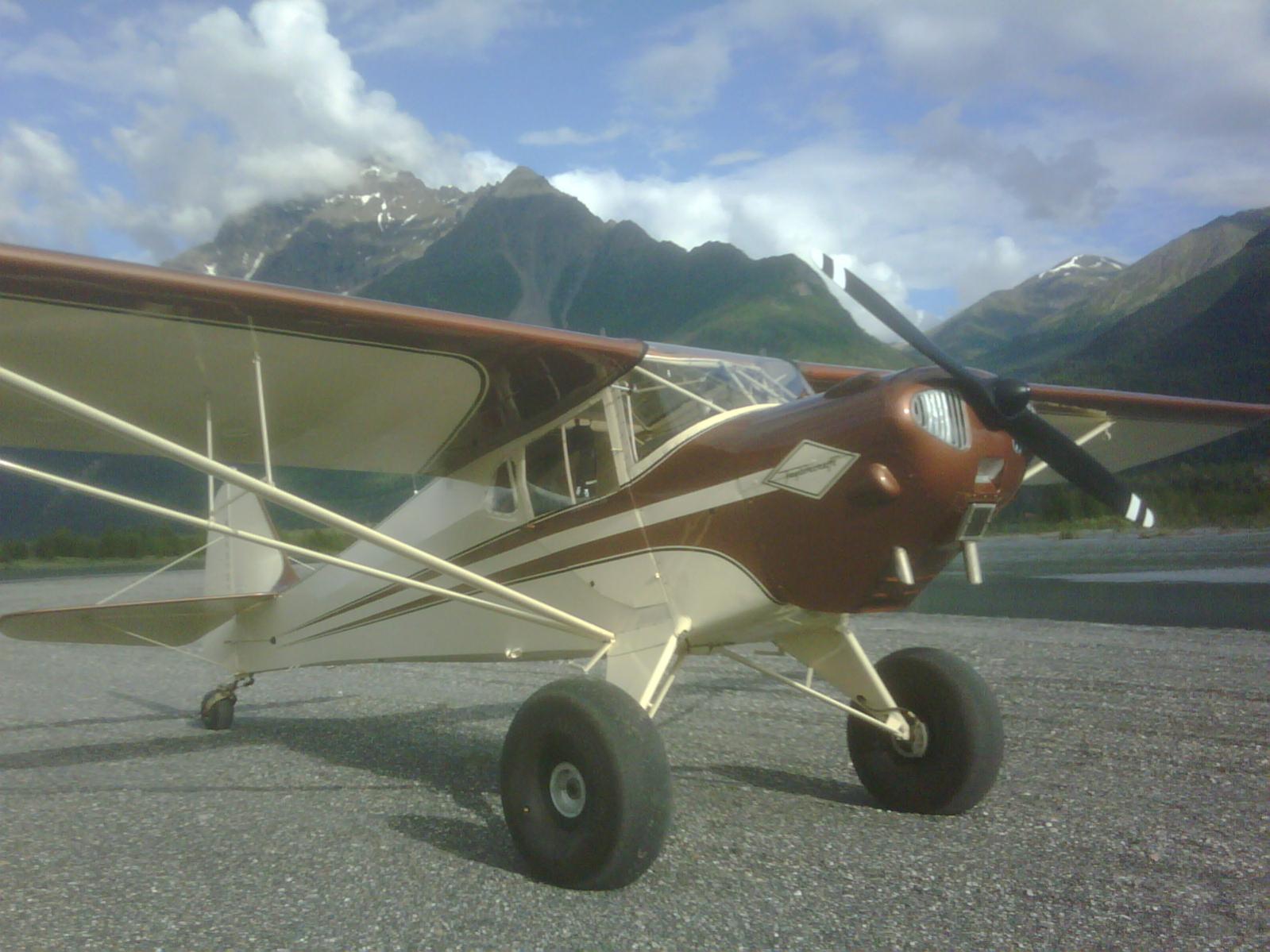

              Many of us have the opposite problem here in Alaska. I have been told that oil temps should be consistently in the 190 to 200 degree range to make sure that any water (via condensation, etc) is burned off in the oil. I have trouble getting temps up to that range in both the Cessna 185 and in my Taylorcraft.
              Having just completed a rebuild on the Tcraft (which includes a zero-time C85 engine and a new cowling with a significant gap and louvers) I found it was running very cool ... like down around 140 degrees on a 60 degree day. I had to install a cover in the front air scoop and put duct tape on the cowling grill to get my temps up. I am now running consistently at 200 degrees and it's been in the mid 60's to low 70's here the last week or so. Here is a pic taken a couple days ago on one of the Knik River sandbars, just below Pioneer Peak. The pic shows the cowling and the things I've had to take to get the temps up.
              I guess I would rather have to take these measures here in Alaska than struggle to keep the engine oil cool enough down in the "lower 48".
              Blue Skies,
              Rod
