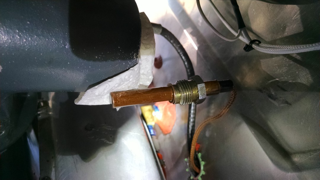

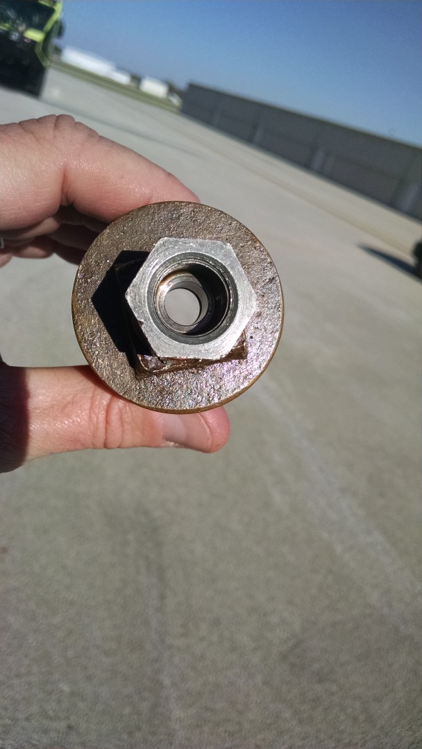

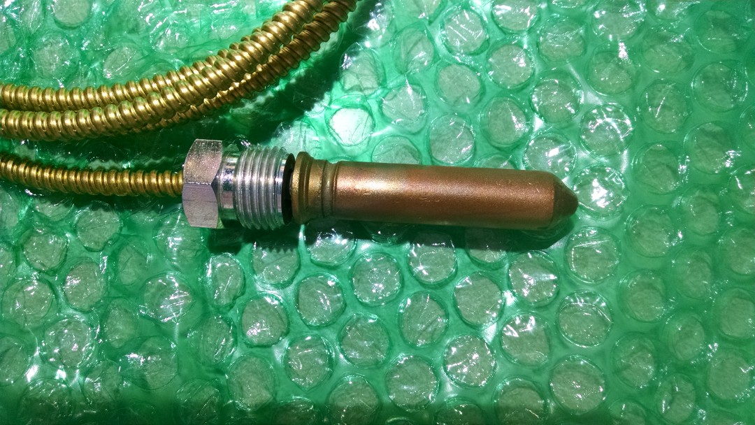

    Pictures of the new, old and adapter.
      Re: Oil temperature bulb adapter
      My first thought are that your old bulb (with the square end) is incorrect, and that the rounded-end bulb is the correct one.
      I've had these Bourdon gauges re-made by vintage automotive folks with no problem.
        The old, small square bulb is the only one I have ever seen. The newly rebuilt one is the larger rounded-end bulb. The oil temperature gauge adapter, which is the same on the last four A-65's I have had as well as the three at the A&P school here in town are all for the small temperature bulb.
        The gauge restorer, John Wolfe & Co., put on the larger bulb when they restored the gauge. Scott/AVOX started putting on the larger bulbs, see here and choose the pdf at the bottom: http://www.cessna120-140.org/forum/viewtopic.php?t=1988

                        The new bulb is about 7/16", not the smaller 3/8". The new bulb has a tapered end that must fit into the tapered female part of the adapter to create a seal. If you have a few minutes, click on the link I posted in post #4 above. Down at the bottom of that webpage you will see a pdf. I had no clue about this issue until I ran into this. I know these adapters are out there but some folks probably don't want to let loose in case they may need them at a later date. Thanks Dave.

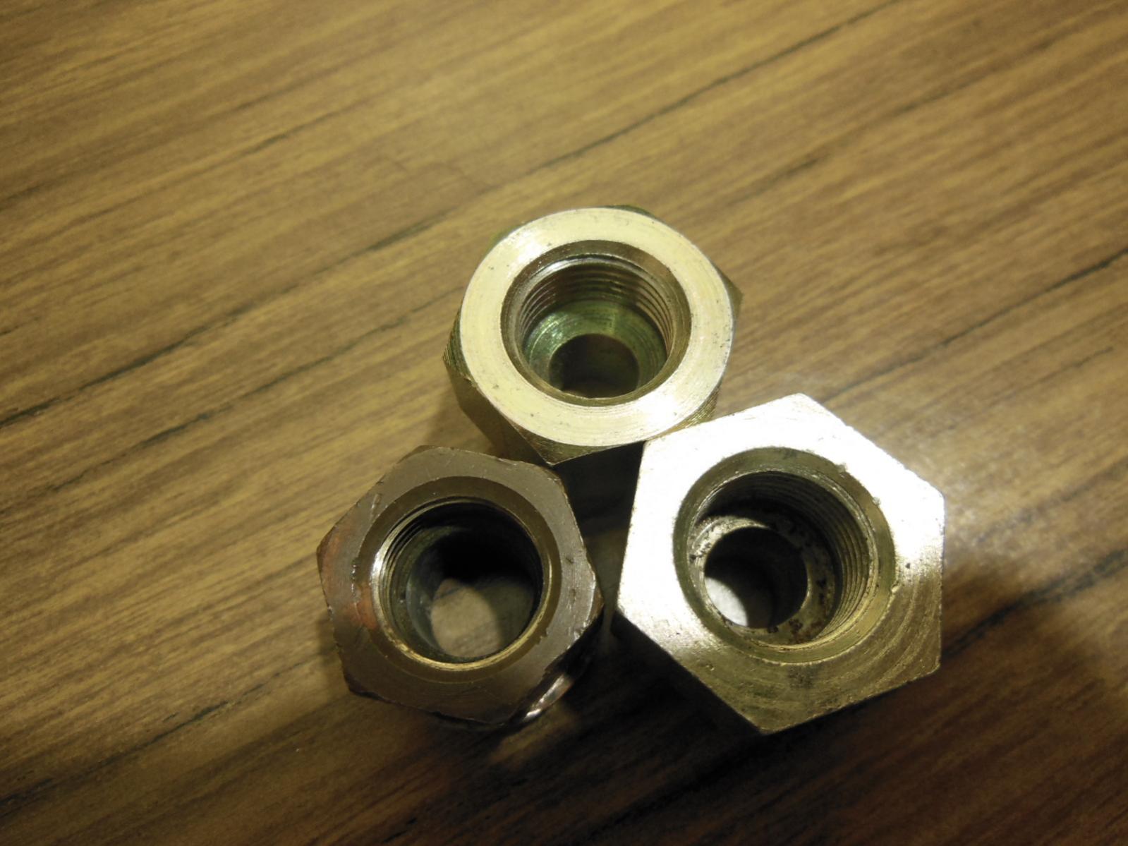

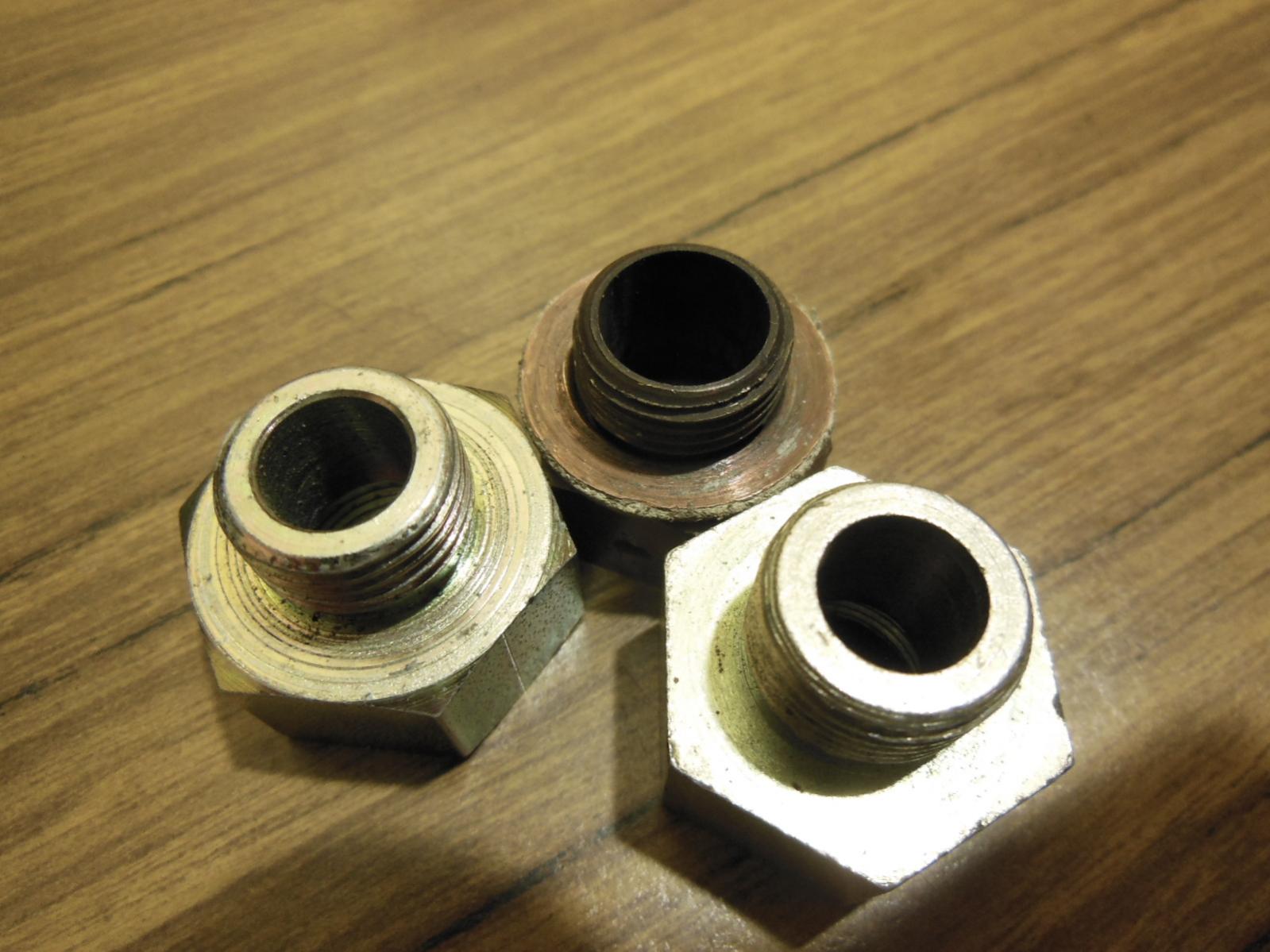

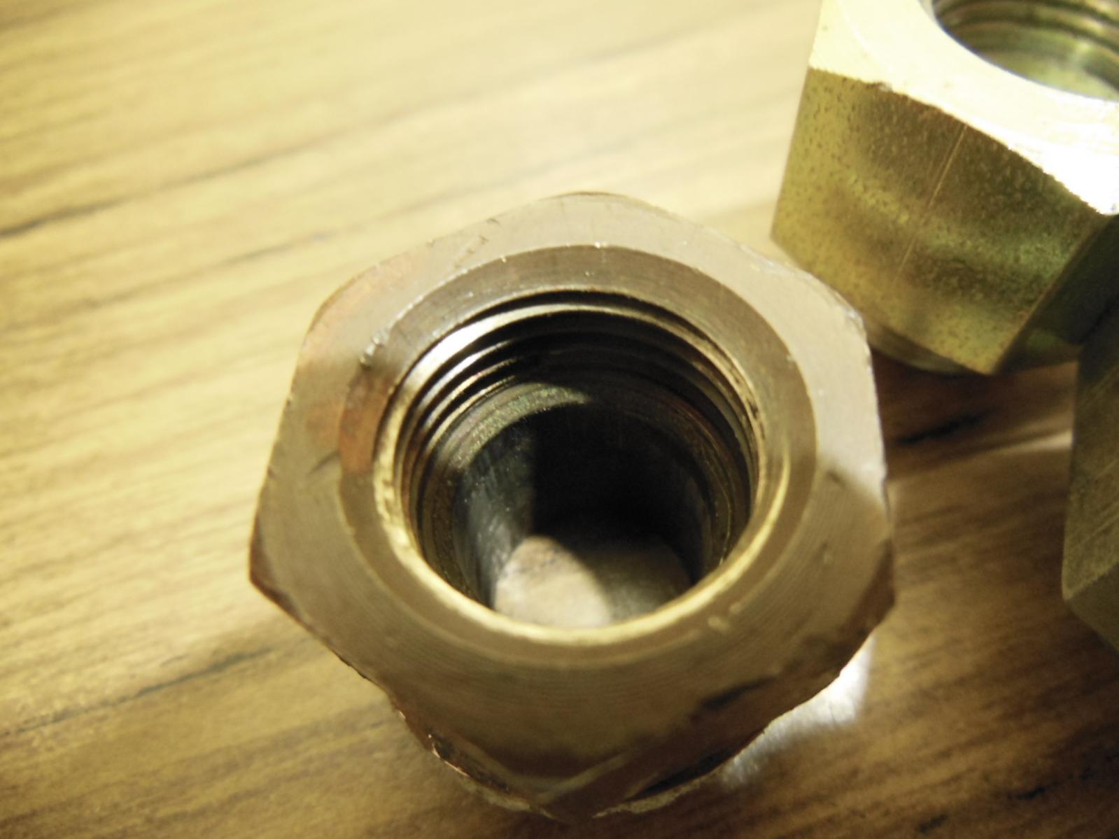

                              Marty,
                              I found three.
                              Two are 3/8" i.d. with flat or tapered edge, one is 7/16" i.d. with tapered edge.
                              After looking at them (pictures attached) I think you could just have the 3/8" tapered bored or drilled out to 7/16".
                              Interestingly about 25 years ago I changed my oil temp and the new bulb was 3/8" but the old one was 7/16" so I very cleverly soldered a copper sleeve into the adapter. I guess if I had been paying better attention I would have used one of these adapters as I think I had them then!
                              Let me know if you want one of these, if so email me your address. I have it somewhere but it is from at least 10 years ago I bet.
