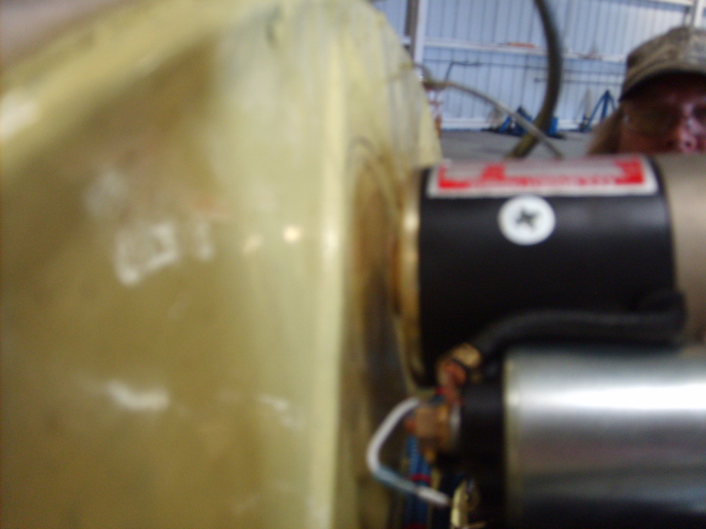

I'm wanting to put a C85-12 with skytec starter on the short mount. The starter hits the firewall. My AI wants a legal way to modify firewall for clearance. Do I need a DER drawing and paperwork to go with Terry Bowdens STC? Any one else done this?

As a IA my initial thoughts are that it would be a minor alteration depending on how you make the clearance, an I would just do it. If your IA thinks he needs some kind of approval I would start by asking Terry.
Re: Engine upgrade to C85 w/starter
Hi,Originally posted by benjay View PostI'm wanting to put a C85-12 with skytec starter on the short mount. The starter hits the firewall. My AI wants a legal way to modify firewall for clearance. Do I need a DER drawing and paperwork to go with Terry Bowdens STC? Any one else done this?
A couple of thoughts, I saw a Cub yesterday with a B & C starter that had about an inch clearance to the firewall that could be removed with a little clever wiggling. That makes me wonder if a B & C is easier to get in and out and also a better fit?
Also I wonder that if a t-craft had a "hole" in the firewall does the main tank become the next obstruction?
Thanks for your thoughts. The cutout would look the best and hav aprox. one inch clearance firewall to tank and need about 1/2 inch clearance for starter. The B&C and SkyTec seem to have the same length. I have heard of Tcraft with the starter mod but haven't been able to find out exactly how they made it. I have emailed Terry Bowden but haven't heard back yet. He is planing putting a 90 hp in his Tcraft when I talked to him last but hasn't started it yet.

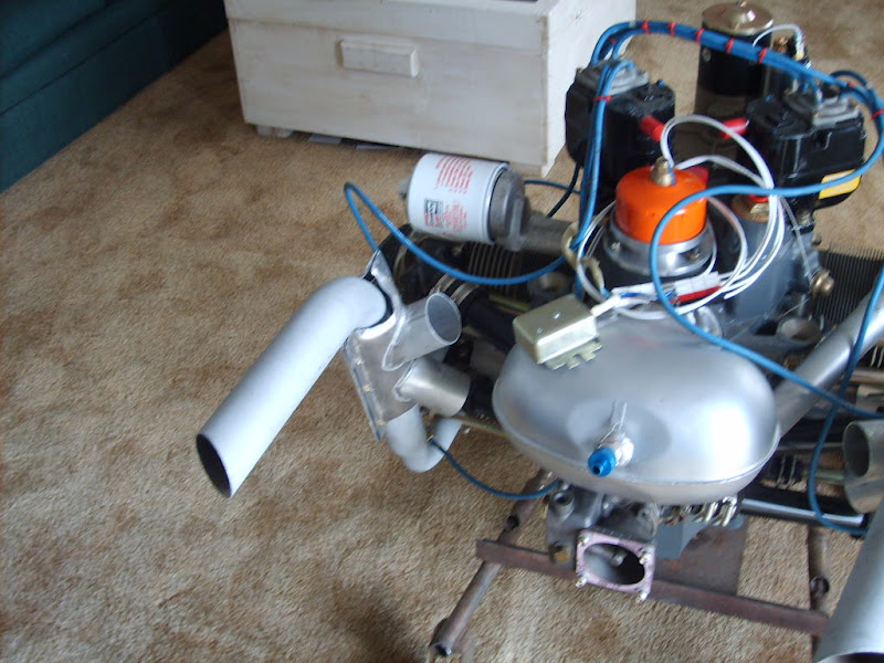

John the starter is 10.3 lbs and the alternator is 3.4 lbs for a total of 13.7 lbs the hole package was only about 11 lbs more then the A65 that is to include C85-12 starter alternator airforms baffles oil filter and adapter luscombe exhaust quick drain on oil tank then add the oddyssy battery at 14 lbs for a total gain of 25 lbs my ship ended up 776 lbs total.1940 BLT/BC65 N26658 SER#2000
