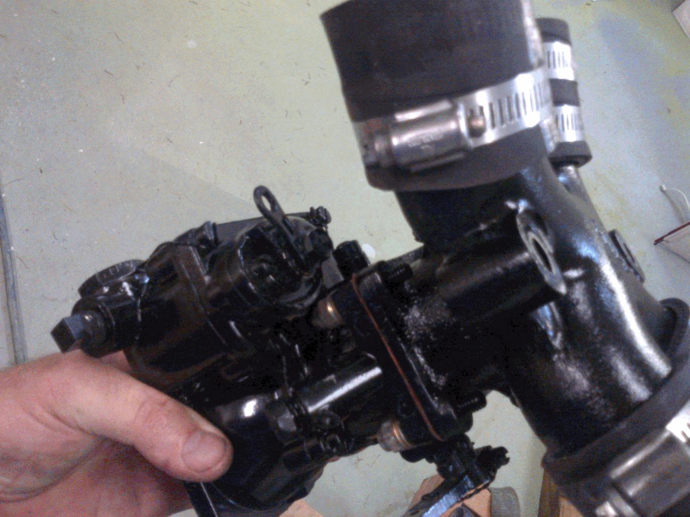

              I have heard that Marvel made a carb that was sized for the A-65, and it has a working mixture system that would also idle cut-off, is this true? As tough as it is getting to find certain parts for the NAS-3's, (Says my A&P), if it could be done without giving the FAA a stroke, I wouldn't mind starting to see if I can scare one of these up.
                Re: Mixture
                Brie, really what parts do you need for your Stromberg? Gaskets and needles and seats are readily available for overhaul and other parts are available as well. I have never needed a working mixture as I do not fly over 5000 feet on average, where the Stromberg mixture usually starts working. I shut down with the mag switch so I really don't need an idle cut-off. For me it is 'don't fix something that isn't broken'. Marvel had a carb for the A-65, there is one on our local community college's A-65 they have for instruction. Other than that one, I have never seen an A-65 with a Marvel, (that is just purely my personal observation). I think you may have a more difficult time finding parts for the Marvel, but I am sure someone will comment on that. I have found some A&P's just don't want to work on the Stromberg because it takes more time to set the float level than they are willing to invest. Just my humble opinion. Good luck!!!
                  Re: Mixture
                  That's the problem, Marty, my A&P let it be known to me, that he DOESN'T want to do this again. He knows the modern carbs, NOT the old stuff. He had to pick the brain of an eighty something year old guy in El Paso to get an idea how to do this. What this is going to cost me in labor to have this done, is going to totally DECIMATE my finances, but they are tearing up the runways at T-27 on January 31, so I have to fly the plane out to our house as long as it will run, float level right or wrong. if it is my time to die in the plane ferrying it, than I'm OK with that, I have outlived a LOT of my friends that didn't make it out of Nam. If I can get it home, I want to put something on it that people still living know how to work on.

                      For a few hundred dollars the carb can be fixed. If that is too much than I am not sure what you are going to do. I don't have a clue how much a Marvel is but those 'old' Strombergs go on Ebay for several hundred dollars and are not overhauled. If modern, (how modern?), is the way than a lot more folks would be running them. Especially if they are cheaper, more available and easier to fix.
                      There were lots of recommendations for carb overhaul folks that was just recently offered to someone also having carb problems. A quick search will turn those up. I went with KPS Airmotive and was very happy and it was relatively cheap. Engine runs wonderful with the overhauled carb.
                        Re: Mixture
                        The thing is, that this guy has never taken down one of these carbs before. He knows how to rebuild a Marvel, but not this stuff. When I hear that the engine has to be run in order to set the floats, I'm wondering if we are going to wear out the threads on the studs taking the carb on and off. (Just making a funny about the threads). Time is money here, and while normally that's not a problem for this sort of thing, I am hard up against this Time thing. The desire to put a legal Marvel on the engine concerns any FUTURE carb work, NOT the problem that I have now. The old guy that used to do the Strombergs, has been doing them for five DECADES, and his health isn't what it was in the sixties, so he is retiring. I have heard that this guy, "Moon", is SO good, that he sets them up without them being on the plane, and they are always right. (I hear this from the people with Antique aircraft that he sets up the carbs for).
                          Re: Mixture
                          Well, that is how they are supposed to be set-up, off the plane. That is per Stromberg instructions. Whoever is telling you it has to be run to set the floats is trying to cut corners but in the end is wasting a lot of time, (your time and money). Sounds like your mind is made up.
                          Good luck!!!
