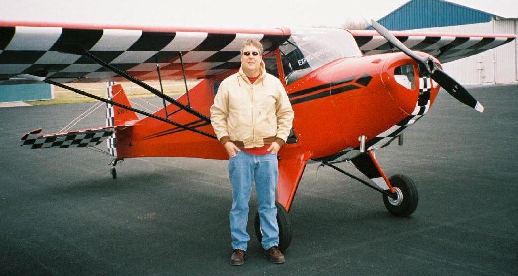

              Re: New clipwing rebuild
              Some pictures from the first flight.
                Damn, that looks great ! Gotta be nice. Which engine. Certain you said so before. How far are you from Chicago ? Have a very good Navy buddy there. May be going there soon.
                  Looking good, Tom! 125 cruise on 90 horses and under-45 stall, that's awesome. Should be very useful for all-around flying, including off fairly short strips. I'm envious.....
                        Hey Tom,
                        You forgot the picture from the back. Did you do the paint scheme on top that you showed me?
                          Originally posted by M Towsley
                          Hey Tom,
                          No. It's solid red on the top. From the back or side with the exception of the ruder it has a stock scheme on it. Tom
