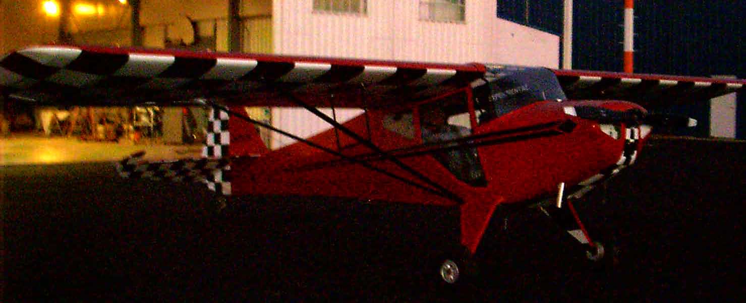

Hello all. I'm hijacking my dad's account since I can't post on my account yet. Just thought I would let everybody know that the Margret Ritchie clipwing is almost ready to take to the air again. The airplane has been totally rebuilt. It still has the Continental C90. I have attached a picture, but it was a little dark when it was taken. I will try to add some better pictures, and maybe a flight report in the next week or so. Tom D baker (the son)

Originally posted by Tom BakerHello all. I'm hijacking my dad's account since I can't post on my account yet. Just thought I would let everybody know that the Margret Ritchie clipwing is almost ready to take to the air again. The airplane has been totally rebuilt. It still has the Continental C90. I have attached a picture, but it was a little dark when it was taken. I will try to add some better pictures, and maybe a flight report in the next week or so. Tom D baker (the son)
Is this the Clipped-T that used to live in Greenville IL?

Great to hear the Ritchie Clipped is back on its feet--ah, gear. If I am not mistaken (which I am often) this was the Tcraft Ritchie flew (eventually with 150 hp) before she moved on to the Stephens Akro.
I was stationed at Scott AFB and renting a hangar at Greenville when the T-craft arrived. The simplicity and capability of this aircraft is what convinced me to build a Clipped-T. I remember the wings were all wood to keep the weight down and the interior was very rough--please confirm. I would be very interested in seeing pictures of the restoration--especially how the aircraft was built.
Thanks (again) for saving a bit of aviation history. Next time I am in the Effingham area, I will stop by your father's shop and chat.
dd
Re: New clipwing rebuild
As far as I know the airplane always had a C90 in it. The wings are wood spar with pre war built up ribs. It has a single surplus military seat mounted in the center. We cleaned it up some with a new panel, but it is still very sparten inside. I just weighed the airplane this morning to check the C of G. It came out heavier than I expected. I want to do some checking to make sure my numbers are right. Dad is coming down this afternoon so we can do the initial start up and adjust the carb. I will try to get some better pictures when we have it outside. As far as pictures during the rebuild we have some, what details do you need? Tom

Well had it on the scales this morning, and was a little dumb struck by the results. It shows an empty weight of 830. The last weight and balance for this airplane showed a empty weight of 770. I don't know how we could have added that much weight.
Our start up this afternoon didn't go to well either. We had a small pinhole in the fuel tank. It's really frustrating because we had the tank leak tested before it was put in the airplane. We'll get it fixed and back in there next week.
Here is a list of items from the back of the 337 when the wings were modified.
1. Shortened front and rear spars by 30" at inboard end and 12" at tip end.
2. All existing ribs (except one) were used by decreasing the rib spacing from 15" to 11" (Approximate average).
3. Length of outboard compression bay was shortened to match existing bays.
4.Additional reinforcing plates of 3/8" spruce added to rear face of the front spar, and to the front face of the rear spar in the area of the fittings. 48" in length.
5.New strut attach fittings fabricated from .065" 4130 steel.
6. Butt fittings adapted from original strut fittings. Birch reinforcing plates added to butt end of both spars.
7. Replaced .012" 1/4 hard Alum. leading edge with .016" 2024 t3 Alum. and extended to front spar.
8.Used existing tip bow, aileron bellcrank, andaileron hinges.
9. Shortened aileron at outboard end 12" to match wing. relocated outboard aileron hinge point.
That is all that is listed on the 337. During the restoration we added a second set of tail brace wires. We also changed the fuse strut fitting angle (it had unchanged fittings). The control system is all cables as Dennis mentioned. We also installed a Christian inverted oil system.
