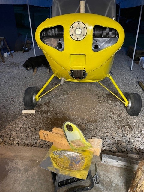

    ALRIGHT! Another metal bumper! Please post more photos!!!
      N44122 first flight after restoration this morning. Thanks everyone for the valuable information!!!
      To recap since purchase of the project in July 2020 I had to:
      repair and re-cover the elevators,
      re-make the cowl bump for the LH plugs and the bump for the air intake,
      get the field approval through a DER for the rivets the previous owner used to attach the wing fabric.
      correct dragging aileron cove,
      make aileron cables and install a battery powered radio,
      repair the pully tabs for the rh seat brake pedals.
      I don't think I could have done it without all the valuable information provided by this Forum. Thank you all again!
