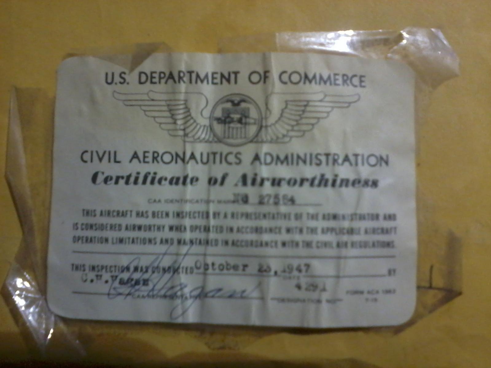

                Re: FAA records don't match data plate
                This is what I've received from the seller; there is no serial number or other info, just the N number.
                Thanks
                  Eddie,
                  Prior to somewhere around 1956 aircraft got a new airworthiness certificate every year when they successfully completed an annual. Then, I believe the year was 1956, they decided to issue a permanent airworthiness certificate and make it amendable through a logbook entry of a successful airworthiness inspection. So, any airworthiness certificate issued prior to whatever year it was, 1956 plus or minus a year or two, is no longer valid. My plane had this same situation when I bought it. I had to go through a conformity inspection with a DAR to get a permanent airworthiness inspection. The conformity inspection is a really good way for you to get to know your plane. The DAR goes through the logbooks and the airplane to verify that the airplane conforms to the type certificate. Unfortunately, DARs don't work for free. So it will probably cost a few hundred dollars for him or her to inspect your airplane. You also have to have an I/A inspect it for an annual inspection. It is best to find an I/A very familiar with Taylorcraft who also has a good relationship with a DAR. That way they can work together to coordinate the inspections. A good I/A will be able to tell you what needs attention to comply with a conformance inspection. If you are looking at buying an airplane that needs this done, I would suggest an even more thorough prebuy inspection with an eye toward conformity. An example of where you could get into a problem would be if the type certificate listed approved tailwheels, props, or engines and your plane had something different WITHOUT proper documentation, such as an STC or field approval. That would make it unable to pass the conformance inspection.
                      Originally posted by Pearson View Post
                      Eddie,
                      The Cessna 195 I purchased in 1985, had the old certificate. The airline pilot I bought it from (, who turned out to be an alcoholic, )flew it this way. It caused me a lot of trouble and the fed inspector said he could demand it be taken back to, as he termed it, " factory standard" . He wound up passing it but it was a close thing. If he had not been buddy's with the AI who was also the FBO it could have been a financial nightmare. A very close call. The airplane was grounded for 8 months while all this crap went on. Caveat emptor for sure.
