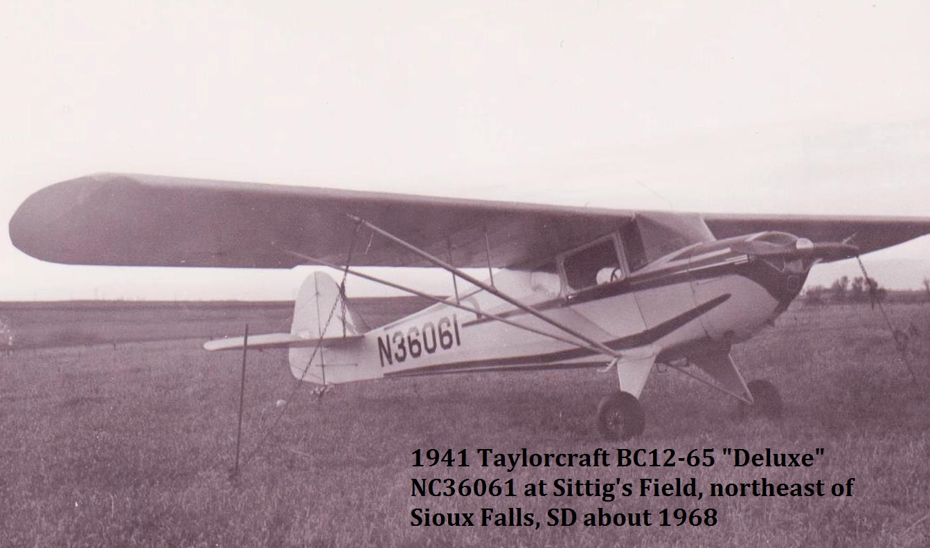

    Dec 9, 1967 Sold to Henry W. Luebke, et al, c/o the Sioux Falls Police Department flying club, Sioux Falls, SD.
    Jan 10, 1973 Sole ownership transferred to Henry W. Luebke, Sioux Falls, SD.
    August, 1990 Dismantled and placed in storage due to wing tip damage and failing fabric.

    My dad gave me my first airplane ride in 36061 in August, 1969 when I was six weeks old. It was kept in a hangar dad built from an old salvaged hangar and flown from a 1320' grass runway on the 40 acres we lived on. I grew up flying with dad, then learning to fly when I could reach the rudder pedals. He wasn't an instructor, but did a good job anyway, as I soloed on my 16th birthday with 2.7 hours of dual in my logbook. I was signed off by Russell Zangger, Larchwood, IA, Iowa Aviation Hall of Fame member and legendary Taylorcraft instructor. At one time, Russell had three Taylorcrafts, all painted the same red, black and white scheme. His son Jim still has one of them.
    The current restoration effort probably wouldn't have begun if not for the persistence of Doc Walker in getting it out of storage and into his shop. Doc has been a master craftsman/builder/restorer for years, and even worked at Rare Aircraft in Minnesota building Wacos and such for a while. He is very meticulous and his attention to detail will make this airplane much better than it was when new. Apart from adding Terry Bowden's STCs for a C-85/O-200 and maybe Luscombe exhaust, the airplane will look factory-original when done. I believe the airplane was yellow over medium blue when new, as yellow butyrate is noted on one of the early wing repair 337s, and traces of blue paint were found in the lower cowling and fuselage when it was taken apart. When dad's flying club bought it in 1967, many of the "Deluxe" features were missing. I've spent years scrounging parts - cast nose bowl grills, stainless steel cowling and door trim, Deluxe instrument panels and "banjo" yokes, and the holy grails - Taylorcraft compass and original wheel pants. Connections made through this forum have been an invaluable resource for parts, drawings, information and advice.
