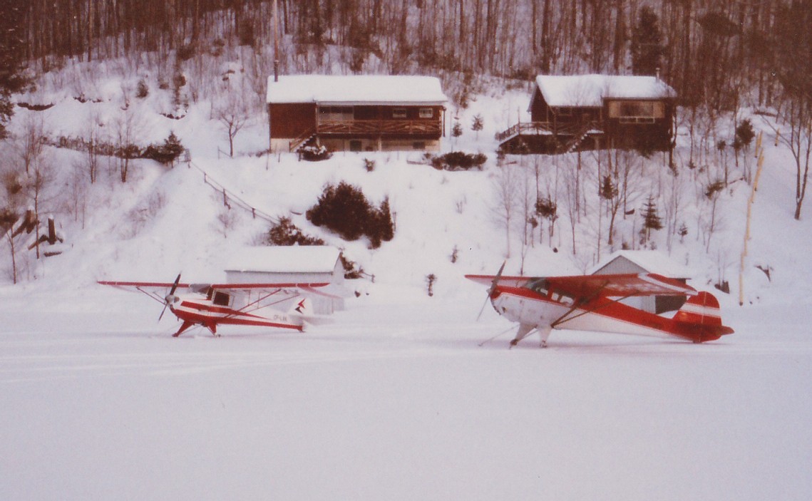

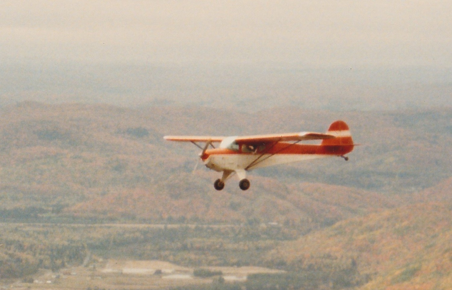

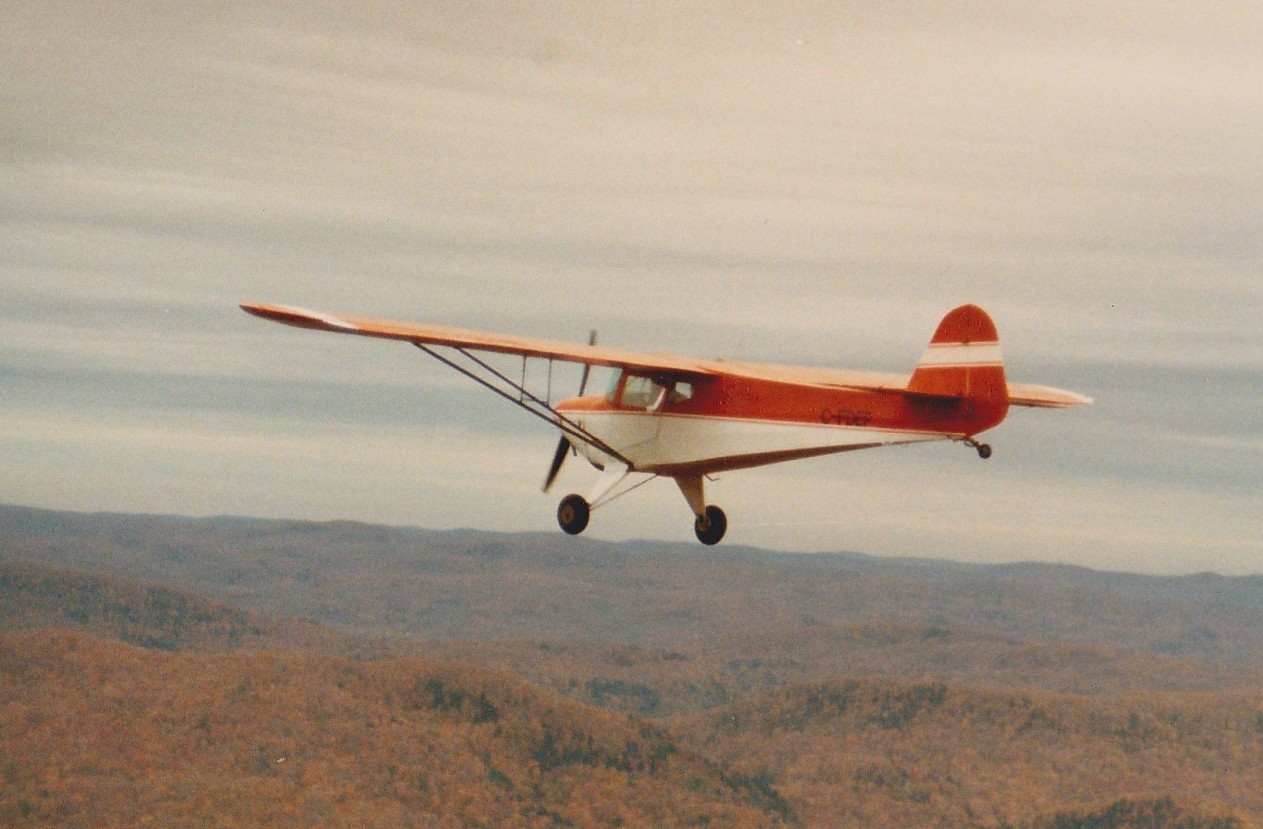

    1946 BC12D S/N 8886 A65 Continental
    I purchased this aircraft over the phone in 1984 with the intention of rebuilding it. The wings had been removed for storage in the seller's basement. I trailered it home and soon realized it was actually in reasonable shape, so I replaced the windshield, checked conformance on all Ad's etc., did a few fabric repairs, put on some new tires and flew it on wheels and skis until 1989, about 150 hours.
    In 1989 I started the restoration but career changes, kids, and moves back and forth across the country (Canada) means not much progress until now. Now the kids are away at school and it's time to get to work.
    These are scans of photos taken beck then. The more recent photos I have are of boxes of parts!

    Wow. Cool story. Good looking ship.
