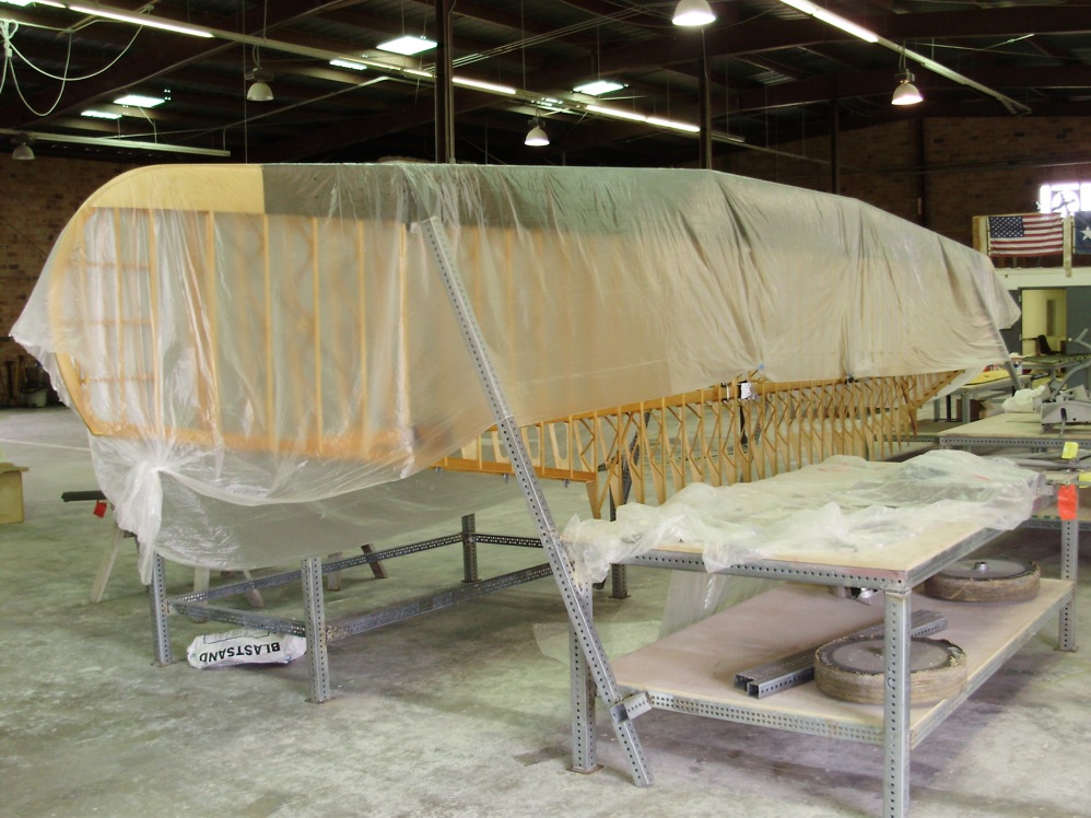

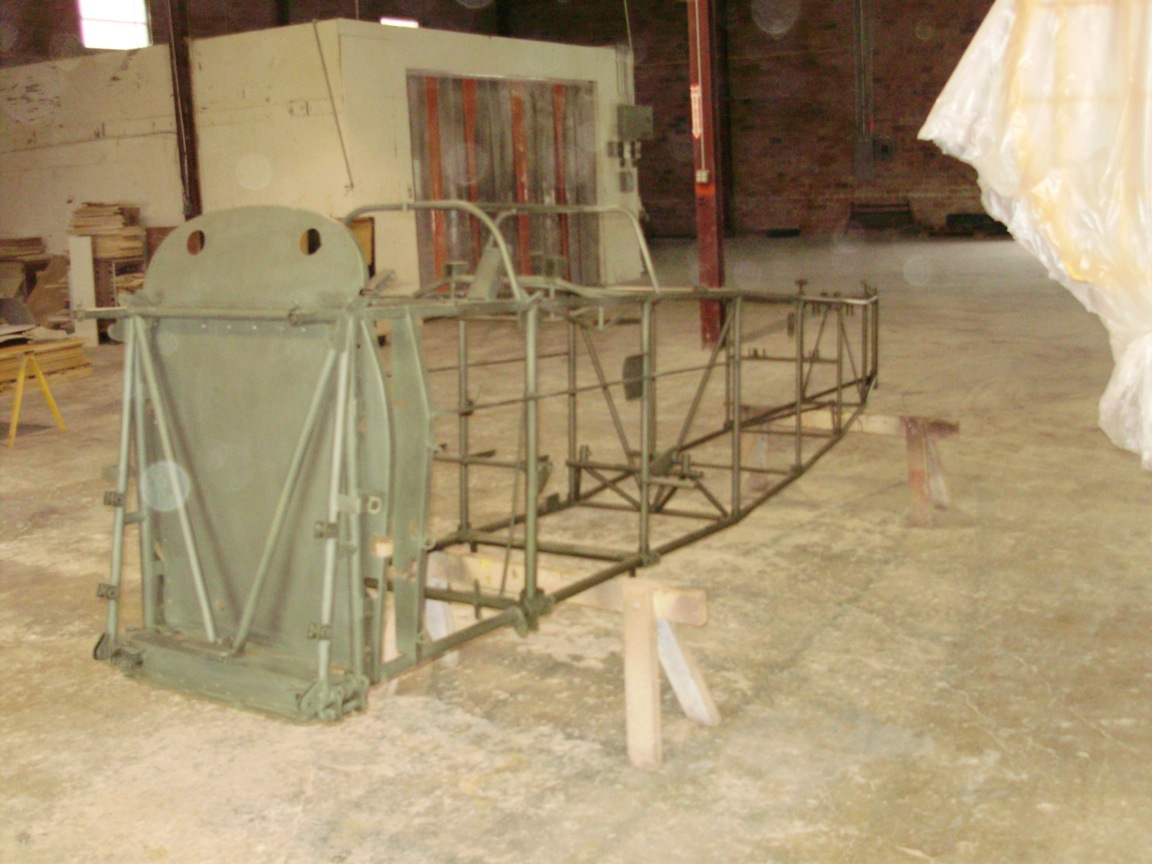

              The Curtiss F-6C4 was flown by the USMC. This remaining example belongs to the National Museum of the Marine Corps. The technology is fascinating.

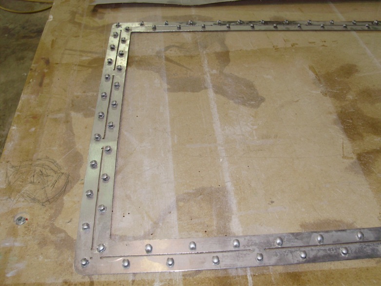

              Here are two photos taken during the restoration so far. One is an example of a lace-in panel frame. New boot hooks will be swaged onto this frame after a 4 inch fabric tape is applied - thereby capturing the fabric under the hooks.
              We are purchasing boot hook swages that mount in an arbor press to do this task.
              Next photo is how I covered the wire trailing edges of the lower wings. Per advice from Jim and Dondi Miller, I could have done an overlapped glue joint over the wire, but I decided to go in keeping with the original fabric. I had to dissect some old linen to figure out the secret of covering the wire. I'm happy to say the zillion stitches held perfectly when the iron hit the fabric.

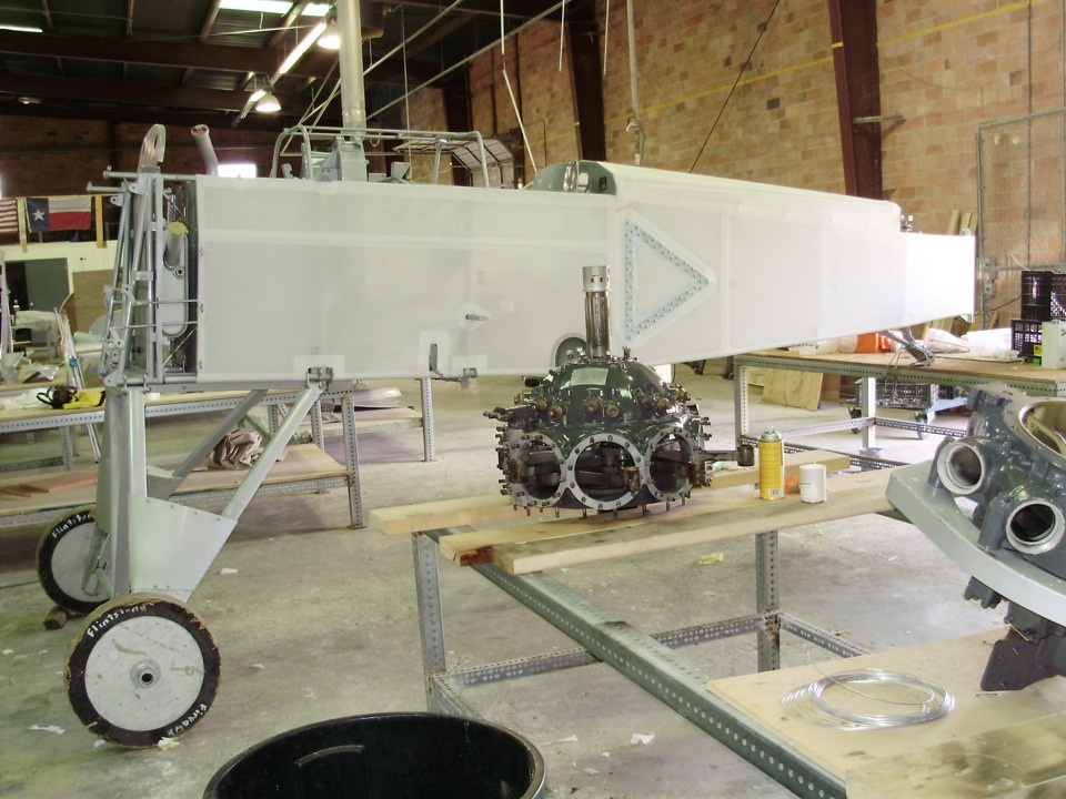

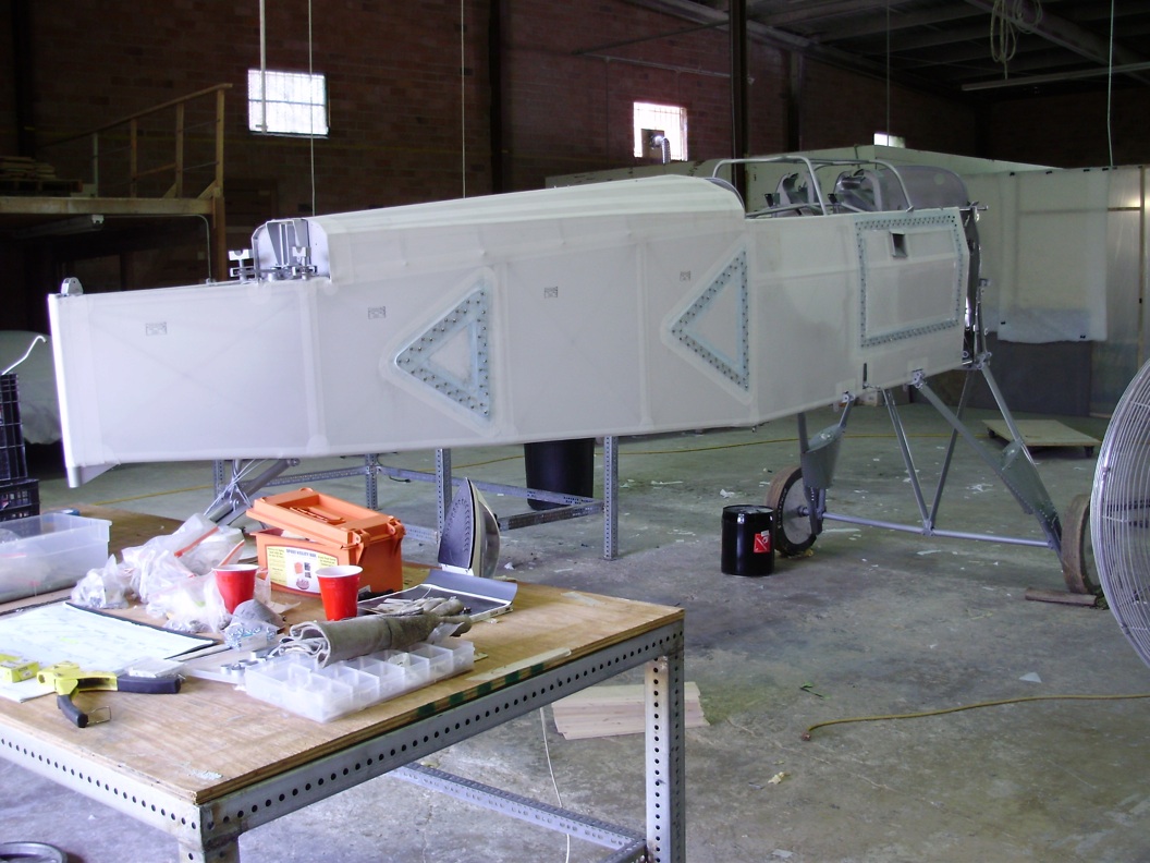

                A photographic progress report on the Curtiss F6C-4.
                Yes, I sat in the cockpit and it IS way cool.

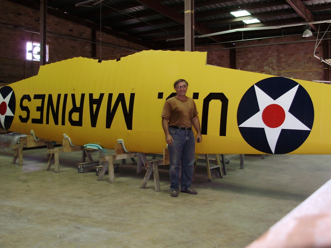

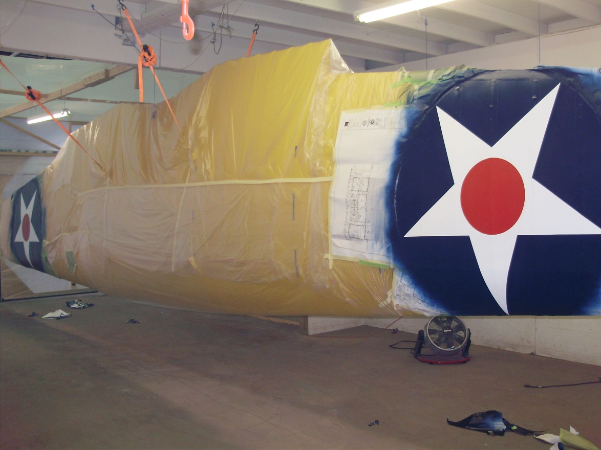

                  Nice! That does look very cool... So were you done with the house plans used for masking the wing, or did the F6C-4 project kill the house project? (they kind of look like house plans anyway )
                  Mike
                  NC29624
                  1940 BC65
                    Re: 2000 rib stitches
                    So were you done with the house plans used for masking the wing, or did the F6C-4 project kill the house project? (they kind of look like house plans anyway :clue?
                    OK ya busted me fair and square
                    The shop where I have been doing this project has many sheets of left over technical prints. The boss is a cheap skate and real masking paper is scarce.

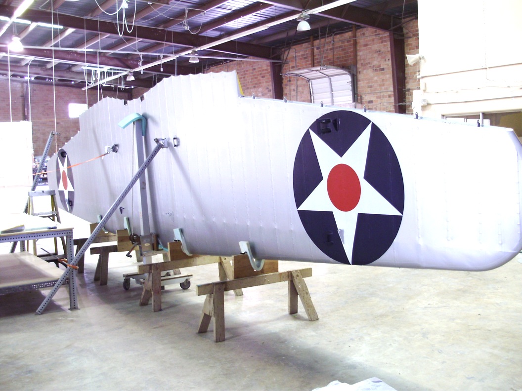

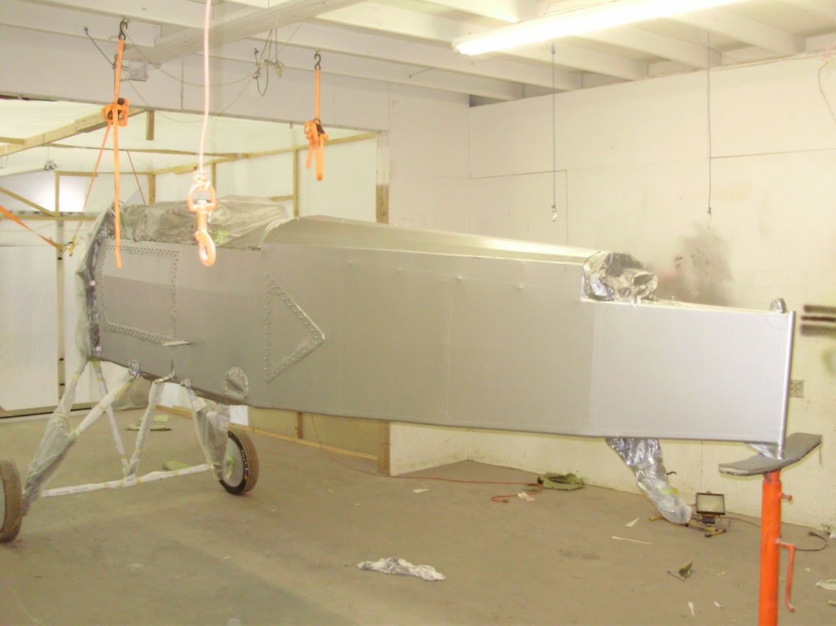

                      Top wing is FINISHED!
                      Fuselage has two coats of silver and will be completed this week.
                      This plane will be going back to Quantico Virginia next month. It will be displayed whenever the new National Museum of the Marine Corps is complete enough to house it.

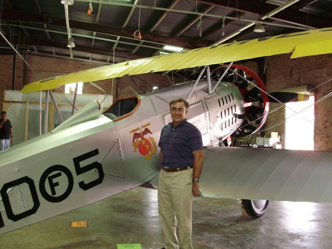

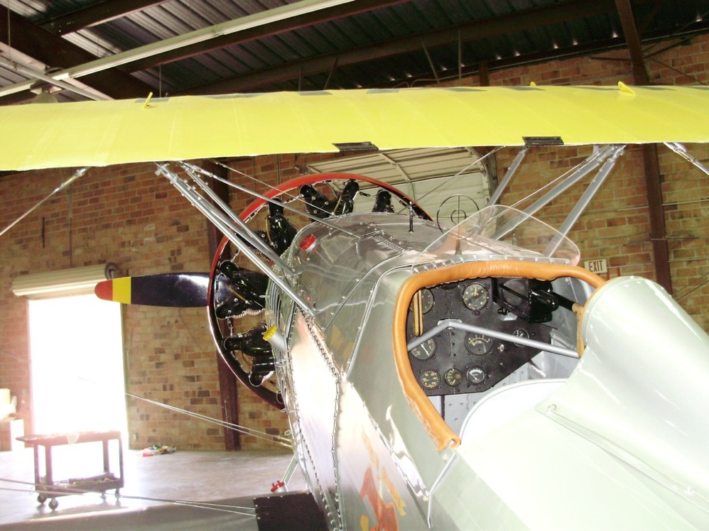

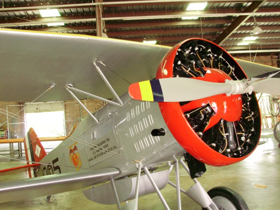

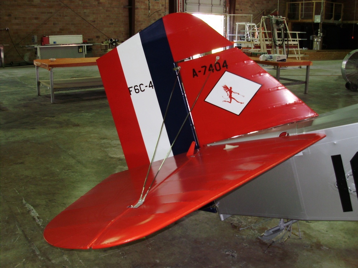

                        The Curtiss F6C-4 is complete and on the truck going to Quantico, Virginia.
                        Here it is - mostly assembled. You, with the sharp eyes, will find a few items not all installed and airworthy.

                          She's a beauty! Nice work.

                            Beautiful!!

                              She's something to be very proud of Mark.
