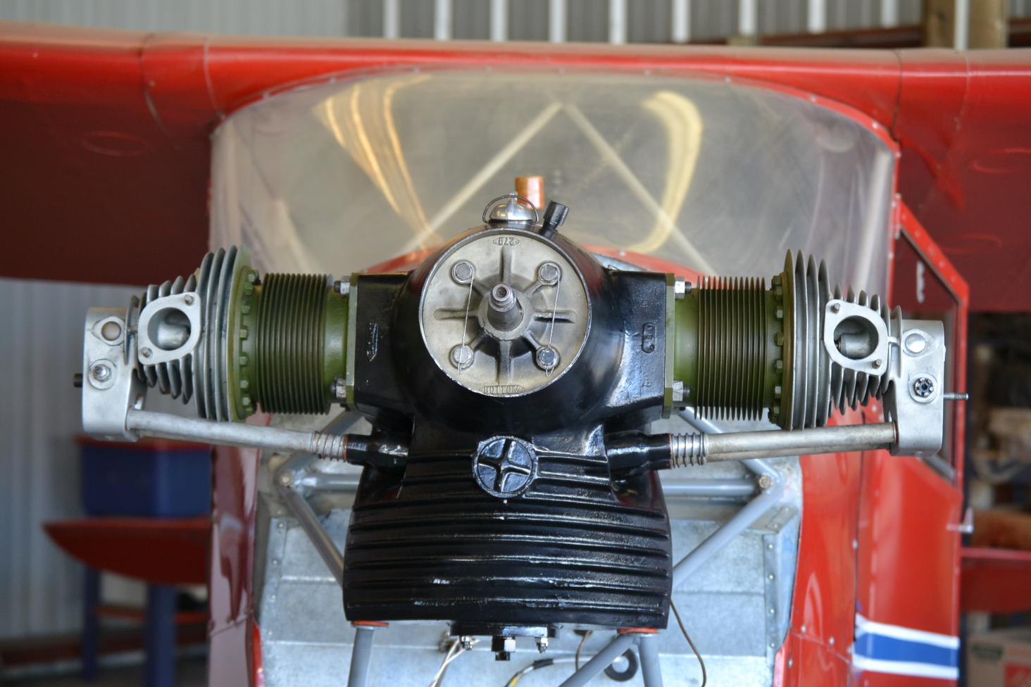

Name:	Aeronca K engine.jpg
            The little wing on the top oil cap and the ribs etc on the case make me think "Buck Rogers" every time I look at them.
