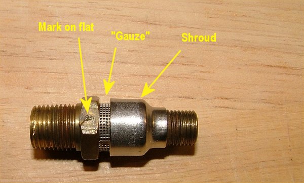

    I'm servicing a bog-standard fuel-injected Lycoming engine. It has injectors like the attached photo.

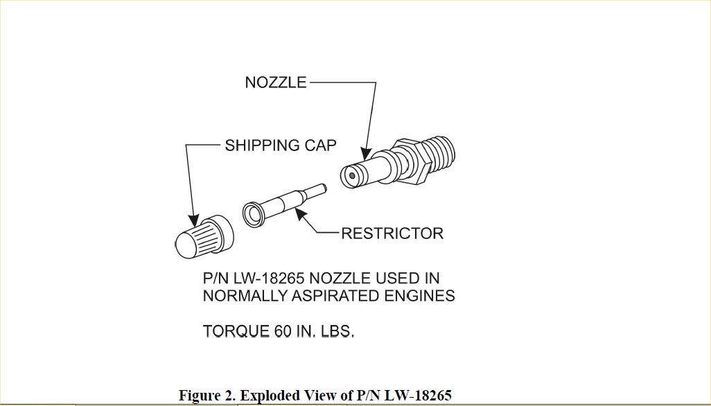

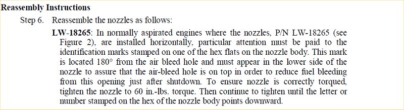

    I also attach two pictures of the September 2008 Lycoming Service Instruction (SI) on injectors.
    Figure 2 (see attachment) apparently shows the common injector for a lot of Lycoming engines.
    Step 6 (see attachment) , it talks about how to orient the injector.
    My injectors have never looked like the 2008 SI, and this is a 1984 engine. Mine have a shroud and a gauze.
    Am I missing something?

    Others please chime in too, but I'm pretty sure the drawing is of an older style nozzle. The injectors you have should not have any particular orientation.

      Same injector style, just shown with the screen and shield removed.
