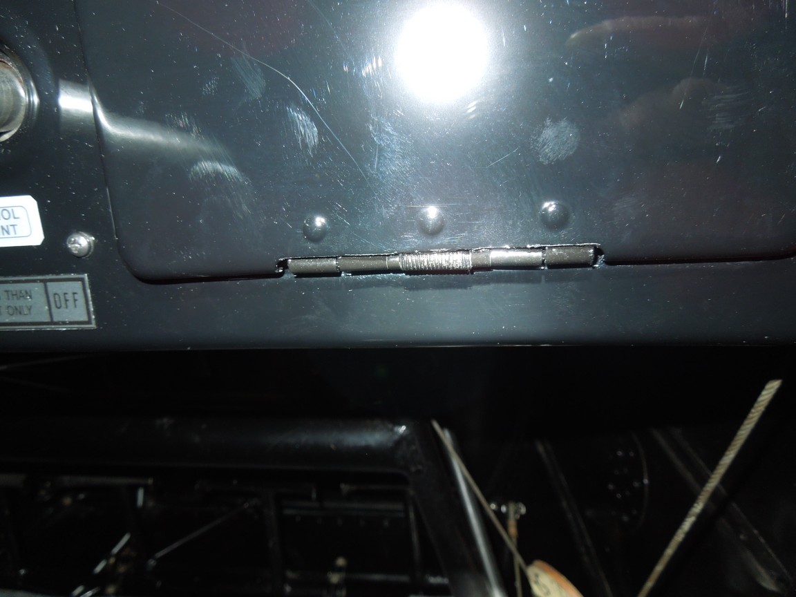

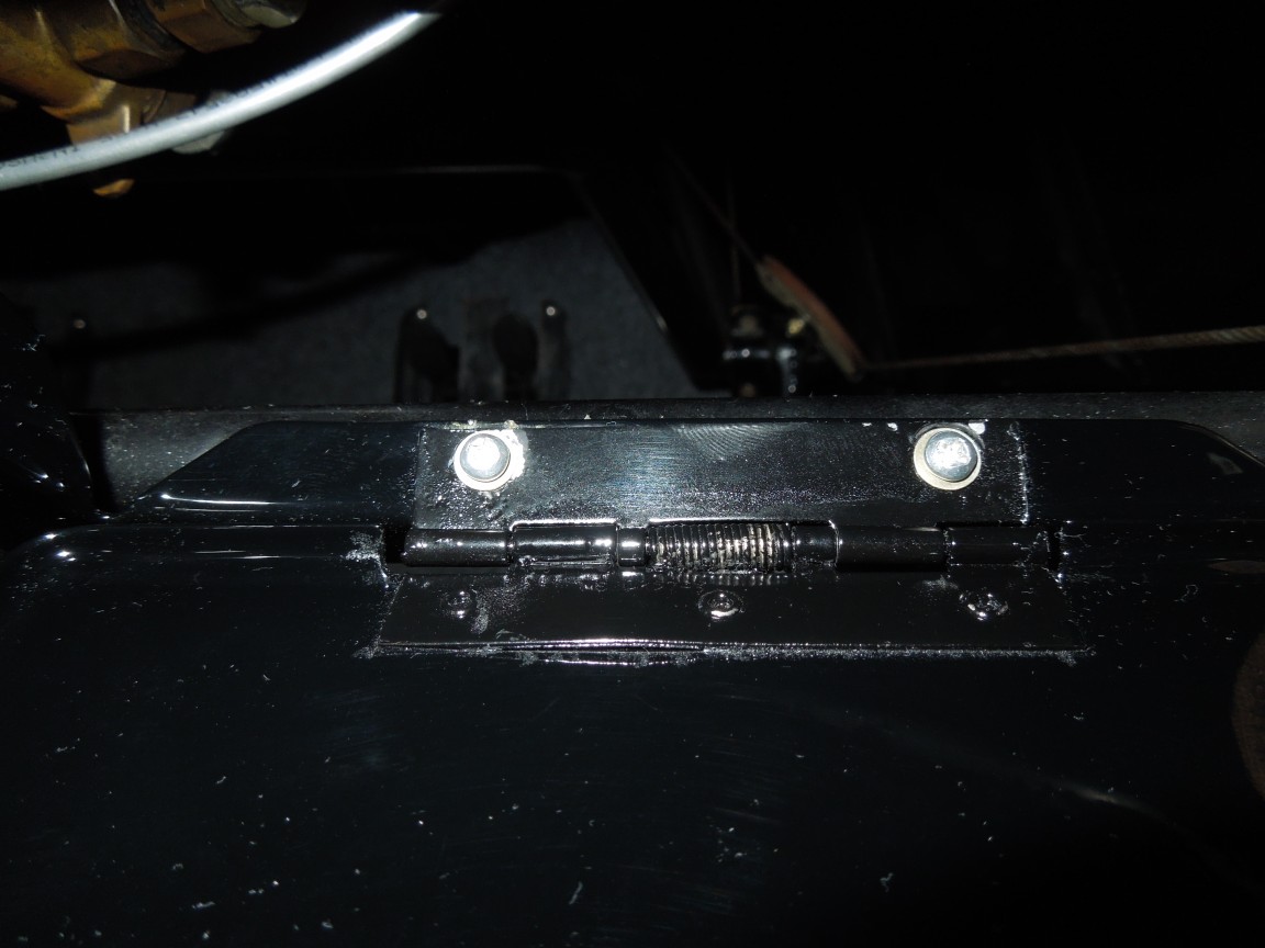

    I got a new panel and two new doors from him last year. He found a spring manufacturer for me and had new ones made. That is why you ended up with one. The springs are made just like they originally were. They are riveted to the doors and then bolted to the instrument panel. The bottom I think. Next time I am at the hangar I will have to look again.

        Hope these help. I used a couple of small screws and those arched square threaded plates, (can't remember the name of those), to attach to the instrument panel. I

          Guden spring has the correct hinge. Rivets hold it to the door and screws to the inside of the box. Tim
