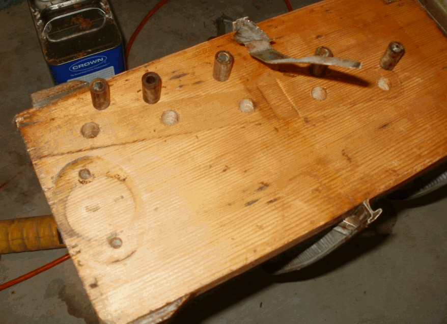

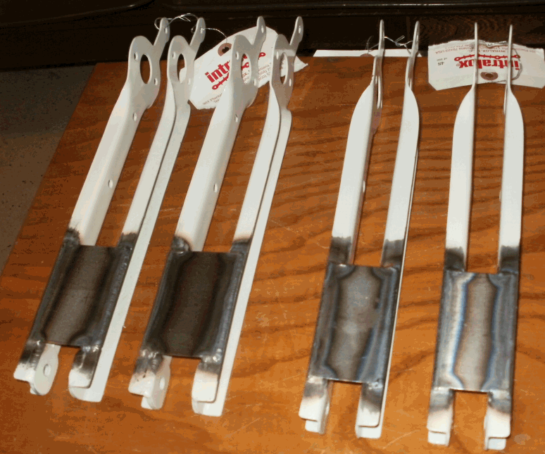

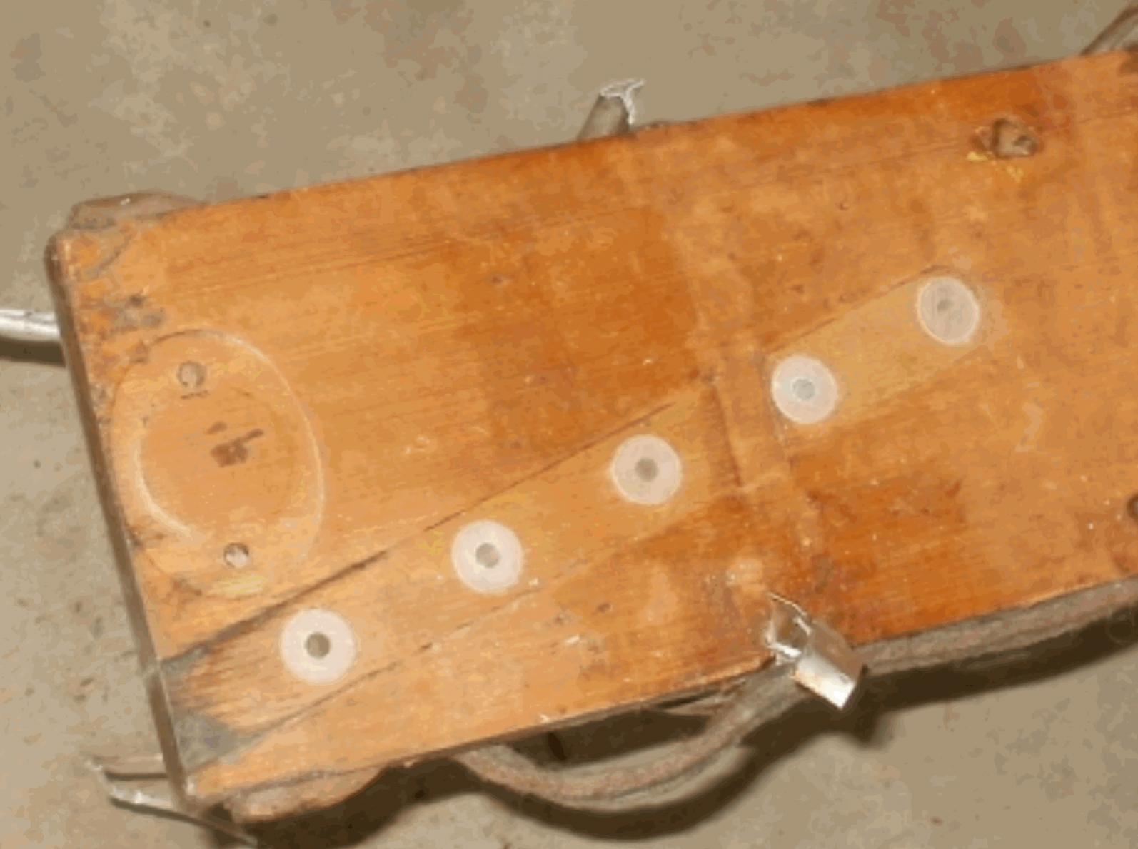

                          Wing mods:
                          I'll try to attach before and after pics of the spar bushings and the strut attach brackets below.

                              Originally posted by TimHicks View Post
                              Wing mods:
                              Thanks Tom!!!
