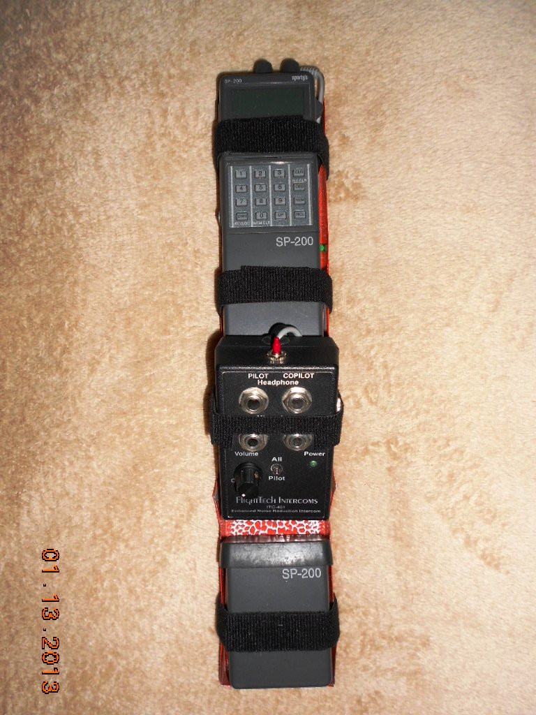

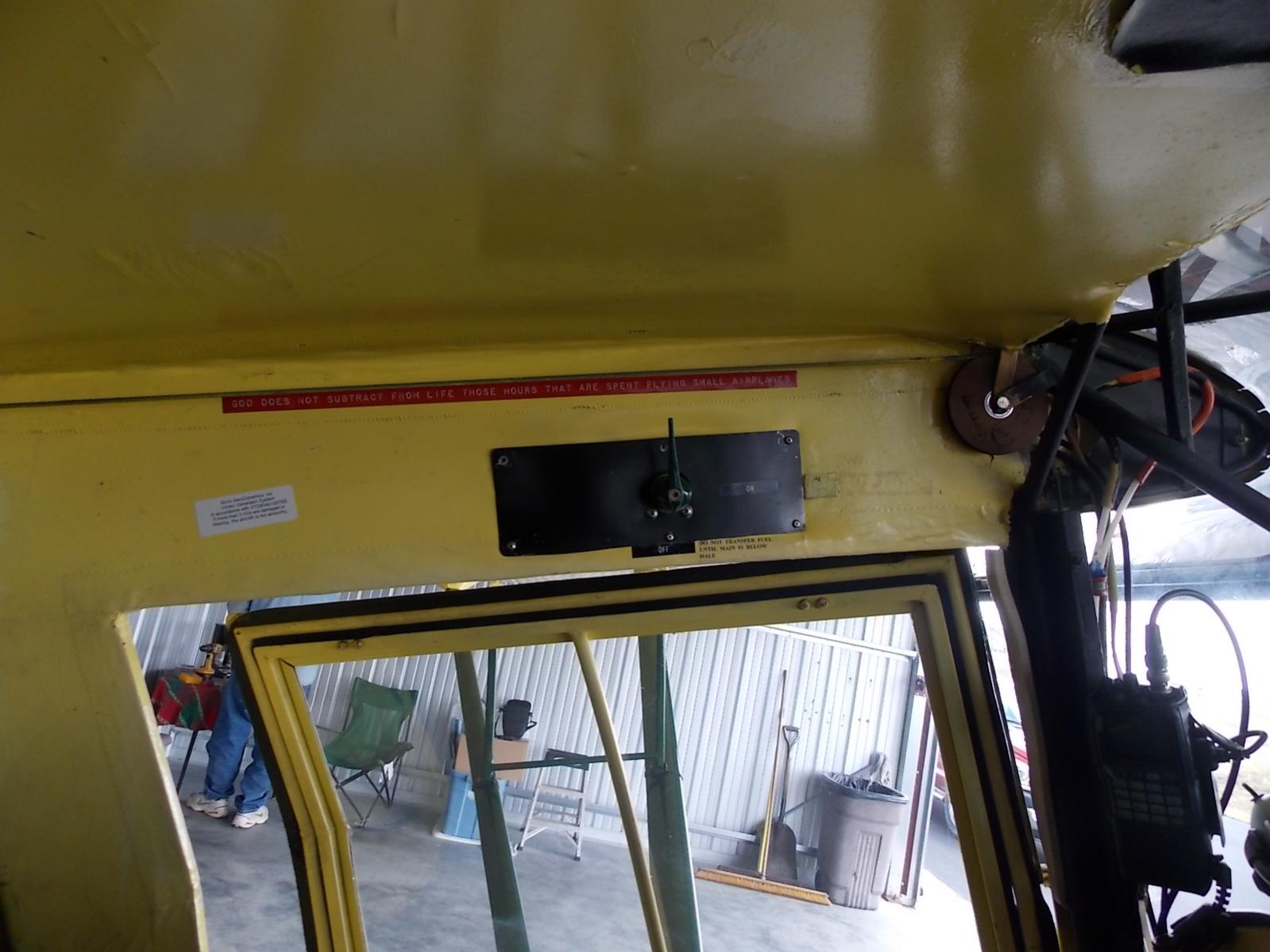

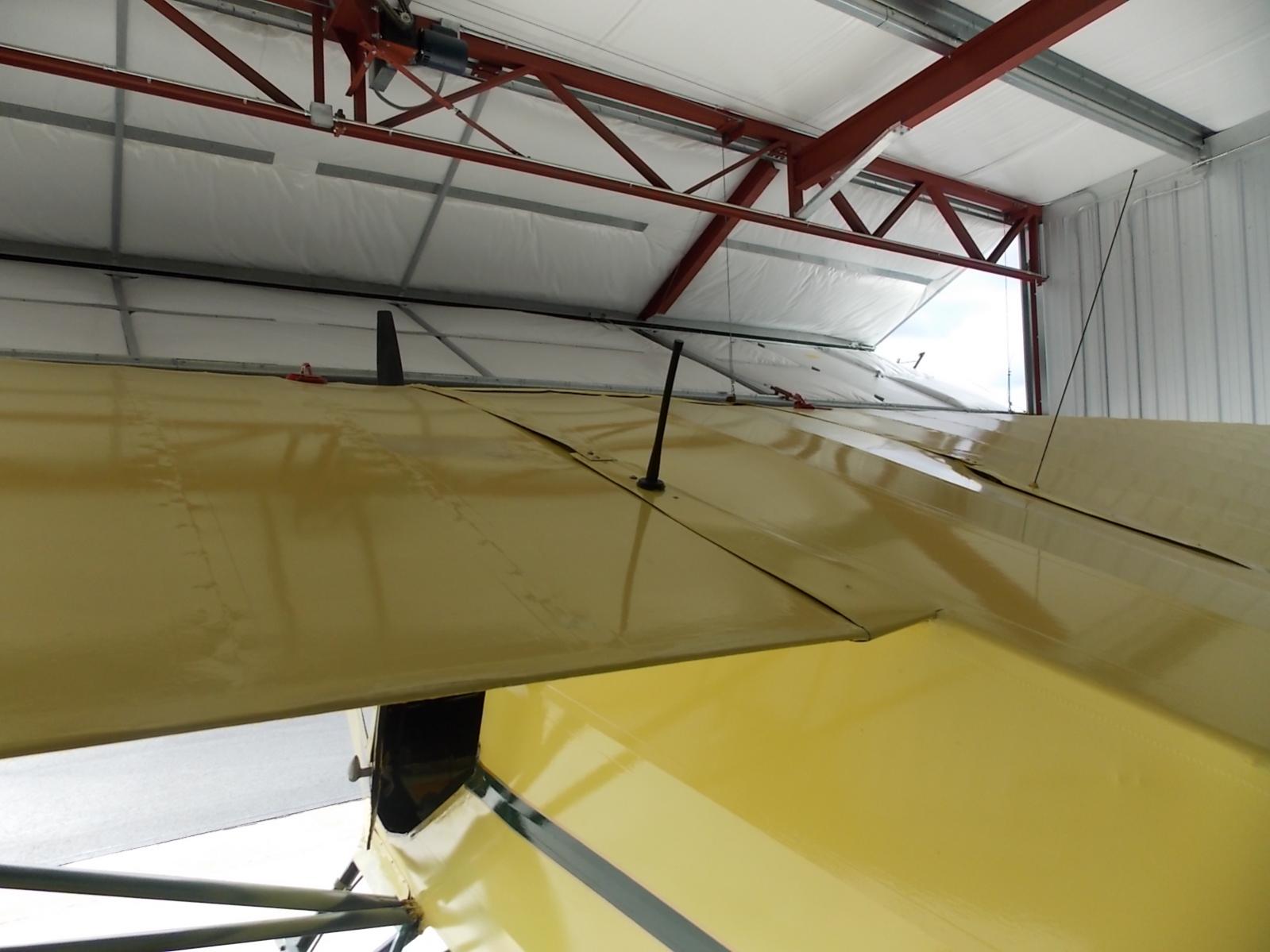

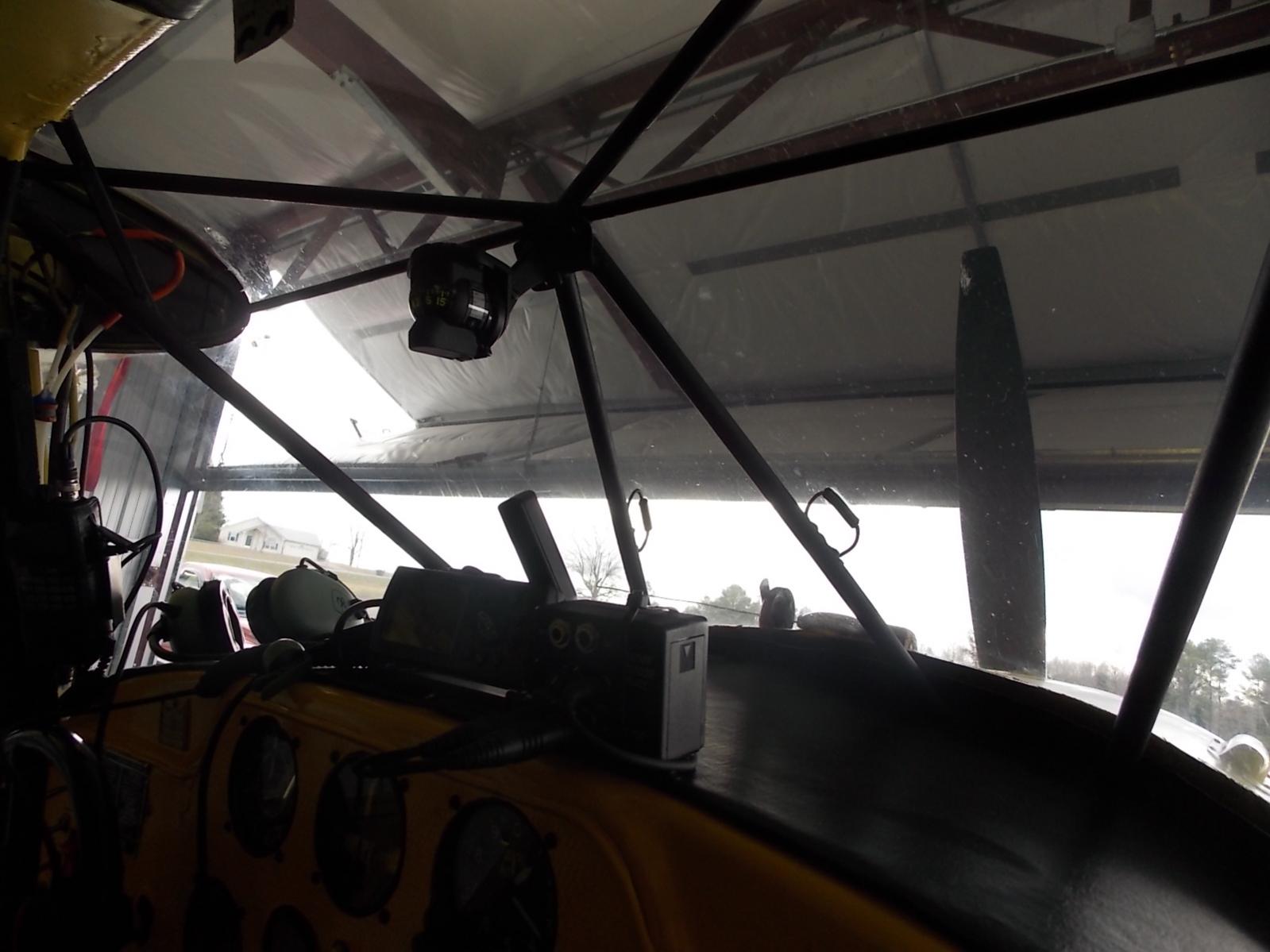

          This is what I've used since 2006. Sporty's SP-200 and FlightTech ITC-401 intercom with PTT sits on seat betwixt pilot and passenger, antenna cable from whip on bottom of fuselage attaches top left of SP-200; easily portable.
          Mike V.
