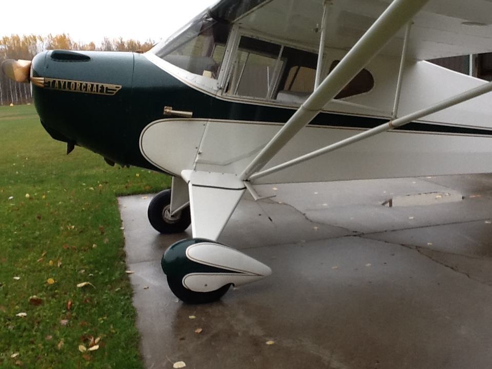

                Hear is the photo of the decal/painted logo on the front of a 41 Louie was talking about. I like it!
                If anyone wants to try and make the stainless trim pieces let me know. I had considered making them from Carbon Fiber and epoxy with a metalized coating because they are so hard to find. I found an original set and never got around to it but the process works pretty well. They wouldn't be cheap, but look original.
