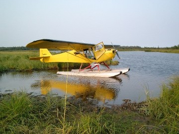

        Robert, I sent you a private email through this list.. Lance, here is a pix from over at "The Mudhole" on the Kustatan.

          Nice pic. dick..Thats where we have our pick ups for our raft trips. We drift from sibs lake to the mud hole what a blast for silvers!!!
