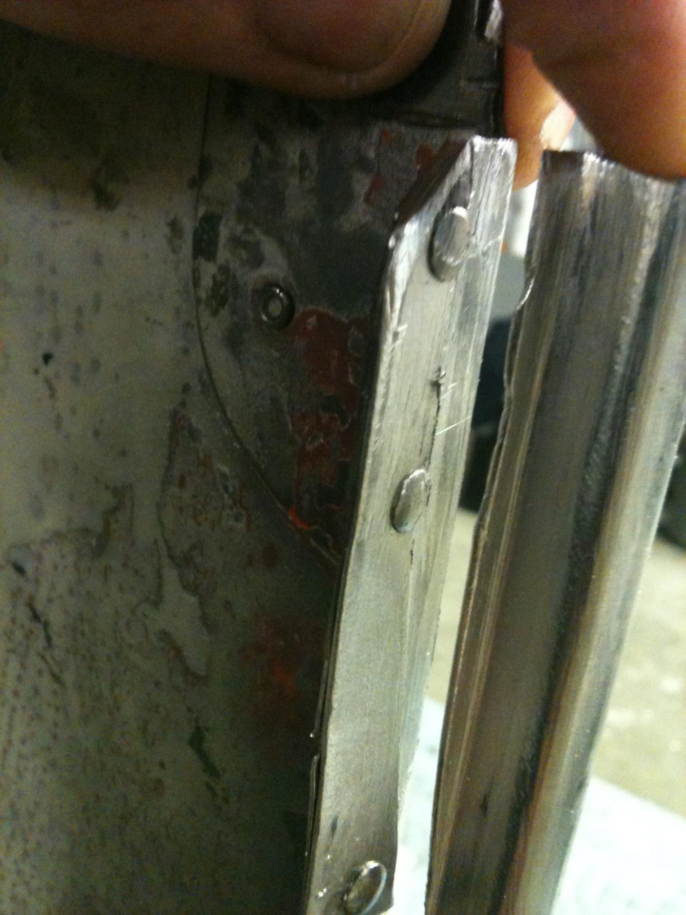

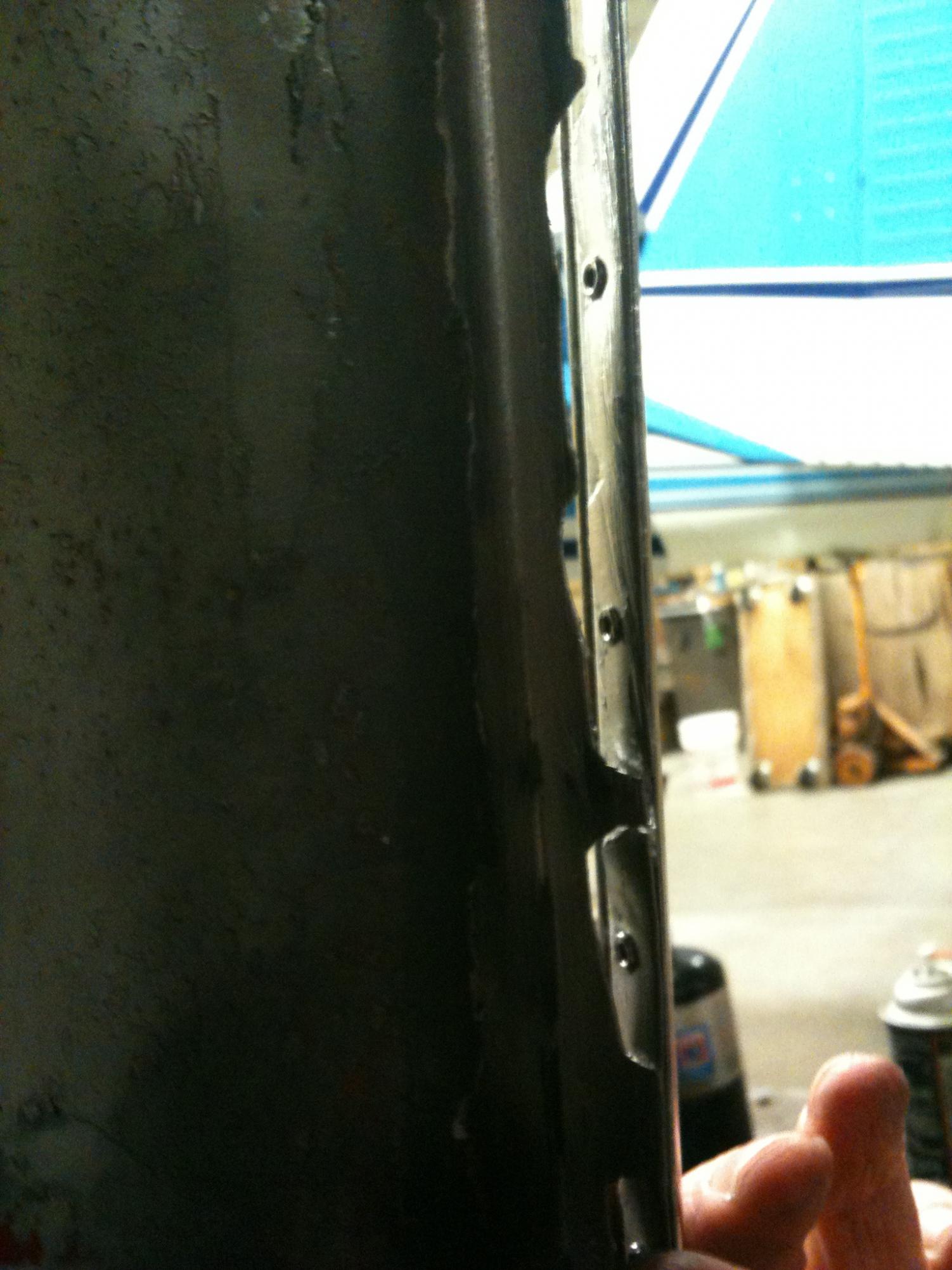

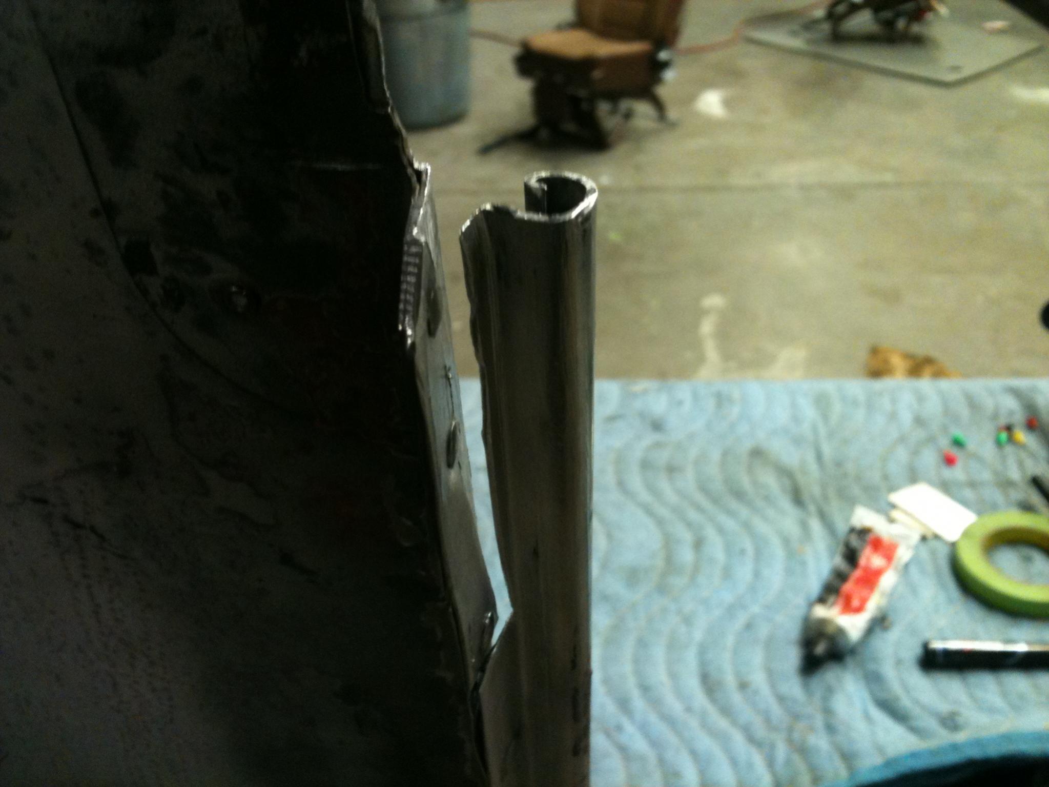

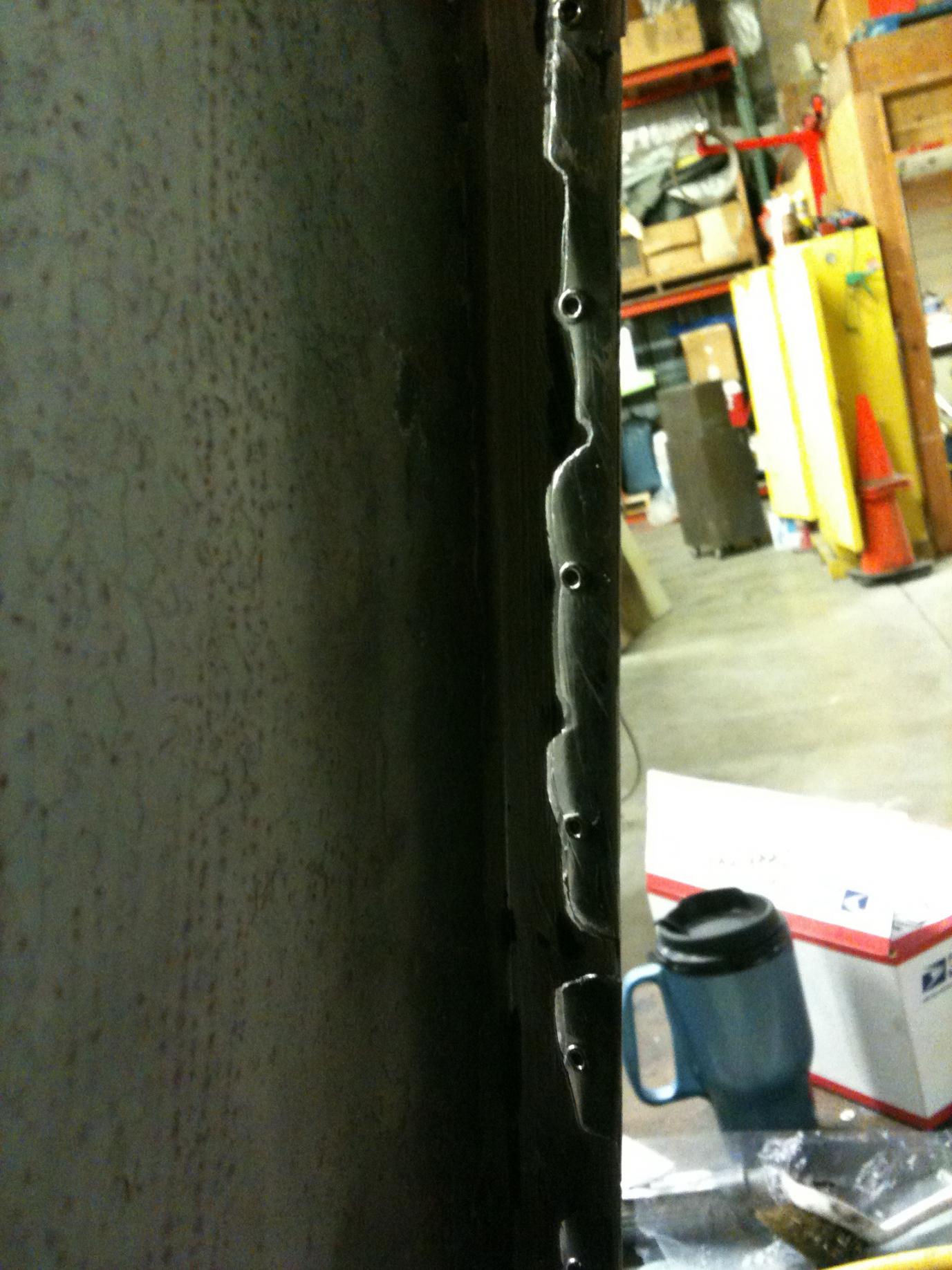

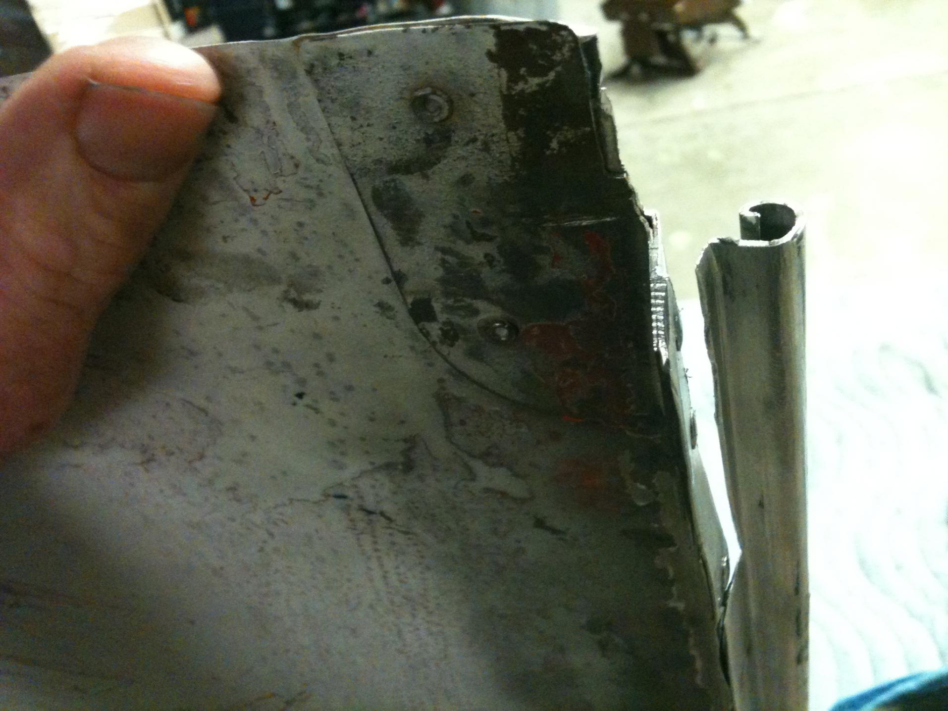

    has anybody had a problem with the metal fatigueing and cracking on the side cowling hinges? mine did the other day and I was wondering if anybody has a source for the parts for this hinge. Fairly thick aluminum for such a sharp bend.

    Wow! I have seen a lot with cracks, but not THAT bad. I would bet that the pieces of aluminum were not rolling past each other and the metal was bending back and forth when the cowl was opening. That would fatigue the metal pretty fast. The two pieces of aluminum should curl into and out of each other with almost no load. If you have a hinge where the metal is flexing it IS going to crack!
    There were some recent threads on replacement hinges (they came up RIGHT AFTER I spent HOURS getting my old ones working really well). Maybe someone can point this thread to that one or re-post where they could be bought new.
