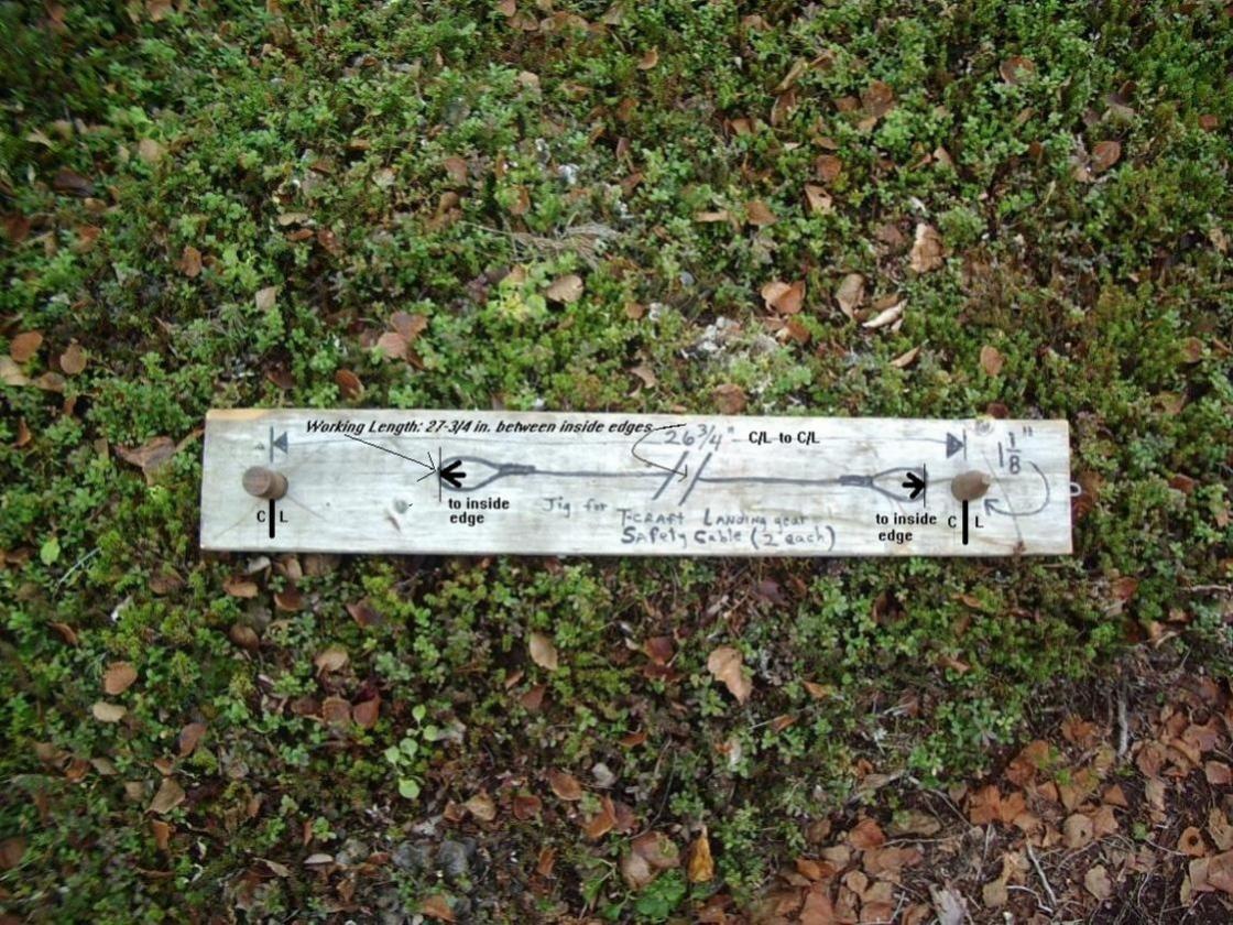

          This jig, that I used to fabricate replacement landing gear safety cables for my BC-12D , has the "posts" on each end 26-3/4" apart...Center to Center. The posts are 1-1/8" inch in diameter. When I built safety cables by wrapping 3/16 " cable around the posts and securing them with Nicopress fittings, the finished cables measured right at 27-3/4 " (ie., stretching a cable straight and measuring the over-all length available, inside edge to inside edge.
          Dick
