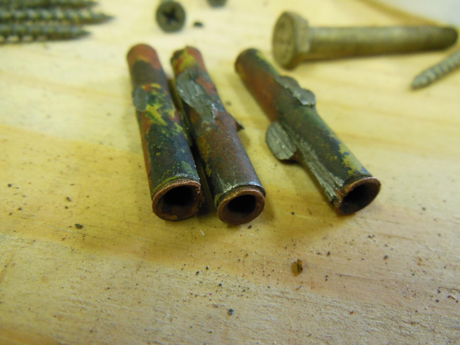

    Good info. As I recall there are either one or two very small "fairleads" for the trim tab cables to go through. any suggestions of replacing those?

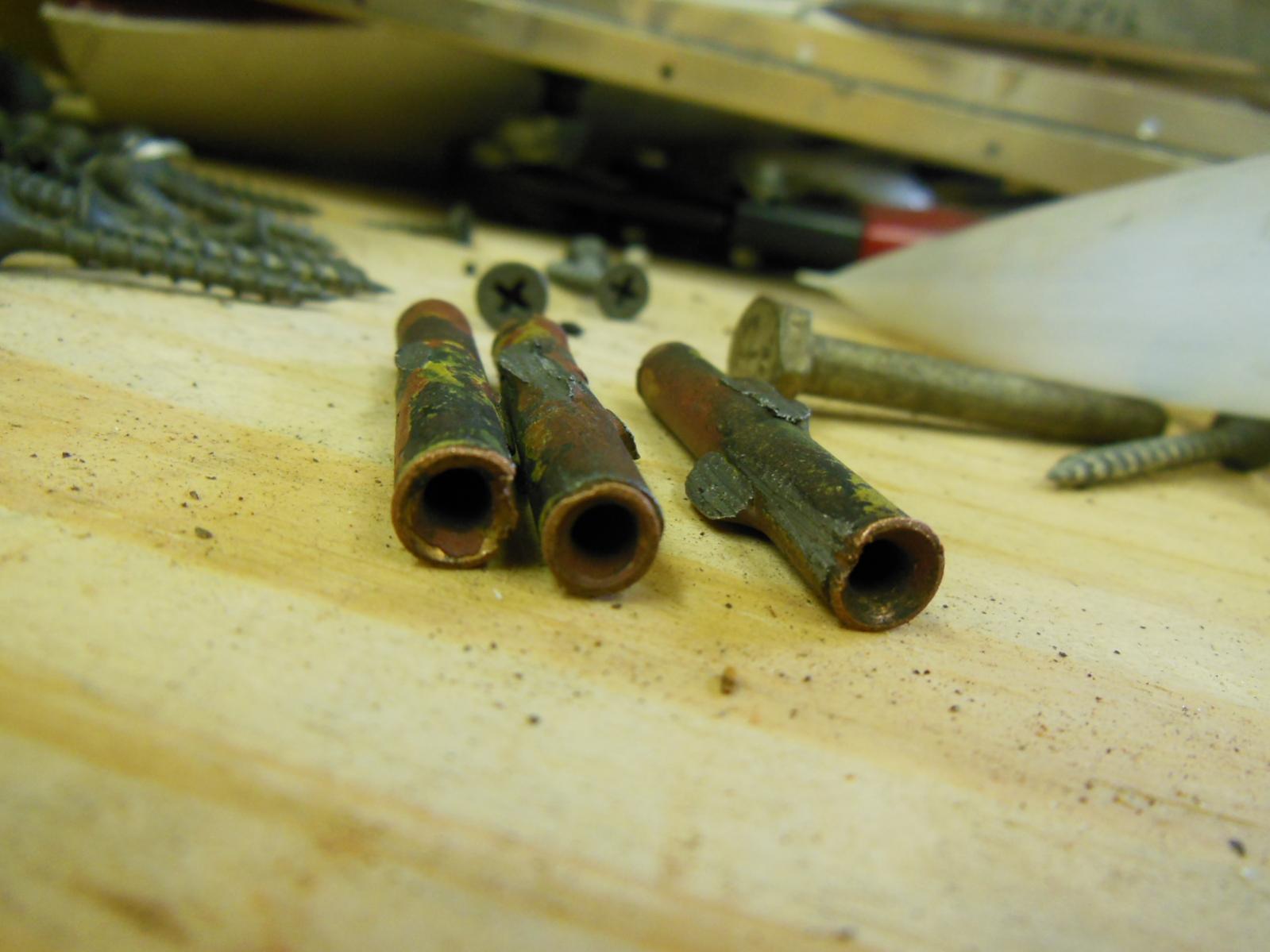

            These ones have two little copper fair leads driven into each end the steel tube that the cable goes thru.
            They are probably formed from a copper tubing say 3/16"
            Clean off the paint and I bet you see copper Marty.
            I think I have some will try to do a photo Thursday.

                Here are some pictures of the fairleads with copper inserts.
                They look like pieces of copper tube that have flared in standard flaring tool and then inserted in the steel tube.

                  Interesting, thanks for posting those Dave. I've got a video stick and may be the camera head will reach back there so I can see. That should answer Lee's question.

                    The trim fairleads should have thin-walled copper tube in them. Purchase from a hobby shop.
