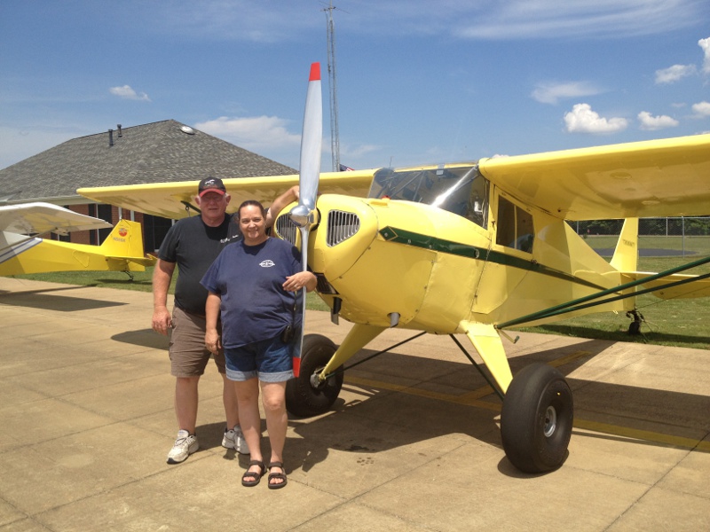

        Mark as Hank and Marty have said the tcraft is larger then people think from the looks of it this photo is from a fly in this past weekend and as you can see we aren't small people Oh the bush wheels add a new dimension to mounting the plane
        1940 BLT/BC65 N26658 SER#2000
