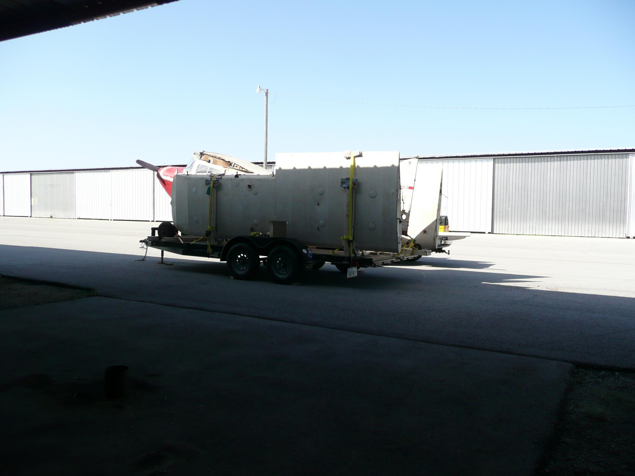

Trailered from south of OKC to ICT.Attached FilesDavid Johnson

I know I've posted this one on here before, but here's mine, on one of it's trips across MT, ID, and WA... I borrowed a "thistle" sail boat trailer and the rest is pretty explanatory... it traveled just fine!

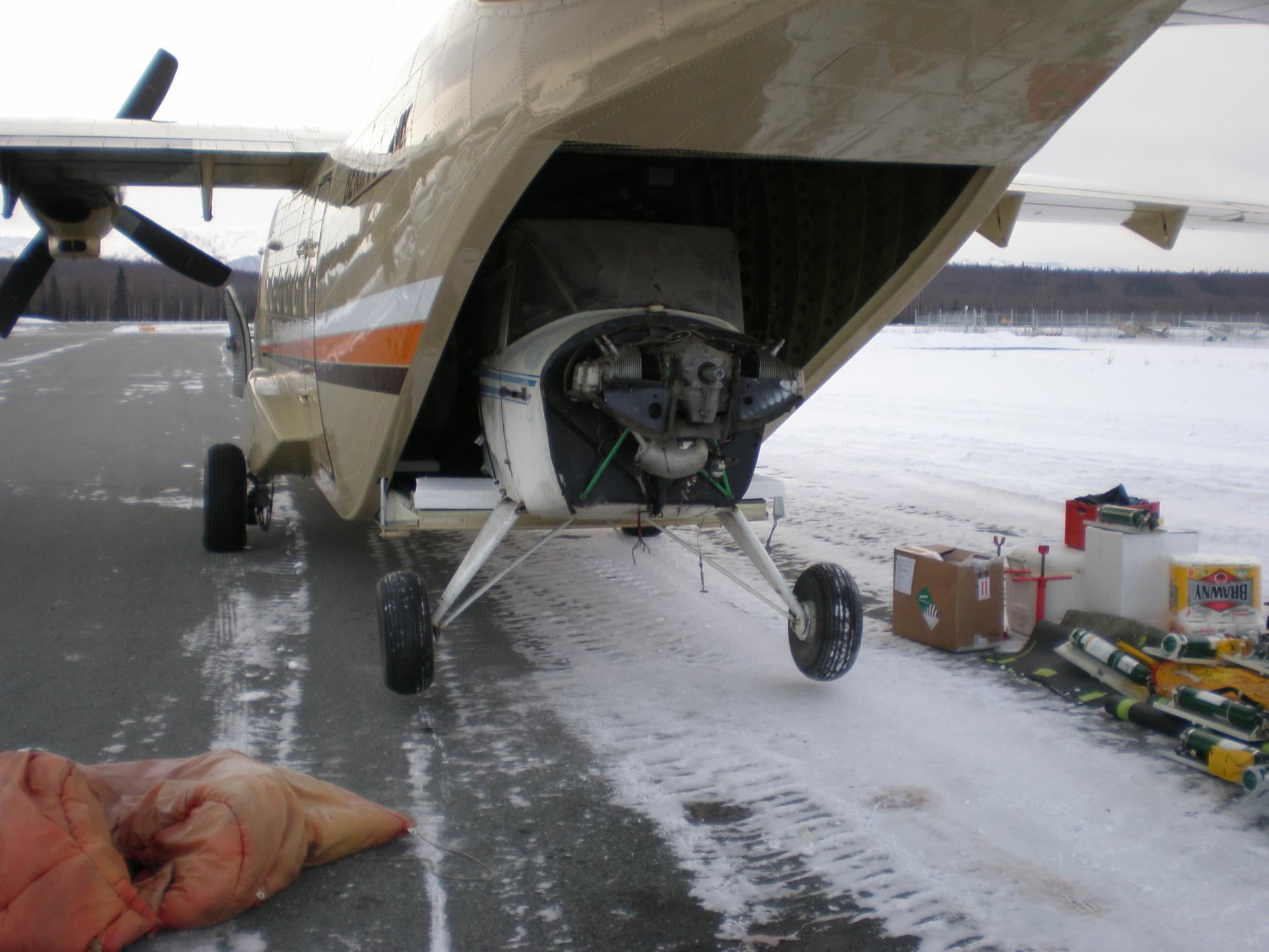

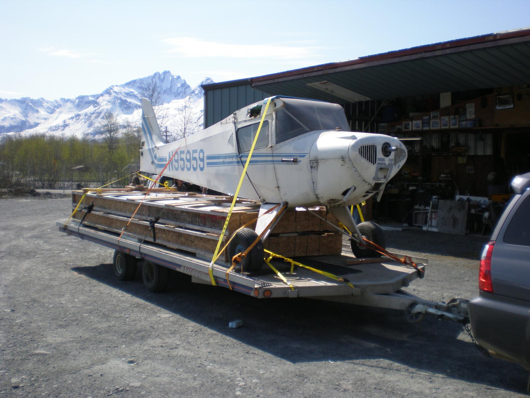

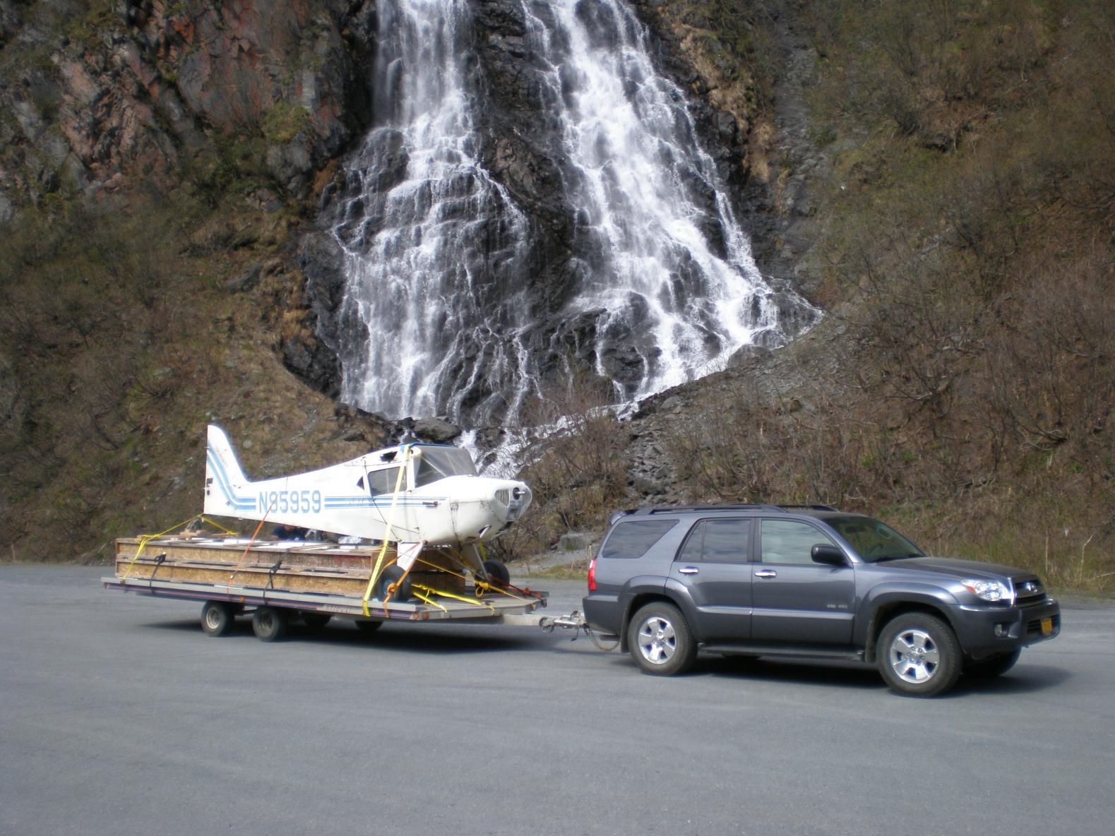

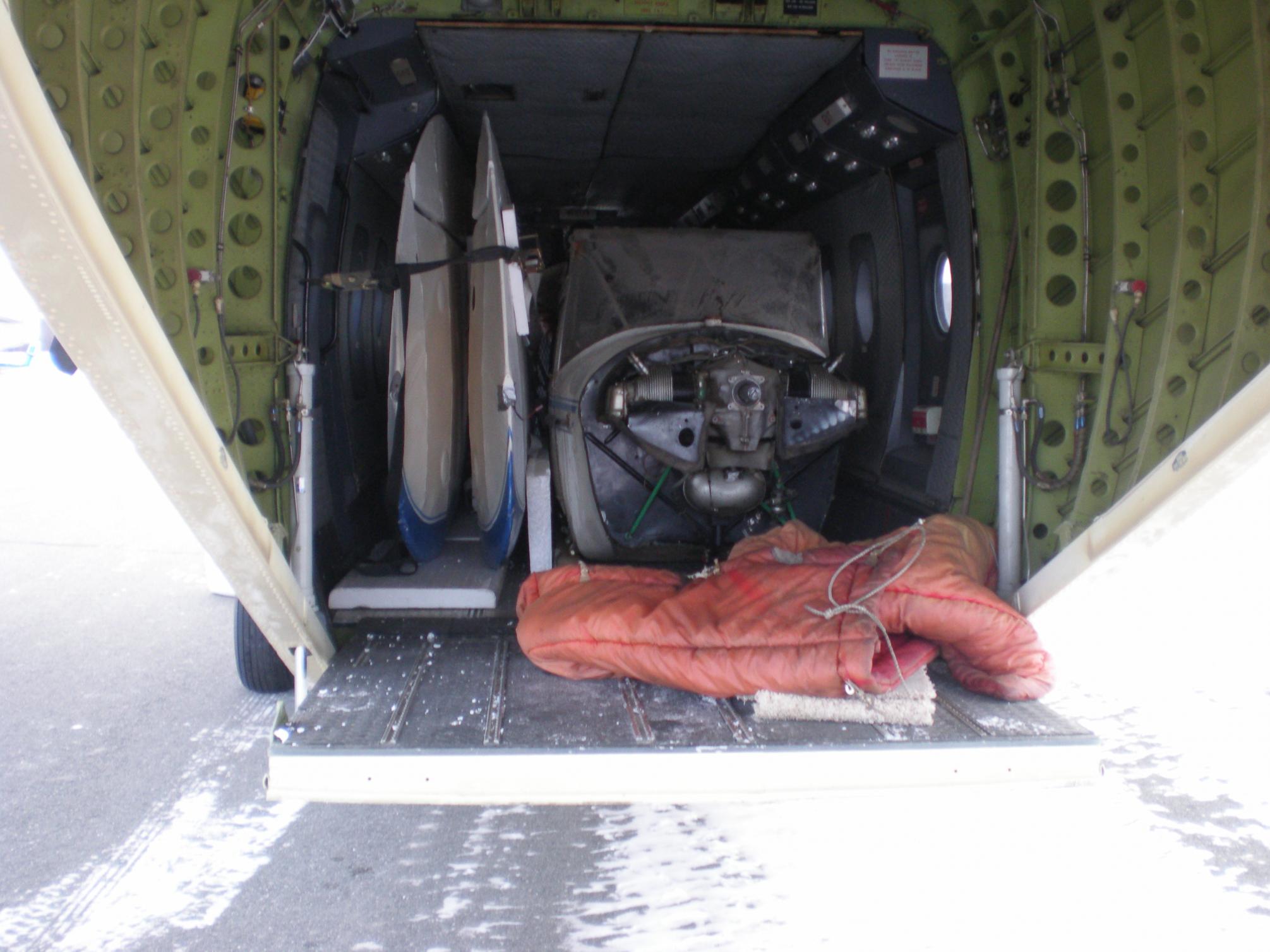

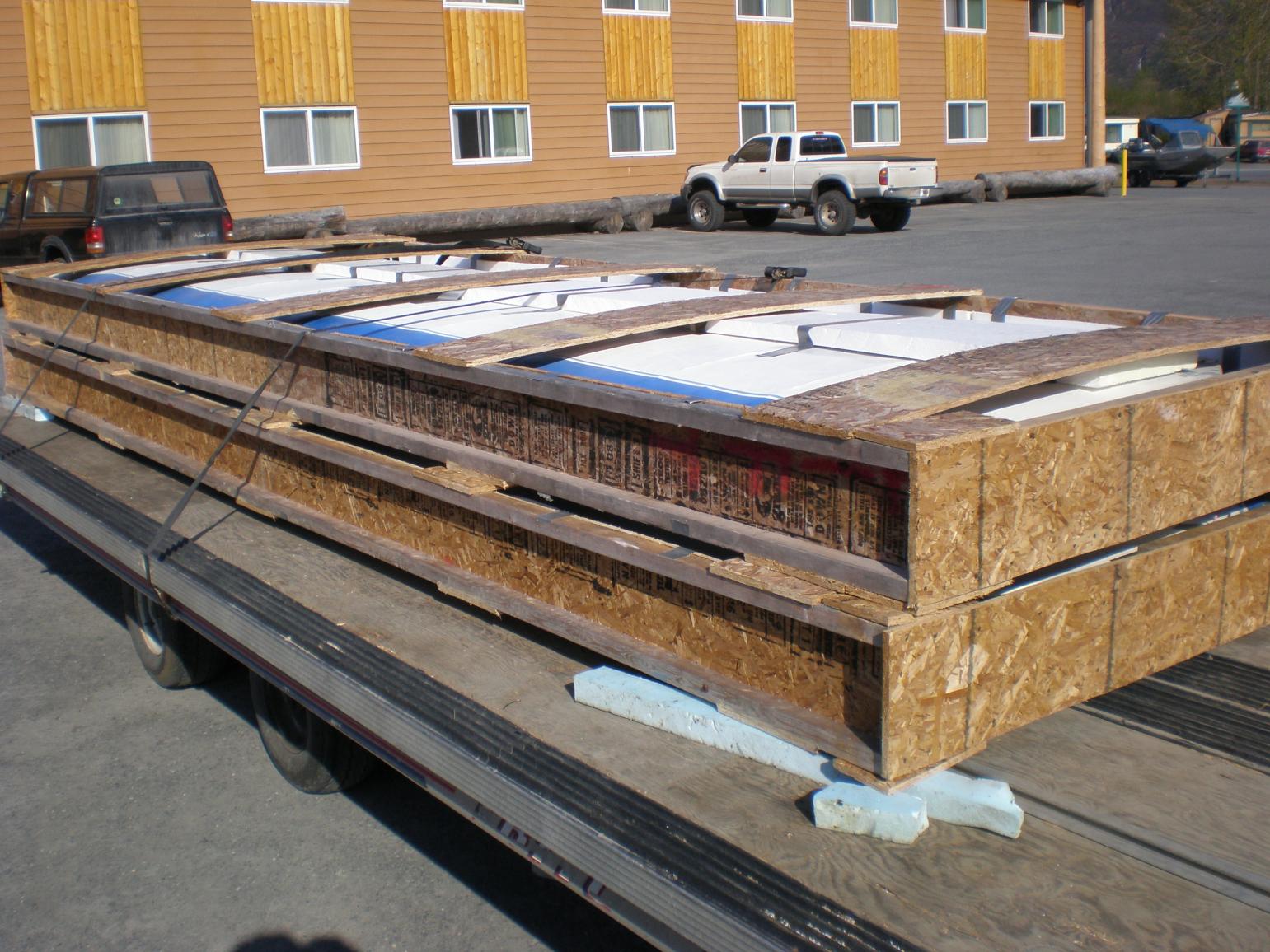

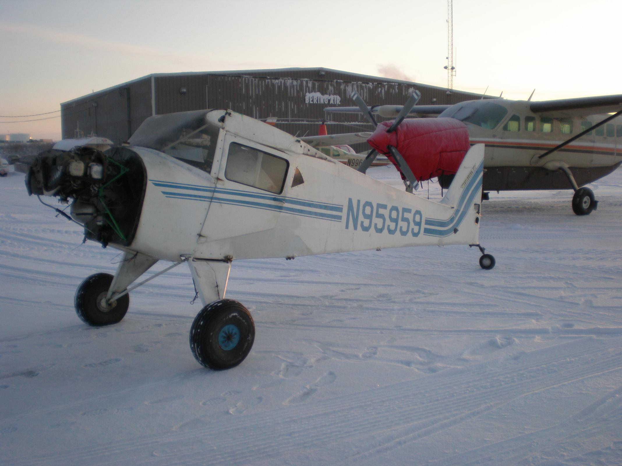

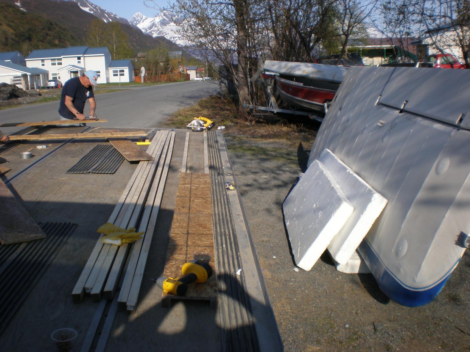

Pictures of transporting my Tcraft "Miss Valdez" from Valdez AK to Nome AK.
