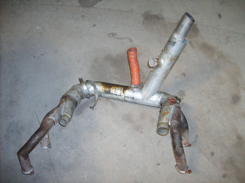

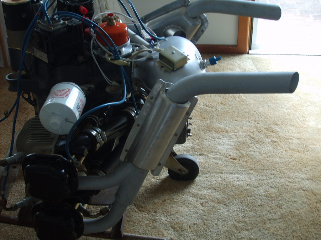

          Re: C85 Engine up grade on n26658

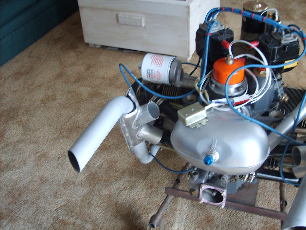

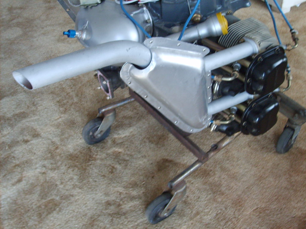

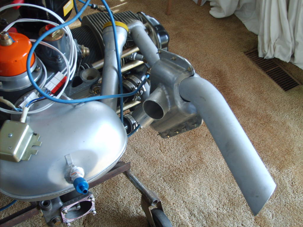

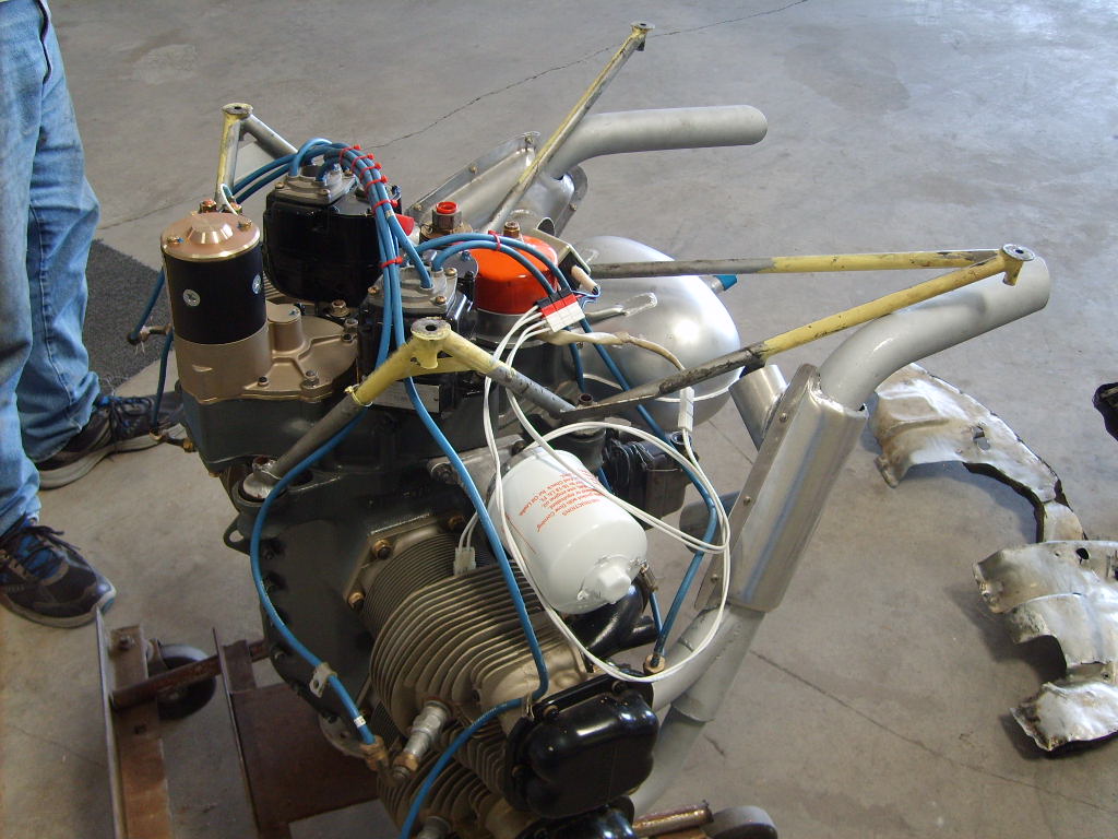

          well the new exhaust got here this morning and i put it on the engine it looks much better then the stock one
          1940 BLT/BC65 N26658 SER#2000

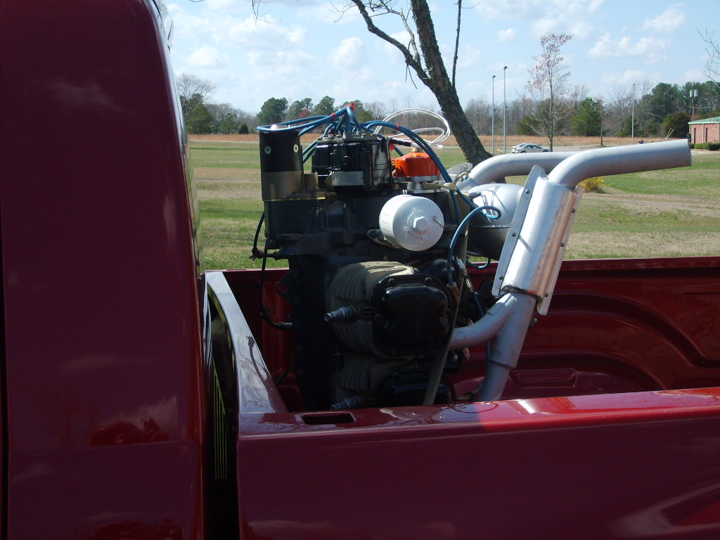

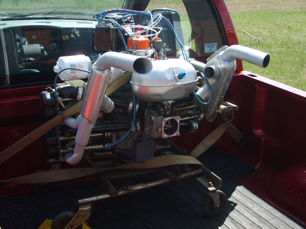

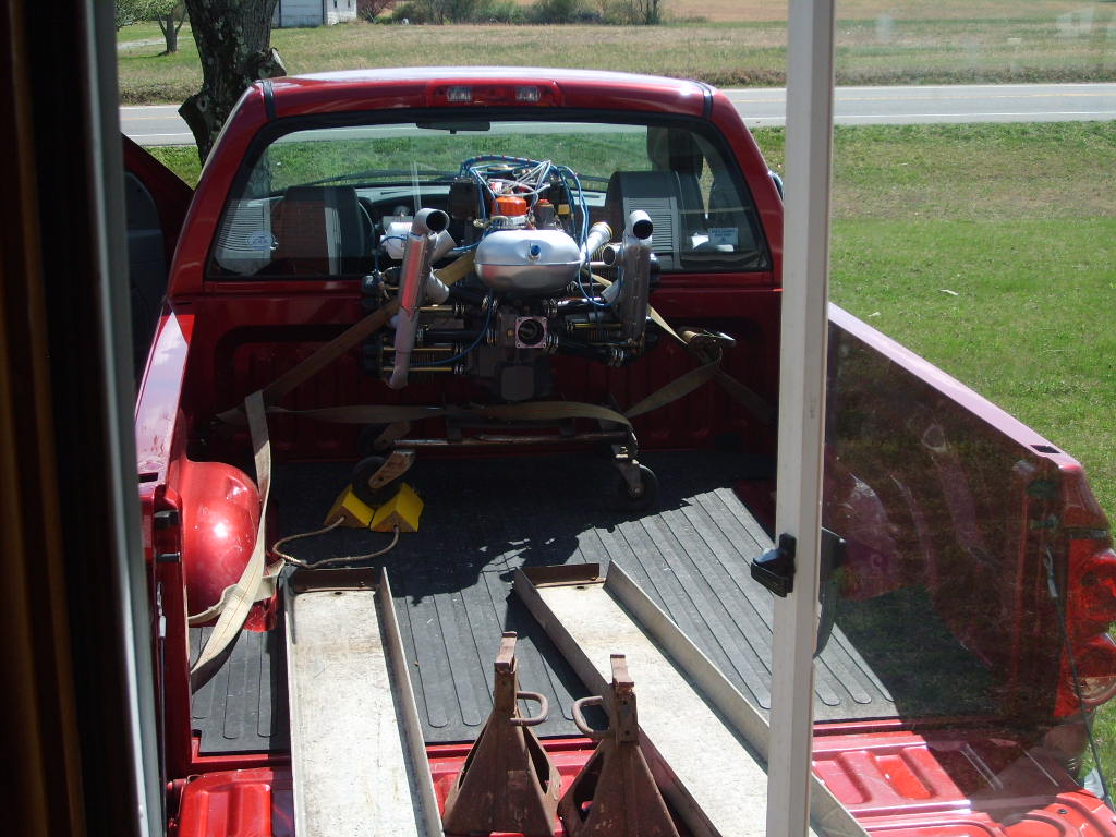

              talked to IA and its a go for tomorrow so its not in the living room no more its in pickup and will head to shop tomorrow am
                Lookin' good!! So that's what fresh parts look like!

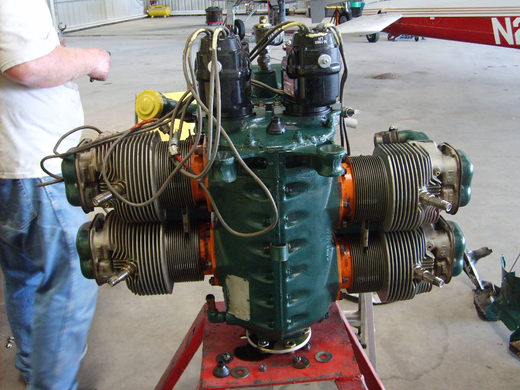

                  John not to shabby i am very happy how it turned out will start to install it in the morning

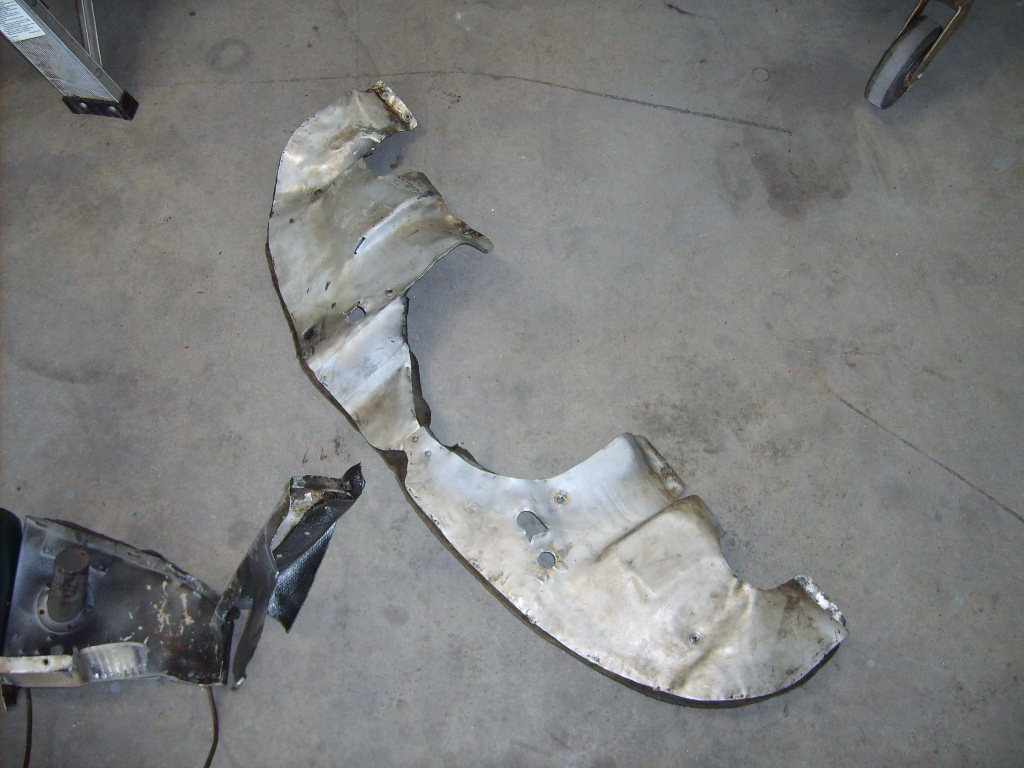

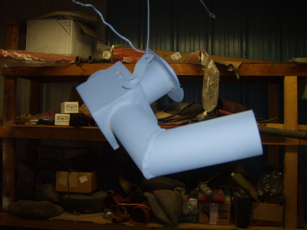

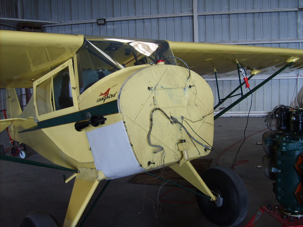

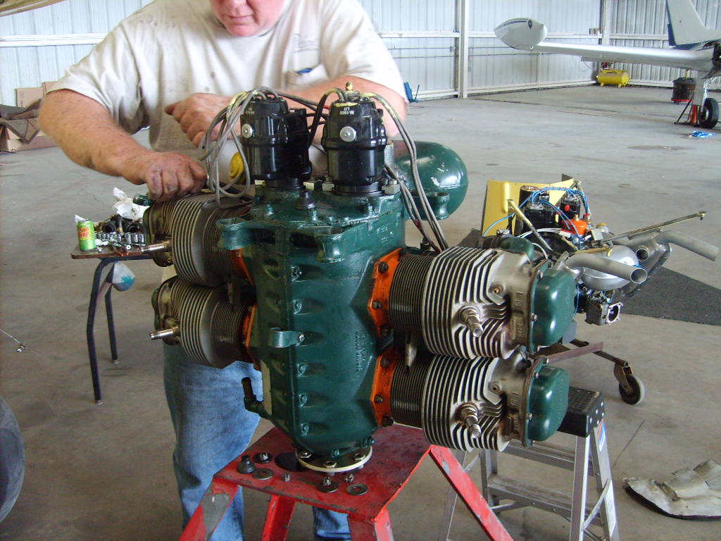

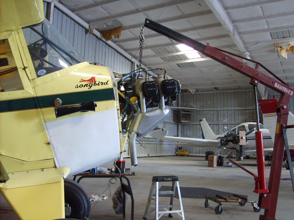

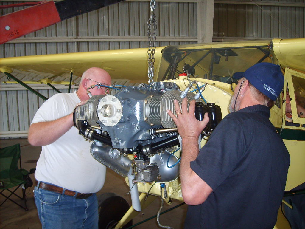

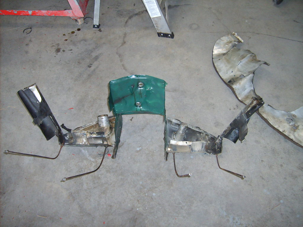

                    well here is what happened today moved the plane 20 mi east to kmrc Maury co air port and started the switch over to c85 was going to use old baffles but after looking the new baffles are on the way from alaska ordered from the same company that rod hanson got his from tomorrow will start by bead blasting motor mount and checking for cracks and will do test fit on plane to check for fit on fire wall and start on electrical also will repaint the fire wall

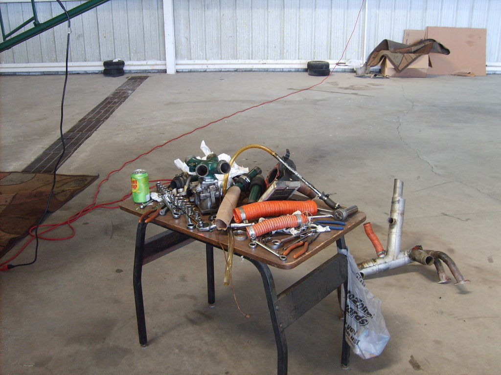

                      more photos
                      • #26

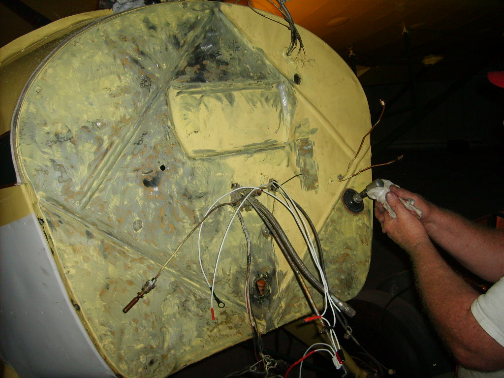

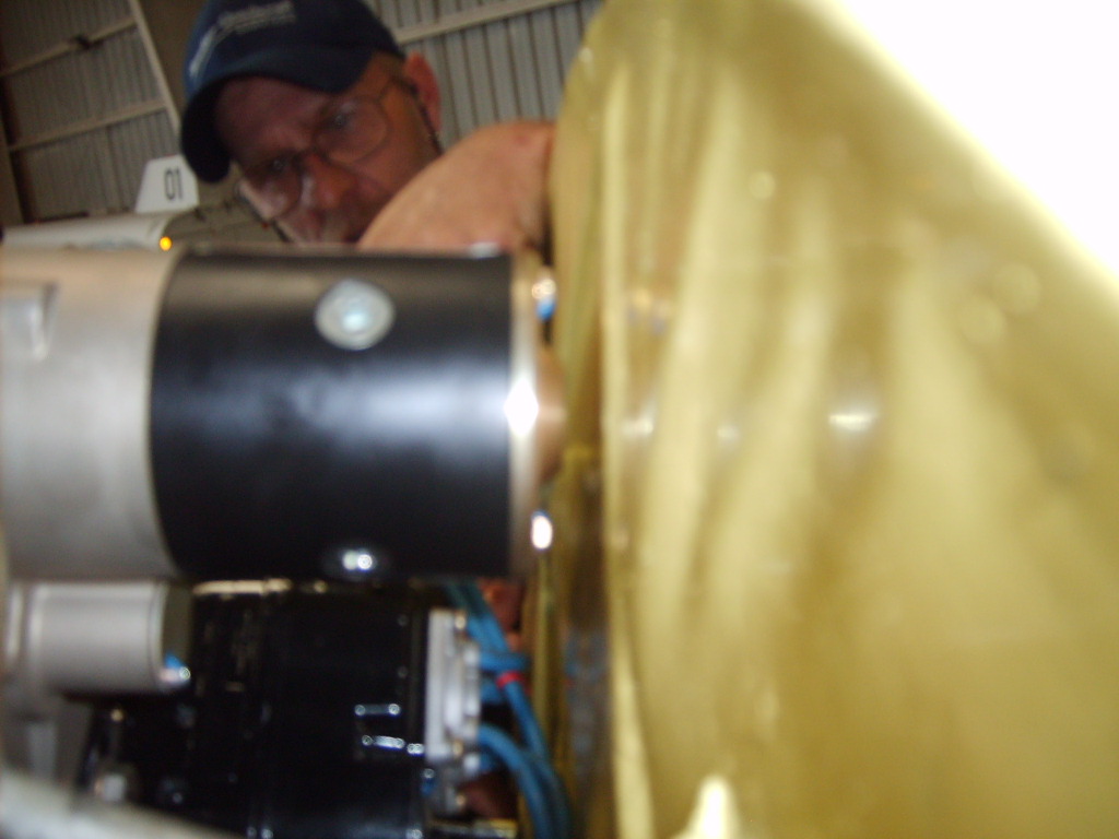

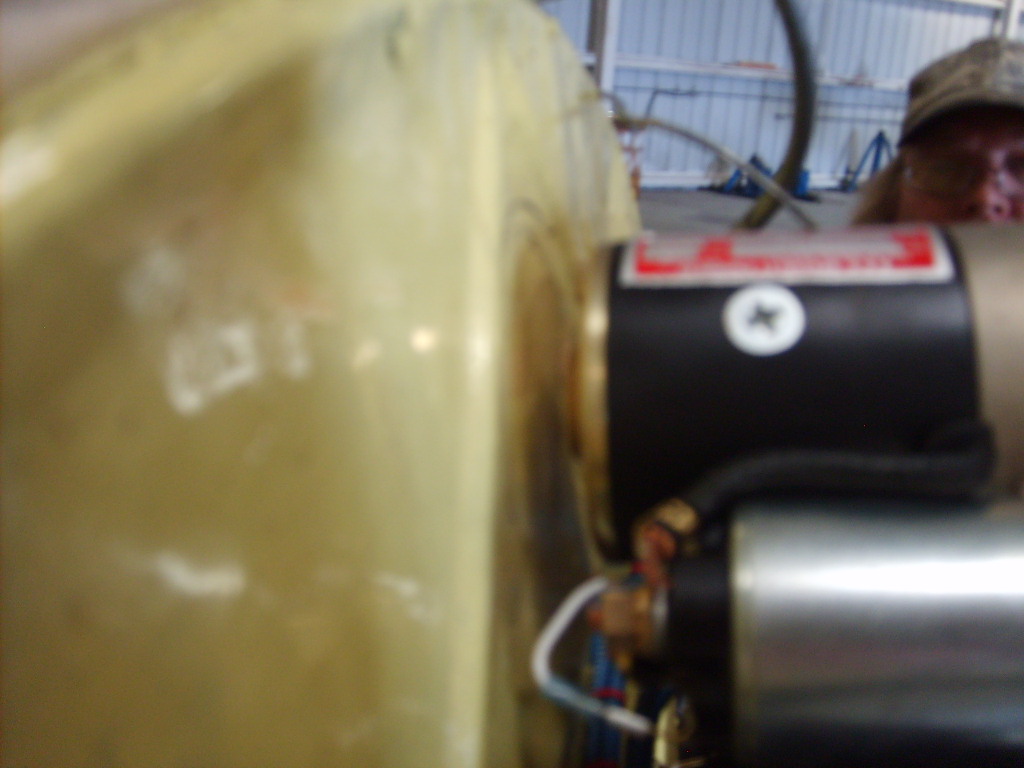

                        well we had a grate day the new engine fit with a starter and alternator on a short mount with about 5/8 of a inch

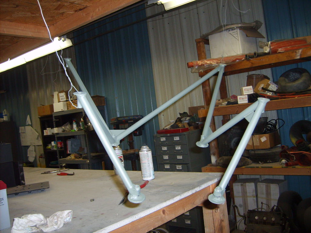

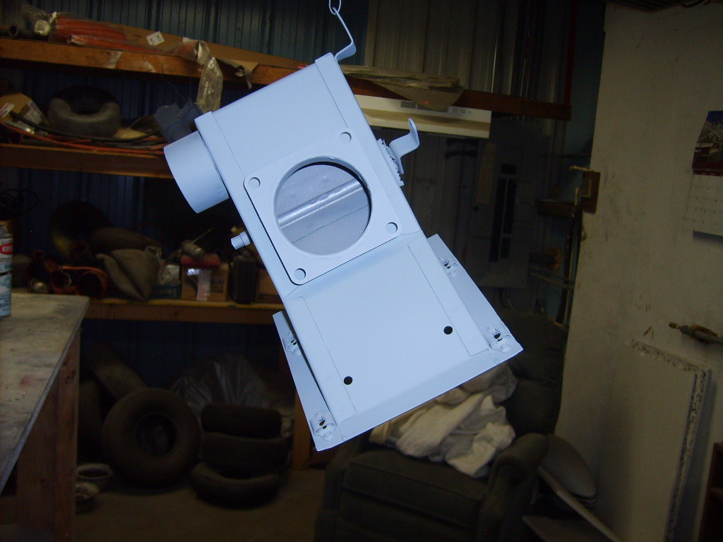

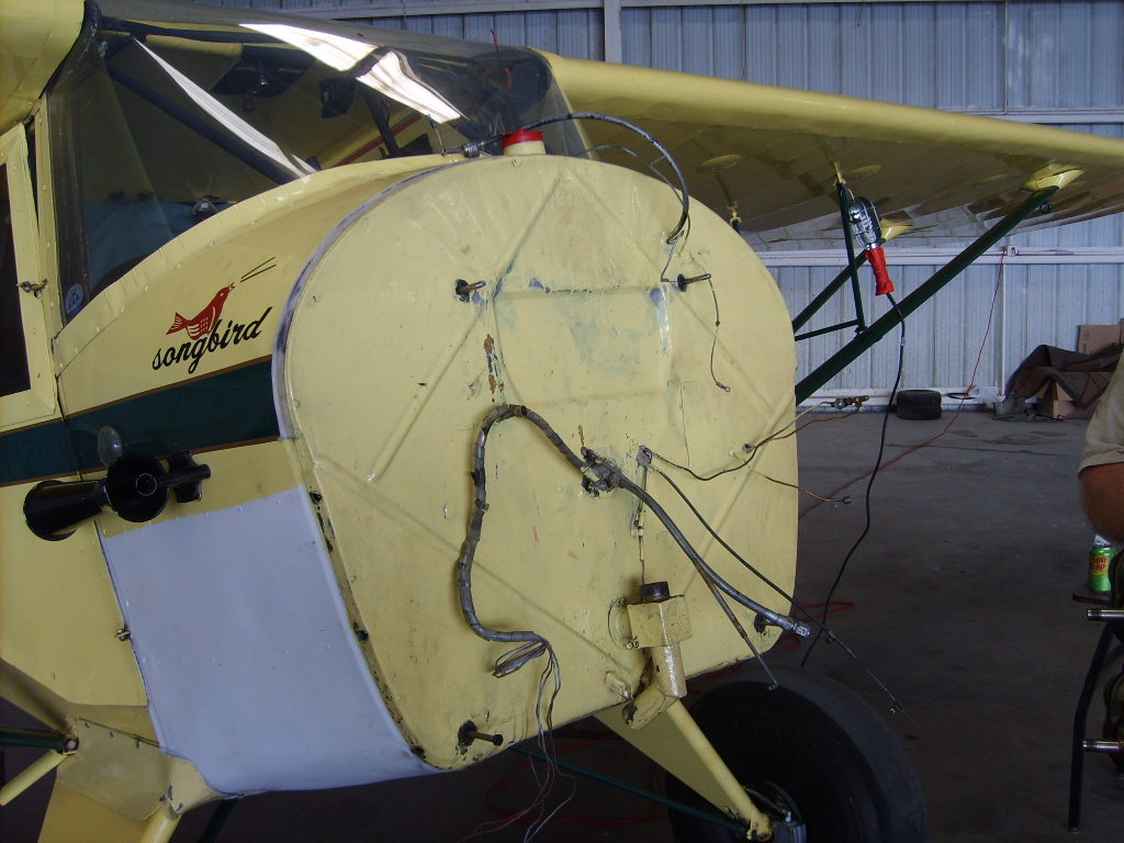

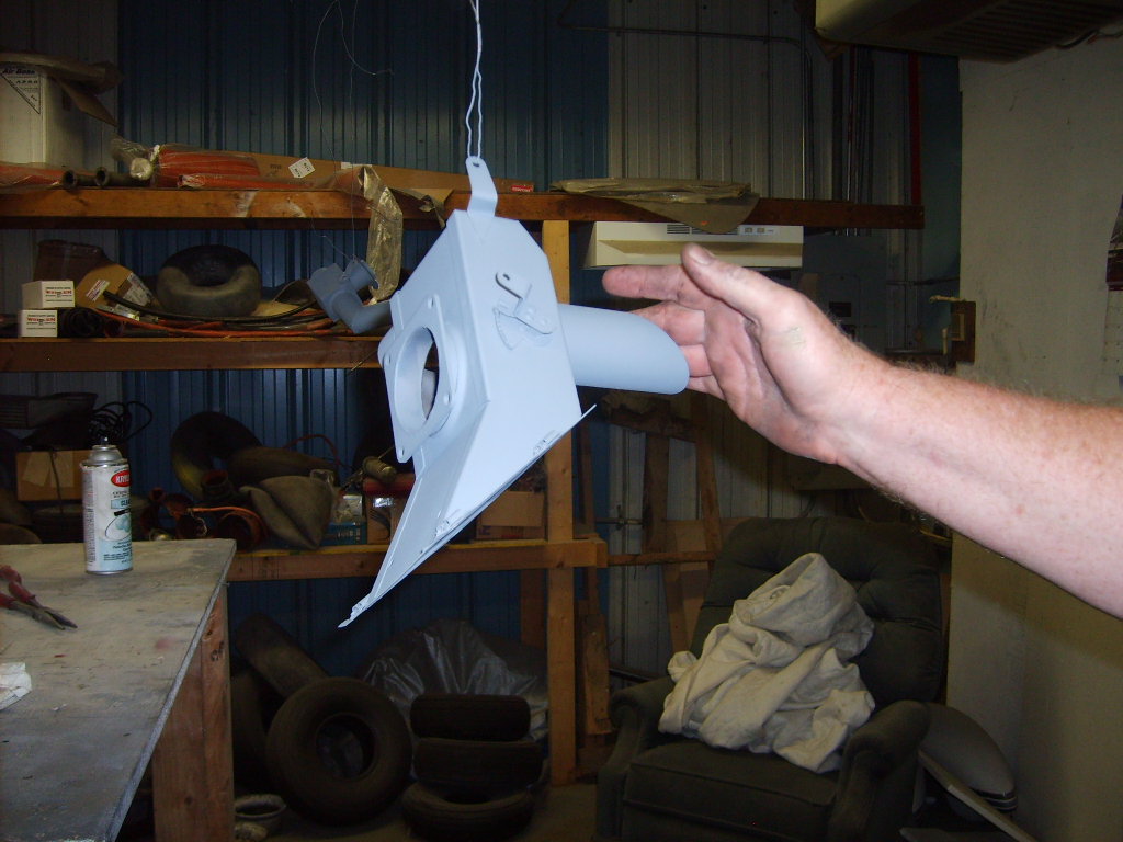

                          here are more of todays work painting air box heater and motor mount and working on the fire wall and electrical system

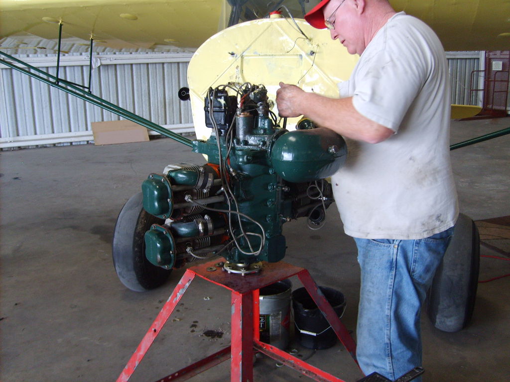

                              John that photo was very early in the morning and its a big hanger today finish painting and hang engine for good waiting on new baffles more photos tonight
