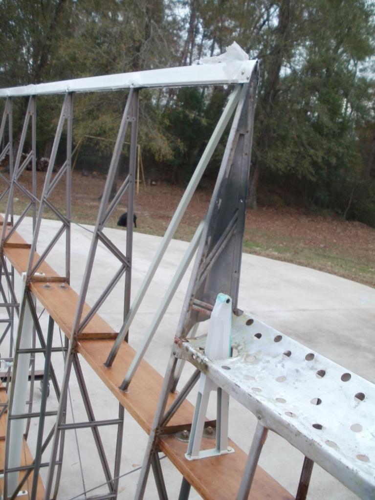

Ugly looking spars
I need two aileron bay ribs, tip rib, butt rib, and a new leading edge. I am still trying to pick my jaw off the floor after seeing what univair wants for a butt rib kit
I'm hoping the new spars will be here next week so I can start building them up.
Hopefully you can see what's going on with these crappy cell phone pictures. I'd buy a nicer camera but that would infringe on my airplane budget
