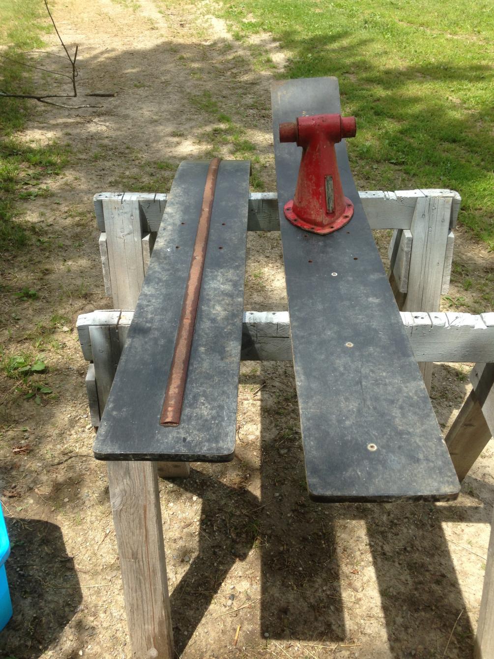

                      Thank You, Gary & M Jones, I think it'll be awhile. I was cleaning the Hangar (40' semi storage trailer) today while setting up wing racks and noticed that the skis have four holes roughly in a square for attaching stanchion to landing gear while "Heath" landing gear "stanchion adapter" for lack of proper terminology attaching to gear axle, it's holes are in a tear drop configuration which don't line up. And I have no attaching hardware. But I am getting a good idea of what I have to work with. Clark

                        How's about some good pictures of the project skis? I take them and put on my iMac desktop (JPEG's I guess). Then use the "Go Advanced" feature available when posting and download them to the post. There's limits on size noted somewhere here.
                        It might be good for the Taylorcraft record and make for a more meaningful discussion. Some of us will never see Heath skis otherwise.

                            Skis
                            52" Long
                            7 5/8 wide
                            Rectangular hole is: 2 1/16" from either edge
                            3 19/32" wide center to center
                            4 1/4" long
                            [IMG]Jpeg[/IMG] Will add photos, once I figure out how to do it.
