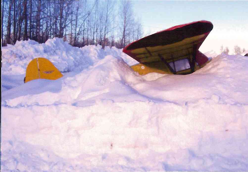

    "Grandpa, when are you takin' this thing off floats?"
    "Don't worry Grandson, I've got plenty of time before it snows..." (I got off floats last week).
    "At least the days are getting longer..."
    "Grandpa...let's go flying".

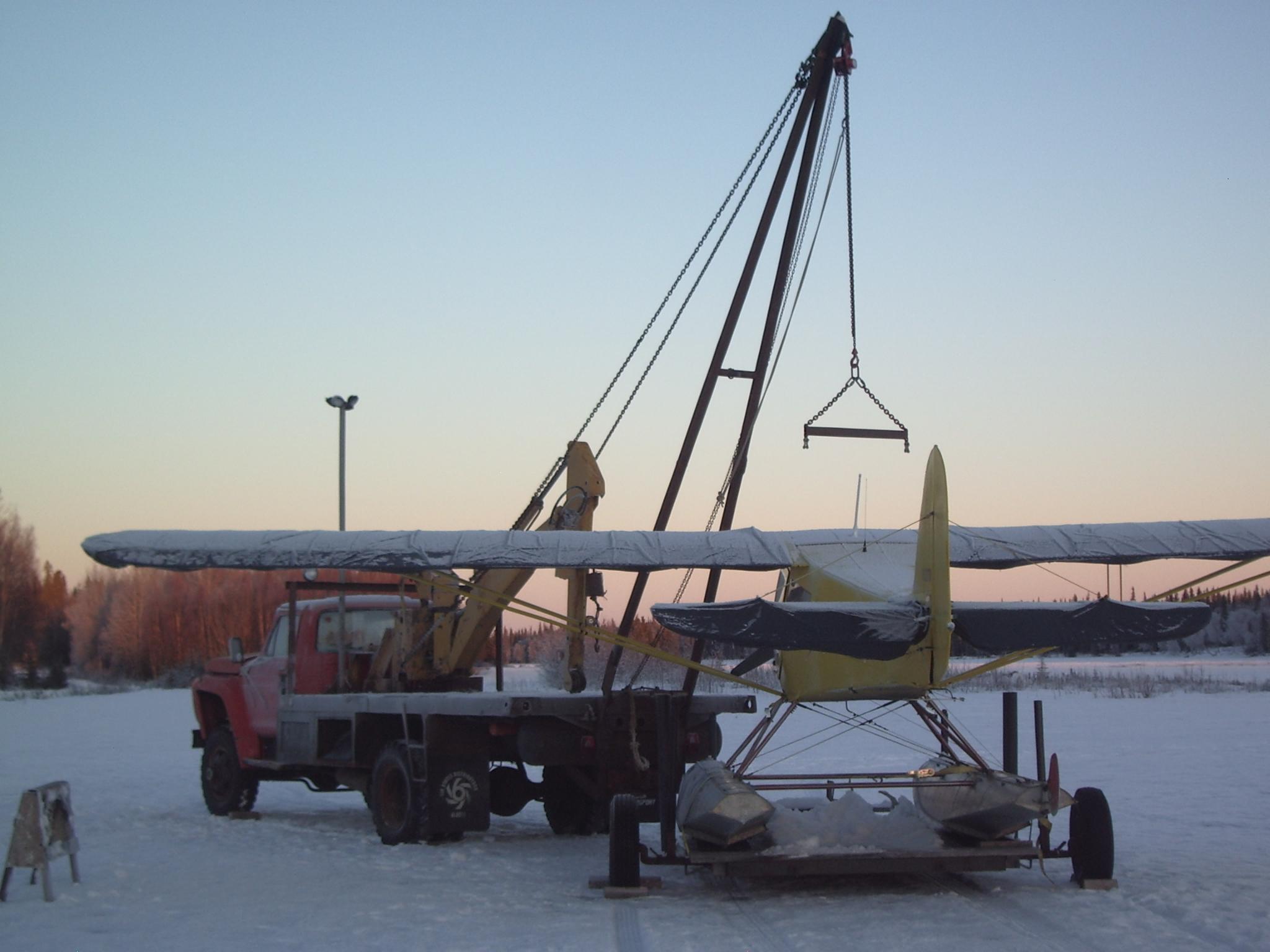

      I just "hangar" it from my skyhook! (for new Airframes Alaska sealed struts)or(float swap to wheels or skis) Sometimes you just "hangar" on to the end of a scoop shovel and then go flying. The plane sneaks into a hangar for annuals.

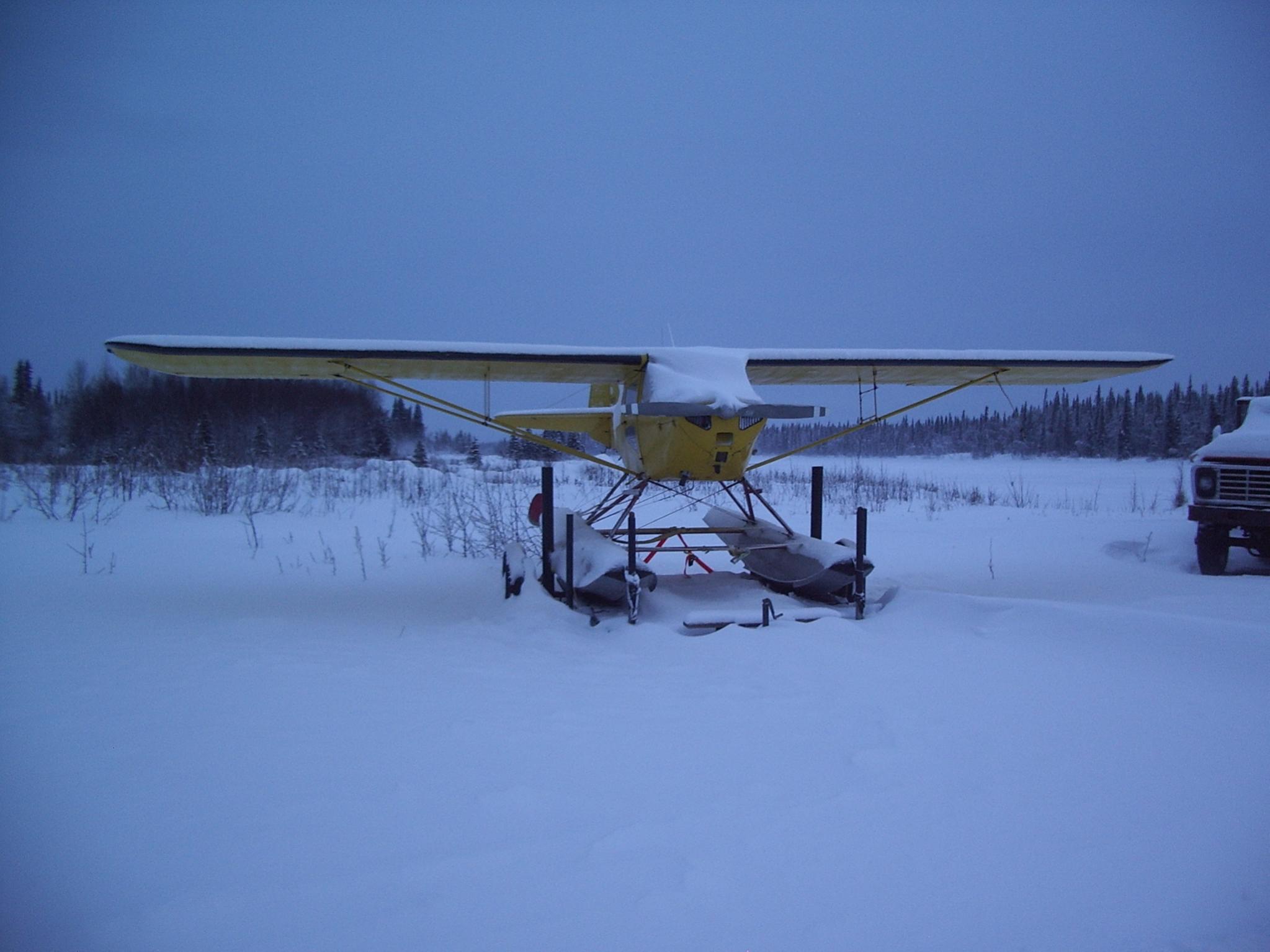

                    Most people in Alaska don't put their planes in hangars, mine lives outside and I have a hangar, I put it in the night before I fly to warm it up. The heat of the day today was -10 and that's when I took this picture.

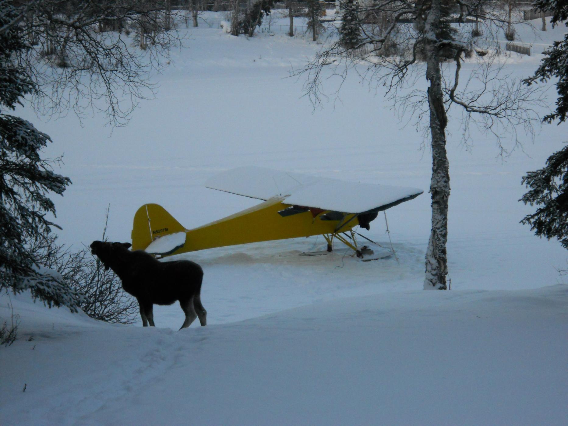

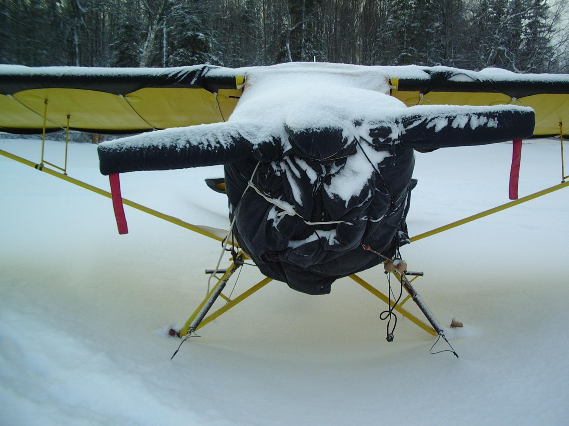

                      Ray, as wlas (Larry) says, most of the planes up here experience the "elements".
                      I would love to have a hangar...often sketch up my ideas using ship's containers coupled with home-made wooden trusses. For now, the plane is tied down on the ice in front of the house. I have a good set of wing, horizontal tail and windshield covers. Coupled with a really good engine cover and a heater/fan/thermostat setup, the engine compartment is held at about 65 Deg. F. (Above the dewpoint and dry as a bone).
                      The main thing I worry about is damage caused by snow removal. I prefer to do it myself, even if help is available. You may cause a few minor dings before you learn just how to do it. It takes a gentle touch and you can't get in a big hurry. I have a couple of snow rakes that I rigged up that work well, plus I found a Walmart snow rake that is made of some type of soft, red foam rubber...has a collapsible handle. I like it.
                      One other thing about the way I do it here is that the fire hazard is my own worry.
                      I'm not in someone's hangar or next to someone else's airplane. I try to be very careful in placing the heater properly inside the cowling. The thermostat is a commercial- grade unit used for oilfired space heaters. The electrical cord is buried beneath the snow, to avoid snowmachine traffic.
                      Also, I don't have a mouse problem!! Do have a few moose, but so far they have left me alone.
                      Probably the best part of the situation is that I have visual connection with the plane. I can shine a spot light on it when the hard winds are blowing during the night. And it just feels good when I stand at the window in the morning with the first cup of coffee and see the old gal...tied down, waiting...ready. She's owned me since 1975 or so.

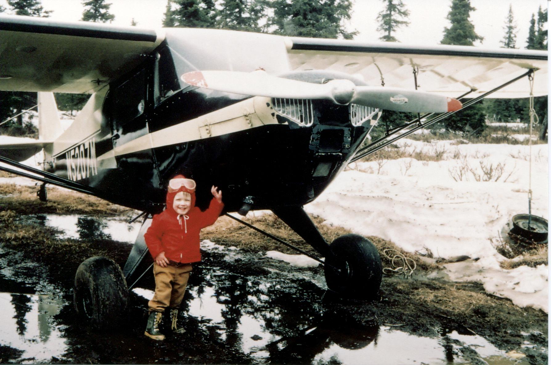

                        This is "Zero 7 Mike" not long after she "bought" me...The kid is my eldest son...We jokingly called him "Mudhole Smith", after one of the famous Alaskan pilots. The kid now flies for a living here in AK. Man, the time passes quickly...! You can see that this was before the days of beefed-up gear. Also evident are the remnants of tape residue used to control engine heat.

                          Dick..that's pretty cool , I put duct tape over nose bowl just so I can get some kind of oil temp, and take it off as the weather warms up. If I ever get down to north Kenai I'll have to stop in.
