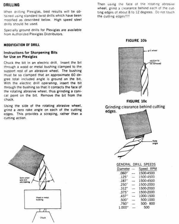

      Yes, you do need to drill holes, but you can modify some standard drill bite yourself, I will dig out the info, else you can indeed buy the "proper" bits from the supplier.

        It has been said, but I'd like to stress, at the risk of repeating, do NOT use standard twist drill bits, warm weather or cold! They are cut to pull themselves into the drilled hole, and can and will crack the plexiglass. I used to grind away the undercut of the drill tip's flutes, so that it only was "scraping" its way through, not cutting into the material; this is no problem, as the plexiglass heats up with the friction (good), and it easily soon scrapes through. The rest of the advice is good, that is to use the old windshield as a guide to make a template, and a Dremel-type tool works well for cutting to size. Cut oversize, and slowly work towards final dimension, cutting and fitting as you go.

              Page 1 of plexiglass bumph...
                ...and page 2.
                Or go to www.taylorcraft.org.uk/plexiglass5.jpg (131 Kbytes) for a single-view version of the same.

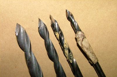

                  Here's what the drill bits look like. The changes to the cutting edge profile causes the bit to scrape the plexiglass away, rather than cutting into it. Test on a scrap piece first.
