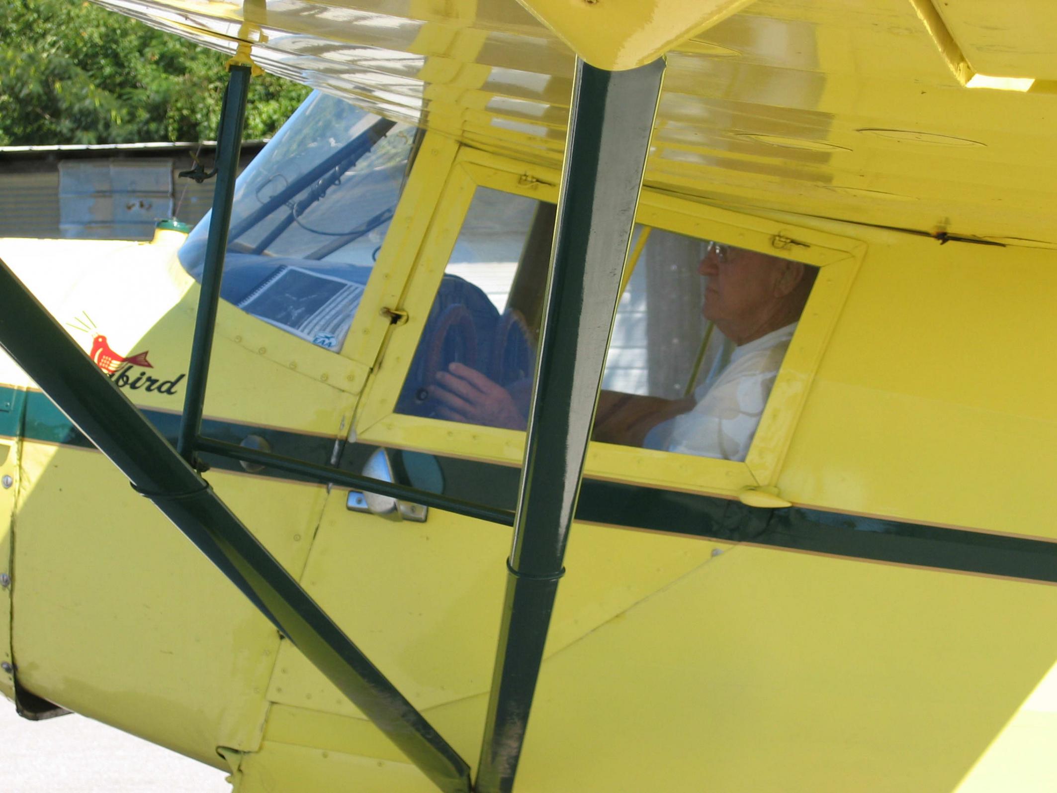

    Hello Tribe,
    I am trying to find an over center window latch for my window. The one latch i have looks original, But I am unsure if the windows in a 1941 BC-12 even opened when the plane was manufactured or if it was added latter. I guess any thoughts on how to secure the window open/closed would help. Or if anyone has a latch kicking around they would like to sell...
    Thanks
    -Levi
    Re: BC-12 Window Latch
    In 41 they opened out with a hinge at the top and an over center latch on the bottom made from metal (on the wood and the tube doors). They are fairly simple and you could bend one up from sheet metal and a vice in a couple of hours. If you are redoing the windows from a 41 check the wood door frames really well. The pieces of wood can break at the glue joints and the fastener holes will have worn over time. I rebuilt my wood doors and re-glued all of the joints and added strips of carbon fiber between the wood and the ply skins. Added almost no weight but made the doors a LOT stronger. I also re did all of the screw holes and put in "T" nuts so I could use machine screws instead of wood screws. You don't want to open the window and have it rip off in the slip stream, or worse yet have the hinge screws tear out and blow the door off.
    If you have the tube doors, they use the same latch but the weak wood isn't a problem. All welds, screws and nuts on my 45. Really solid doors and very light. I think the wood doors "feel" better and sound much better when you close them and in flight, but then, I always liked wood.
    If you need a pattern for the latch let me know.
      The doors are welded tube. I could bend up a new latch using the original as a pattern, I like the idea of a latch that props the window open when it is hot out in the summer.
      Levi
        I have flown the "sliders" and as far as I can see he flip up ones are better in every way except sticking your arm out. I wish there was a way to release the folding over center mechanism completely without having to take it apart since it would be nice to fold the window all the way up against the bottom of the wing. Yea, I know you just have to take the knob/bolt out, but then you can't latch it shut and the little washers tend to get lost.
        Another thing I did was to put a little felt pad on the latch so it doesn't bang on the plexi and scratch it. Quick and easy.
          My 41's doors are welded tube with aluminum skin and the fold out latch. If you need a pattern I could make one up as my doors are off standing up against the wall. L

                      Hank my doors have the flip out windows the door is the tube door the windows have hitch pins threw the hinges and the center of the flip out latch pull the pins and put the window in baggage and fly on
