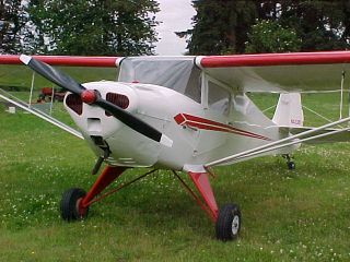

    That is one pretty airplane. Of course I am partial because mine looks almost the same. It is only few numbers away from yours, N43381.

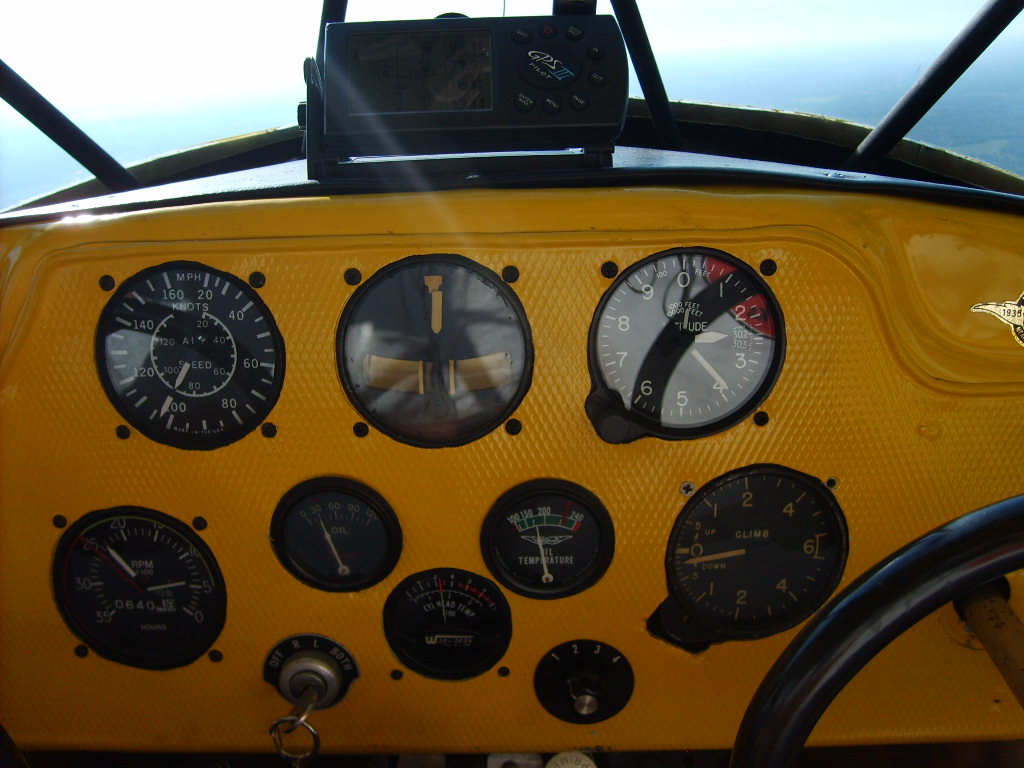

          First off what are you using for a comparison to come up with the 11 mph a GPS if so leave your tack alone and talk to instrument repair shop about how to calibrate it. and welcome to the tribe nice bird . looked at the photo of your panel and my plane shows about the same speed and rpm at cruse 2200 to 2250 about 100 mph with 74/43 prop and bush wheels and that is same as GPS on top of panel

              It sounds as if you have the same problem of the same magnitude as all three of my planes, but you say that it doesn't change if you pull the static line off. From your photo of RPM vs Airspeed I think your airspeed indicator and your tachometer are OK. The readings are almost Identical to mine. I'll bet it is the static pressure.

                    WOW....Thanks to all that responded....... I normally cruise @ 2,150 RPM and my GPS (set to MPH) shows that I average about 93 MPH. // Below 2,500 feet // on a No wind morning. Factoring in the winds aloft, the true speed seems to work out between 90 and 94 MPH. A normal stall comes at about 51 MPH indicated. cruise speed is about 104-105 indicated. So it seems to indicate 10-12 MPH fast across the board. When my Tach is showing 2,100 RPM (a thumb tach reads 2,110) so the tach is pretty close at cruise. I will try to post a couple of pictures of the plumbing (pitot and static line out on the wing strut.) I am thinking I will do a low pressure test on the pitot line and the static line....(when disconnected from the ASI) and look for leaks. I never remember to look at the outside plumbing when I see another Taylorcraft on the ground......Always remember that after I have left..(I have never seen a static tube just bent back under the wing like mine is on ANY aircraft...(is this normal on the T-craft ??)..........Thanks again everyone...........Don in SC
