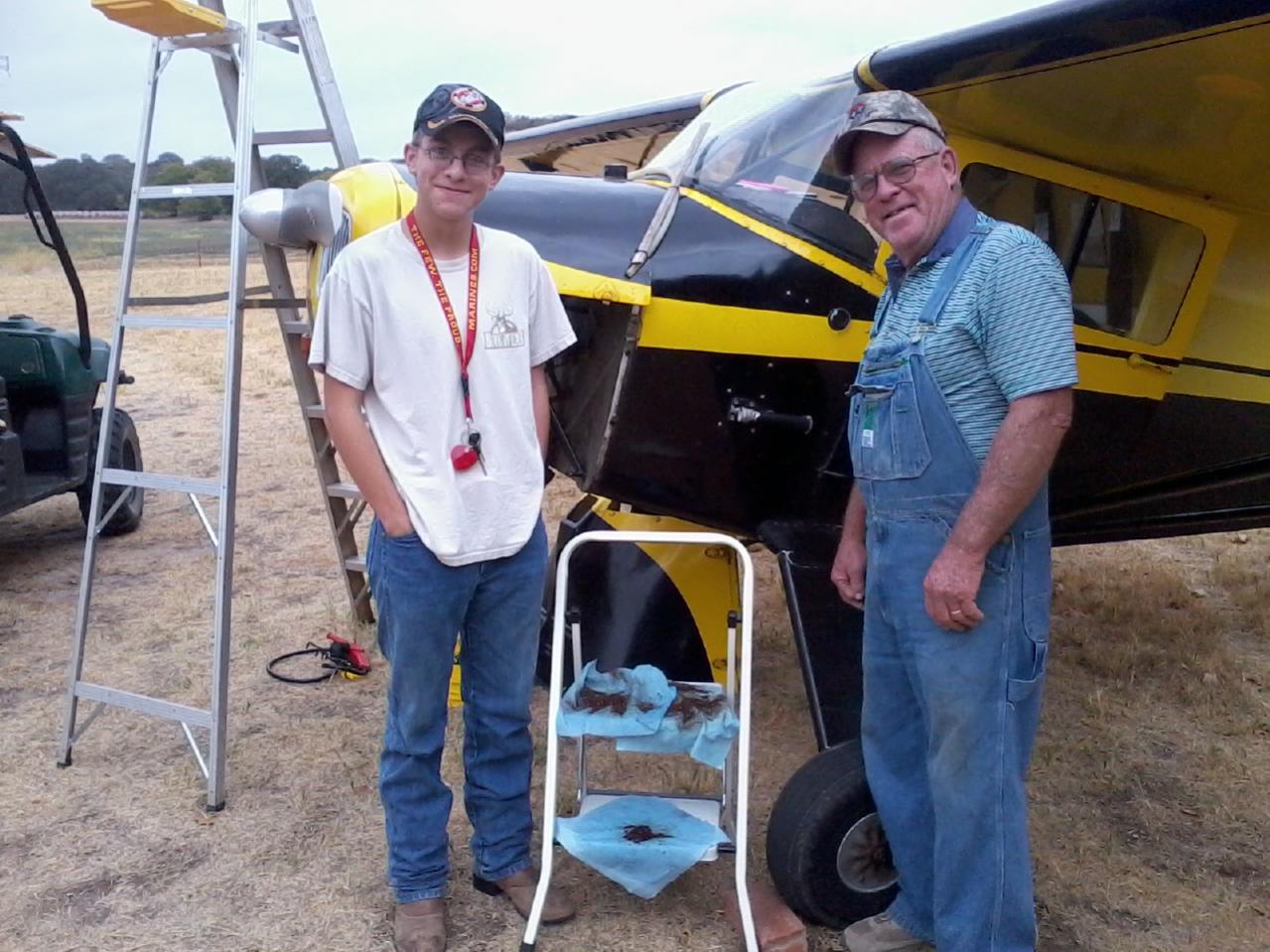

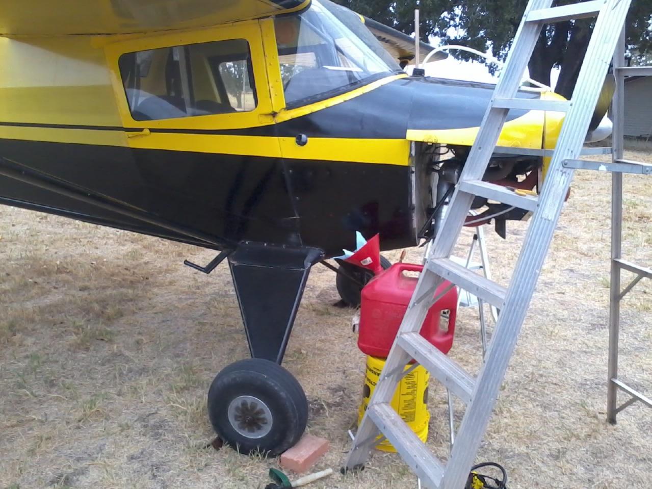

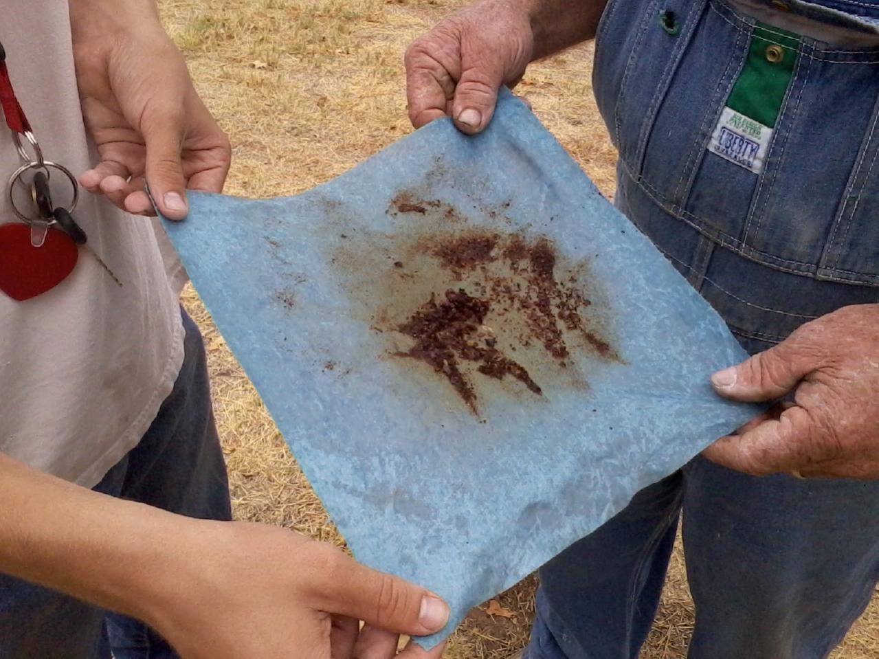

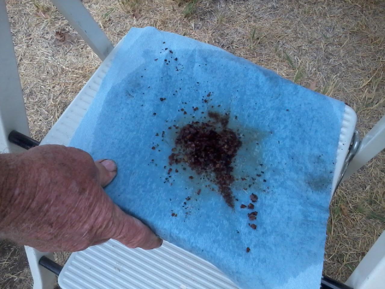

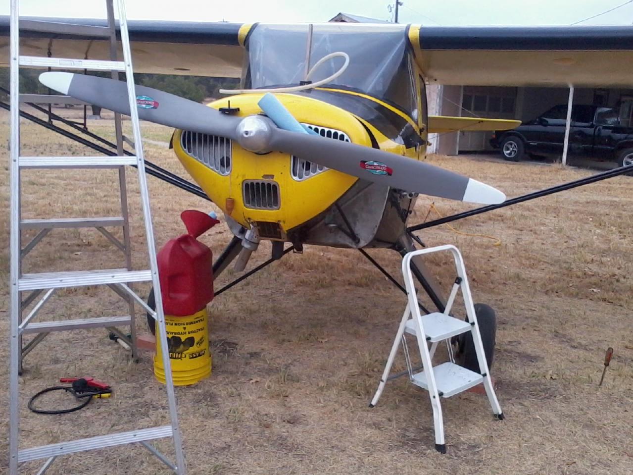

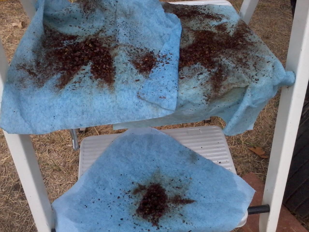

    It is hard to describe the feelings of surprise, relief, and bewilderment yesterday when we found out what an awful mess has been lurking inside my main fuel tank. To me... this is enough to cause me to NEVER use mogas ever again in an airplane. I guess that its ok if you fly regularly, but here's what can happen if you let mogas stagnate and set in your fuel tanks. This discovery yesterday came as a surprise because we recently thoroughly cleaned and flushed out the fuel tank during annual inspection. Since the annual, I have flown exclusively with avgas for around 8 hours with no hint of a fuel contamination problem. And I check and drain the gascolator before each flight. There has not even been one speck drained out on any flight. Same went for yesterday's pre-flight. I might have continued with this major problem unknowingly had I not made a unusual decision yesterday.
    I was about to make an hour-long flight and I was debating about whether to plan a stop for fuel. The fuel float indicator was showing maybe a little less than half (I was thinking maybe 5 or 6 gallons). So I asked Lon (my father in law) to borrow the dipstick he has for his '39 tcraft. (This was the unusual decision.) It is a wood stick with a notch at every 2 gallon increment. So I dropped it down to the bottom of the tank to check the quantity. As the stick contacted the tank bottom, there was a distinct feeling that there was something else in the tank besides fuel. It felt like a layer of salt or sand... maybe a half inch deep laying in the bottom. Needless to say, I decided not to fly.
    Lon and Travis helped me figure out what to do. We decided to rig up a siphon tube and see if we could vacuum it out. It worked... and the results were almost unbelievable. We rigged the siphon tube with a rigid stick so it could be moved around along the bottom surfaces of the tank. After draining the entire 5 gallon contents out, we had caught three shop-towels full of these brown varnish flakes. It became obvious that this stuff was collecting around the finger strainer but was not passing through in normal operation. We poured in another 5 gallons of filtered avgas and repeated the process twice more and caught even more junk. These pictures show the results.
    I am so glad to have found this an corrected it before something bad happened. I recommend that everyone should check out their tanks especially if they have ever sat for a period of time with mogas. Don't assume the tank is clean just because you have a clean gascolator screen.

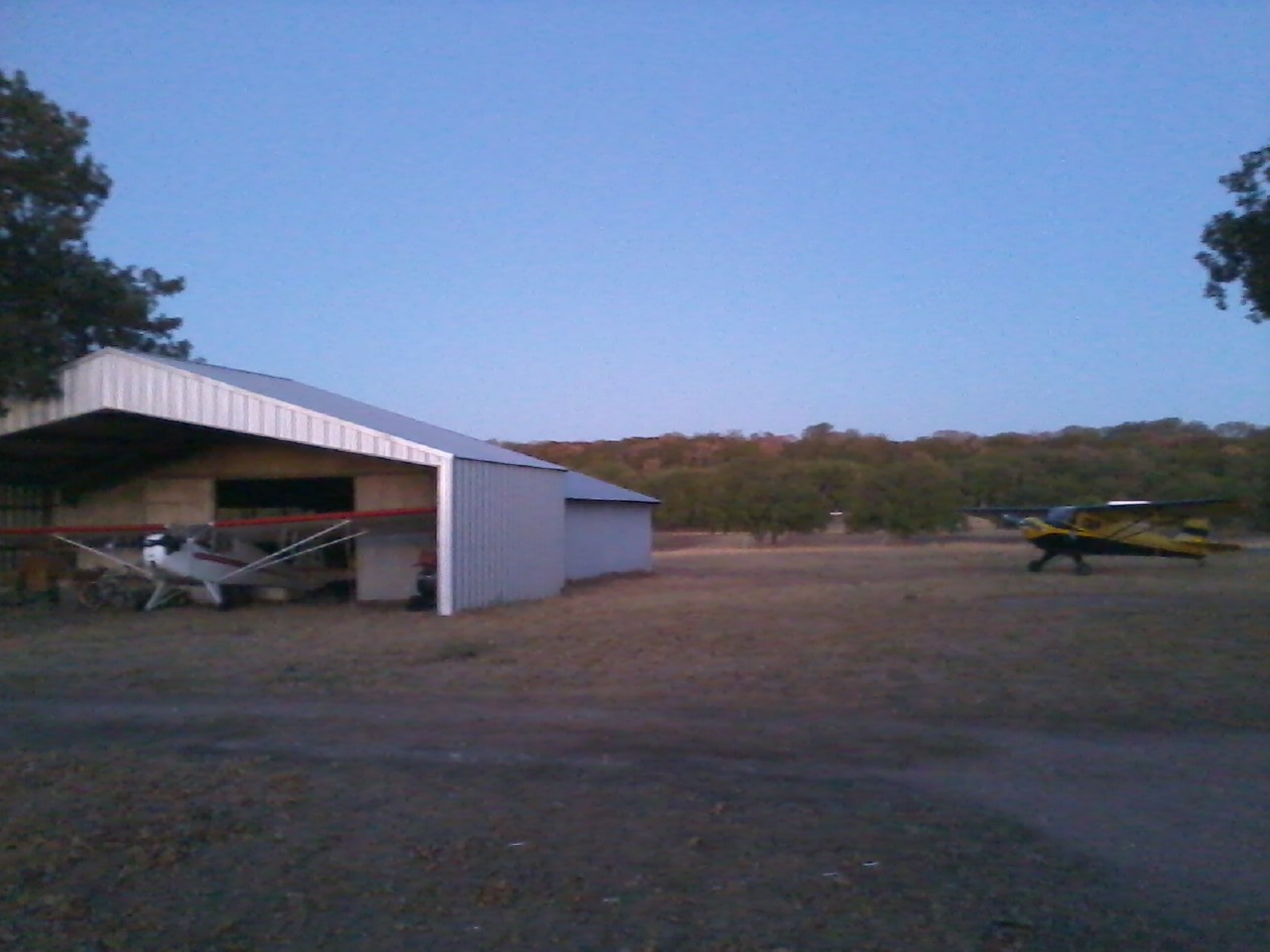

        Not the greatest pic... here is a shot out our back door here at Tick Hill Airfield this week. Changed the bungees this week and some other tinkering on N95598. Yesterday we flew back to Deer Pasture Airfield.
        Lon got started on the engine 100 hour inspection on NC22207 this weekend. Oil changed and steam cleaned engine. Cleaning plugs next. Tomorrow I am helping him out to ground run and do compression check. We'll try to get the engine work done and signed off (100 hr) within the next week or so. Then ferry to Deer Pasture for the Annual work. We'll check the schedule how does Saturday after next sound?

            I have a BAD feeling he THOUGHT it was ethanol free. There are a LOT of stations claiming no alcohol that are actually contaminated with it. The alcohol draws water and damages seals, fails sealant and corrodes tanks. You HAVE TO test for alcohol if you use auto gas!
              Re: N95598: Fuel Tank Surprising Discovery
              That looks more like the remains of an old float cork to me....which will desolve much faster in auto gas then in avgas for some reason...especially if the auto gas had ethonal in it....that shit will eat thru,gum up,and rot out just about anything.
                Another thing you better pay attention to is your flexible fuel lines! Mogas will kill most of that as well...you could have a bunch of crap in the bowl of the carb that you're not seeing either. Just a thought from past experience. One more reason I wont let that stuff in any airplane of mine.

                            ...we recently thoroughly cleaned and flushed out the fuel tank during annual inspection. Since the annual, I have flown exclusively with avgas for around 8 hours with no hint of a fuel contamination problem...
                            Just out of curiosity, in light of the above, why do you blame Mogas?
                            Any chance what you found was, as someone else suggested, the remains of an old float, or the shellac coating, or maybe sloshing compound?

                              I once had a tank of non-ethanol mogas sit in my tank for long term storage. The fuel either evaporated or dripped out over the course of a 18 months. When I refurbished the plane, I got large flakes of varnish (1.5 inches in diameter) out of that tank. My cork float was not deteriorated.
                              The plane flew fine on mogas, but the varnish was incredible. I used a slosh of carb cleaner to clean the tank before I reinstalled it.
