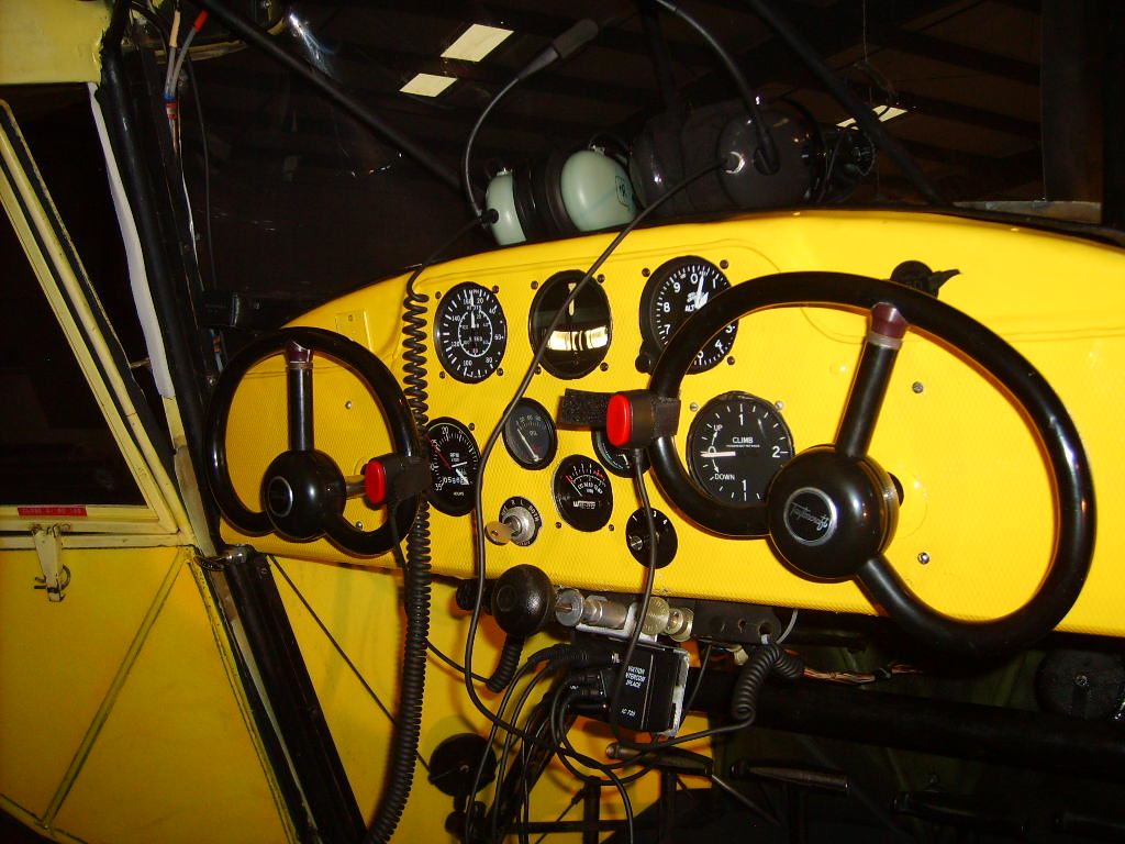

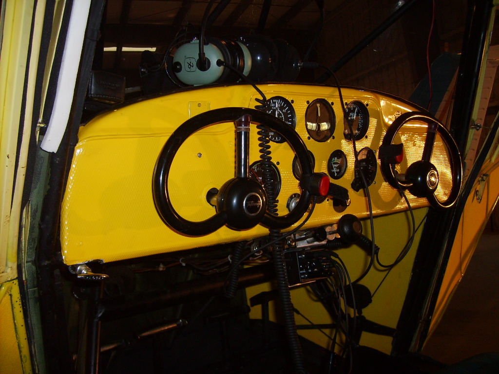

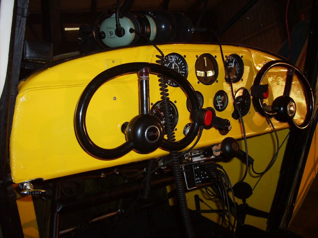

Here is some pictures of the one on my plane you will need to blow them up use ctrl key and plus key they will get bigger Chuck1940 BLT/BC65 N26658 SER#2000

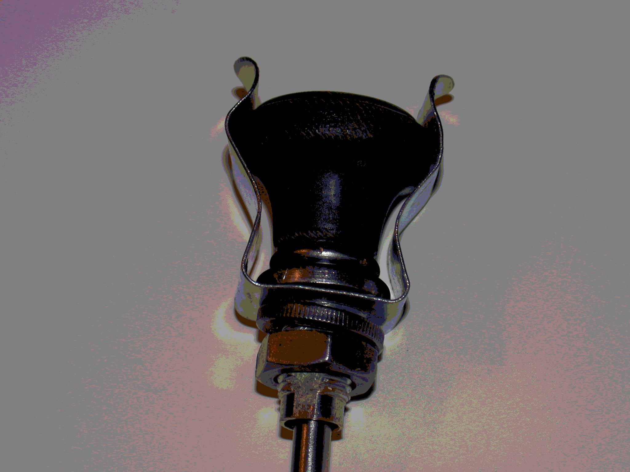

I was making them for a while from thin stainless. I stopped when the blood loss started making me dizzy. ;-)
I have a drawing of the flat shape of the metal and these two pictures show what they are talking about. If there is interest I will try and scan the shape. It would be better from spring steel and it does NOT keep the knob in, it just lets you know it isn't the carb heat your fingers are on! Even the spring steel ones need to be bent tighter every once in a while and eventually crack and fall off (which is why so many planes don't seem to have them).
