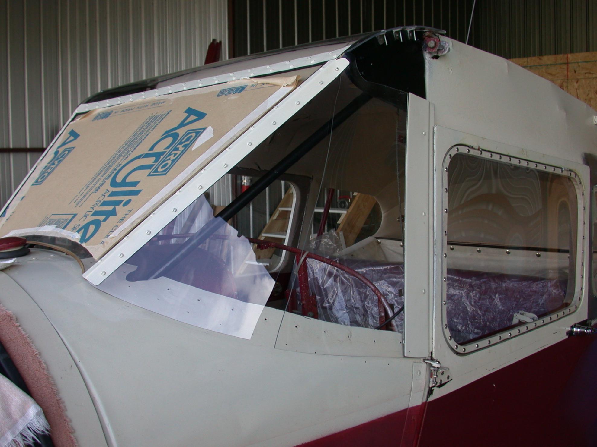

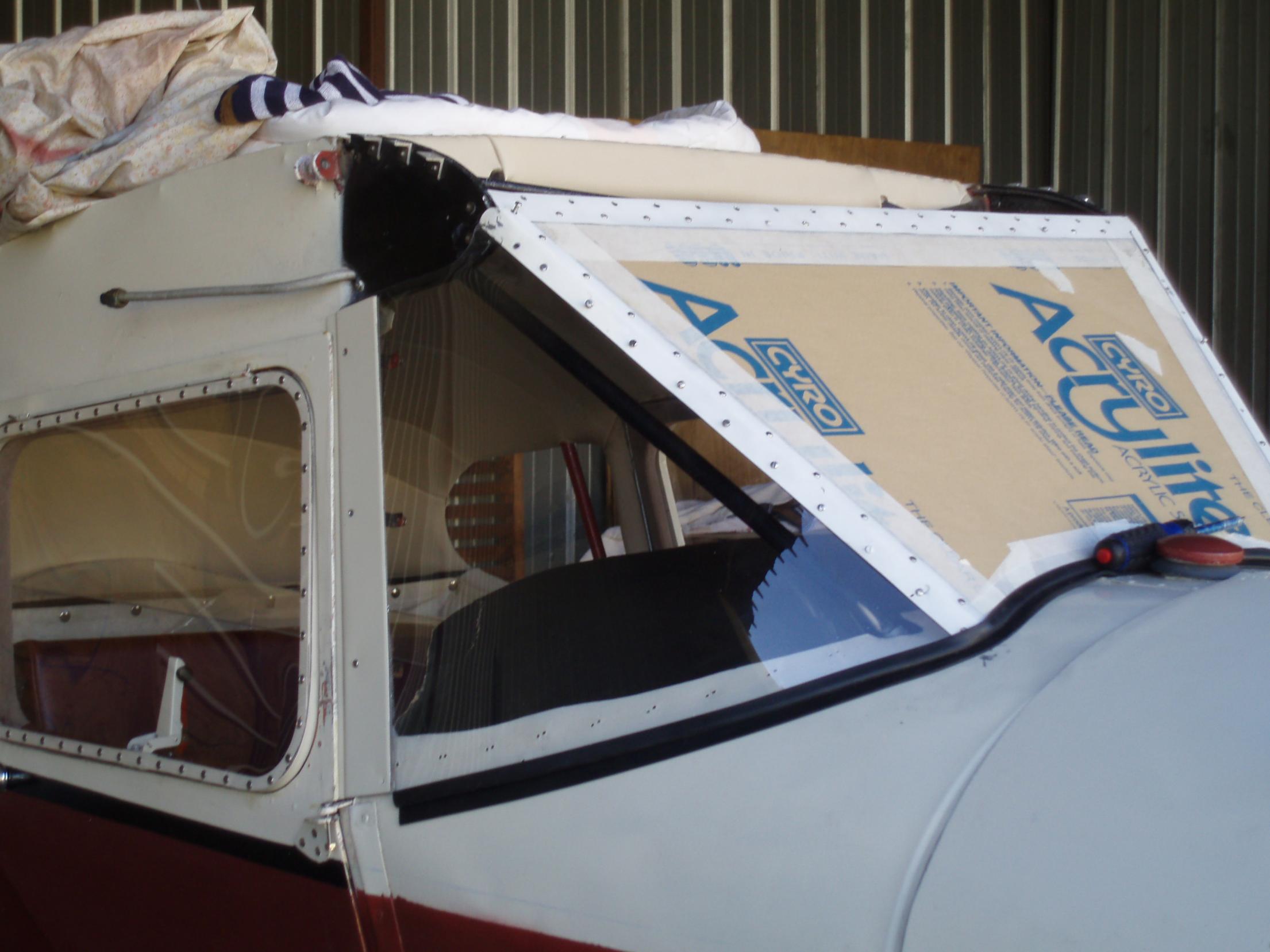

          Just put the vents back on the windscreen instead of the door windows this weekend. Still need to add the hand grabs on the "A" (door hinge) pillars.
          Hank,
          Did I understand your '41 has the divided windscreen? I have been looking at those as a possible replacement for mine as they are fairly reasonable from Wag-Aero. (If they still make them..) Only the blown one on it now ain't broke (much) so not in TOO big a hurry to fix it..
          My vents aren't in the door windows but in the boot cowl (and painted..!). Moving them may get a little involved but that's only a small part of the corrections I need to get done in that area.
          I need to look at sources for some hand grabs. Probably any automotive supply source will have something close. Right? If not then maybe eBay. (L-o-o-ve the black airliner seat belts I found there-) Main trick will be installation I would think.
          Anything beats saying to a first-time passenger, "just reach up and grab some tubing". That really instills confidence in the first-time-in-a-small-plane set. ("...right!")

              Re: Skull Cap Spinners: "Small"
              Bill,
              I have the 4 piece on my plane now and am working on the drawings to share. If Wag has come out with them I am going to CRY!!! They didn't have them when I started and this has been a LONG HARD road. My "blown" windshield only had a few stop drilled cracks but was scratched all to pieces by knuckle headed line boys with filthy rags in their pockets. The second reason I put the original glass back in mine is there is no log entry saying it was ever removed and replaced with the blown one. I know no one would probably notice, but I am trying to pull EVERYTHING that has been added that didn't get logged.
              After seeing how CLEAR the new glass is I really can see all the scratches in the old blown windshield. I NEVER let anyone else put fuel in my plane or wipe my "glass". Send me an email at hjarrett2 at cox dot net and I will put you on the list for the drawings if you want copies.
              I have seen the vents in the boot cowl and they are usually the "domed" ones, not the flat ones. I would keep the cowl ones and just ADD the windscreen ones. On a hot day there is just no such thing as too much ventilation and those ones down on the boot really circulate some air around your legs when it is hot.
              Any upholstery shop can make a set of hand grabs in no time. I plan to have some steel cable sewn in instead of the cotton cord to make them REALLY usable when I get a "heifer" passenger. I just need dimensions from an original and a clear picture of the attach. I know it goes to the diagonal tube at the top of the "A" Pillar, but I don't know how it attaches.
              Drop me an email.
              P.S.
              Yes, that "line" up the windscreen in the pilots side picture is the broken plexi. I have a STACK of broken windscreens till I learned the secrets for forming them! Make them on the HOTTEST DAY of the year in a broiling hangar with a heat gun, then let them heat soak for a few days so the plastic takes a set. A 50 degree day will give you a LOT of plastic to mix epoxy on. Too bad we don't use epoxy on the Taylorcraft.

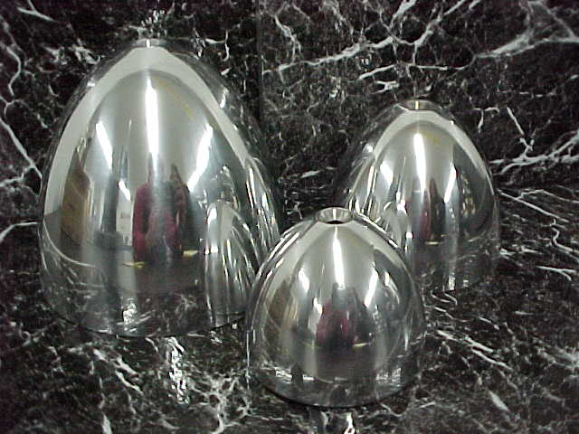

                If no one manufactures a "Skull Cap" spinner similar to the original Taylorcraft shape, I can spin one to your specification. Please read AC 23-27!
                I am four months logged for spinning services, if you can wait.
                  Charles
                  "Different shapes of domes!"
                  Charles,
                  In a word: "Wow"!
                  Yes I guess I can wait. I bought the plane in '03 and it's been one thing after another. Waiting is something I should be used to by now.
                  Looking at the link from Wag I see it is different from the original. Theirs is fatter across the base and the taper starts only about a third to one-half of the way off the backplate. The way I know it's different from mine is in the printed catalog (but not the link) it shows both. But doesn't explain why. In any case neither is an exact copy (I don't think) of the original.
                  If you can beat the Rotax price (which included mounting parts not to be used on any four-cycle engine that I'm yet aware of...) then you likely have a deal.
                  I'll have to see what paperwork is involved with a contracted part but will have to come up with some hard specs for it to be considered a bona fide remanufacture.
                  Factory drawings in my BC12D Service Manual copy only show the prop & hub without the spinner. My 1971 Taylorcraft parts price list for "All BC Models" lists ONE "Spinner Assembly", Part No. B-90140 (price: $3.00). ("Specify Wood or Steel Prop")... *Somehow* I think this is probably not the prewar spinner, being the only one described...
                  (Rotax Spinners: )

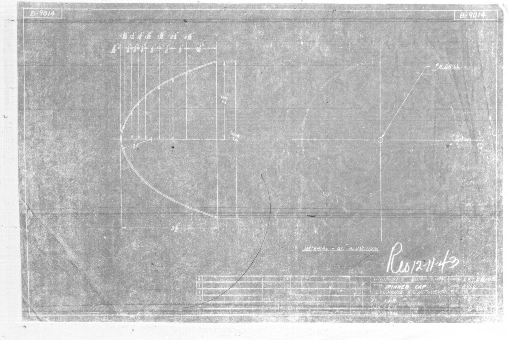

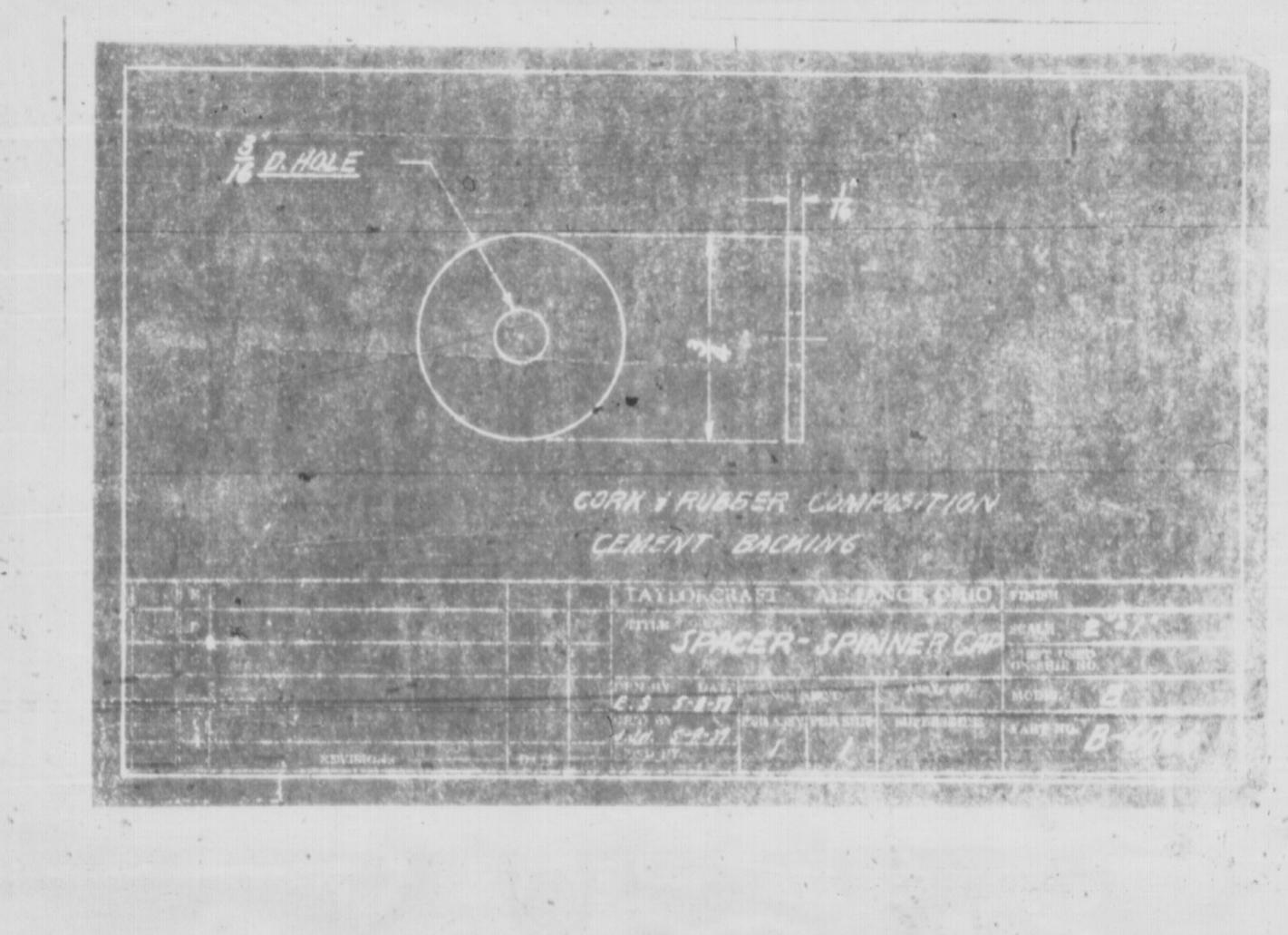

                      Model B drawings and parts list (Prop1.doc) for propeller install. From the L-2 disks but with B part numbers. I would guess most people are not using the spacer. I do not have the strap drawing. Notice the screw is listed as an
                      AN515-10-8
                      Prop1.doc
                        Originally posted by Ron Greene View Post
                        Model B drawings and parts list (Prop1.doc) for propeller install. From the L-2 disks but with B part numbers. I would guess most people are not using the spacer. I do not have the strap drawing. Notice the screw is listed as an AN515-10-8
                        - YES! That's IT! Ron you just hit a Home Run!
                        I can't recall anyone here asking about those early spinners. And here was my answer all along! THANK YOU Ron!!!
                        Do you think it could be fitted to the current bracket? I guess that's the next thing. And AN screw NOT sheet metal! Guess it's true they don't make 'em like they used to.
                        Thanks!
                        (P.S.: These early photos show the original small skull cap to good advantage: )
                        Bill Fife
                        BL12-65 '41 Deluxe Under (s-l-o-w) Restoration
