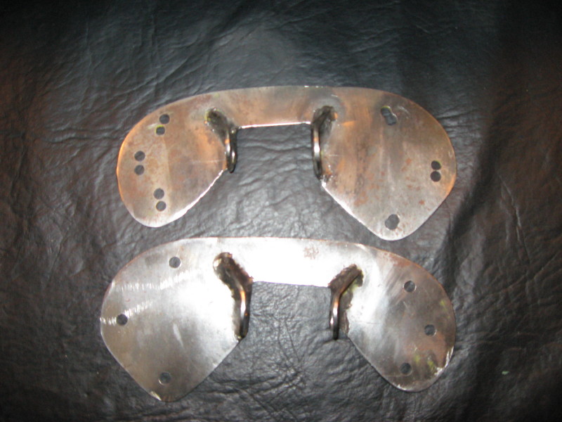

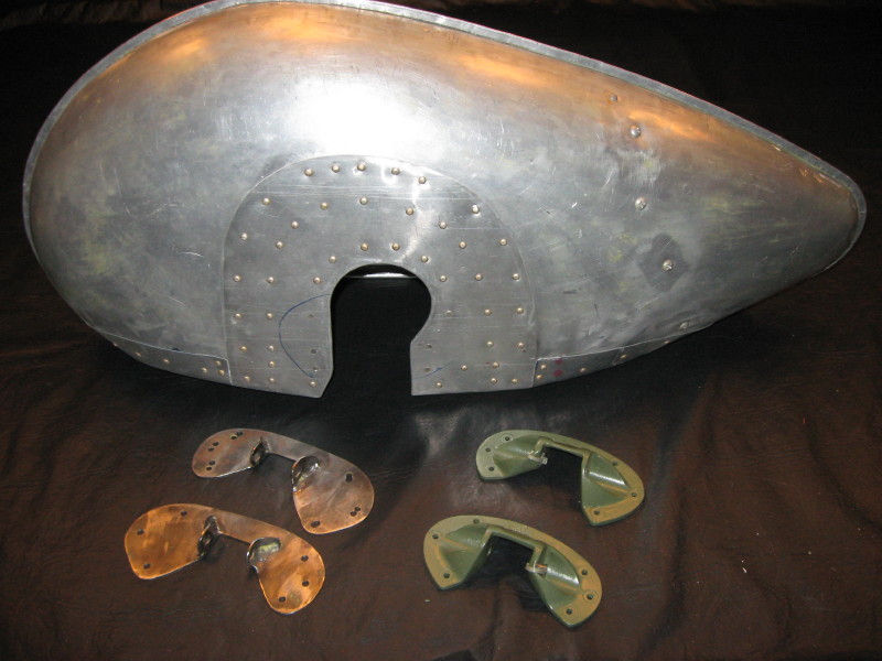

    Ray, I have both the original cast and welded steel type. I bought the welded steel set from a Tcraft guy at Sun N Fun a few years ago. I paid about $50.00 for them. As you can see 1 has more holes then it needs. If you want them, you can have them for what I paid + shipping. You don't need to spend $165.00.

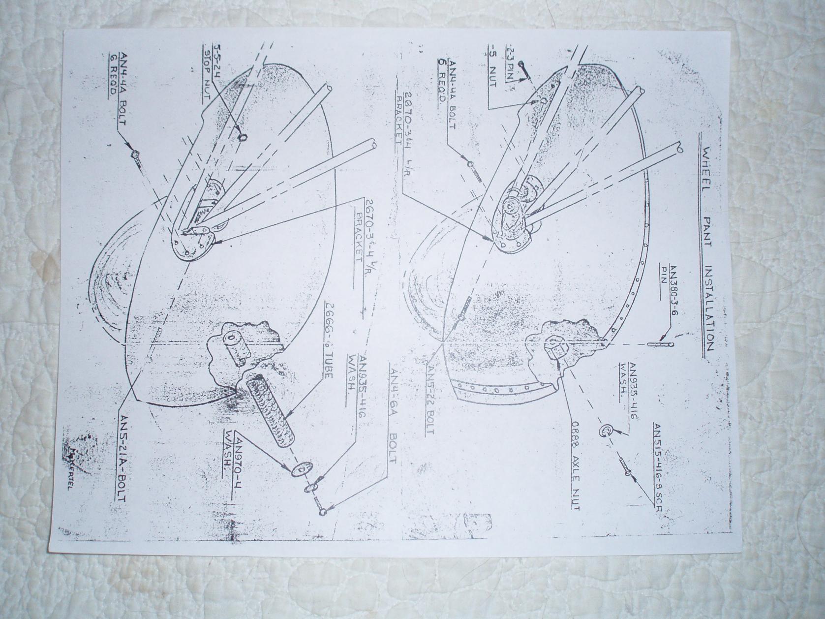

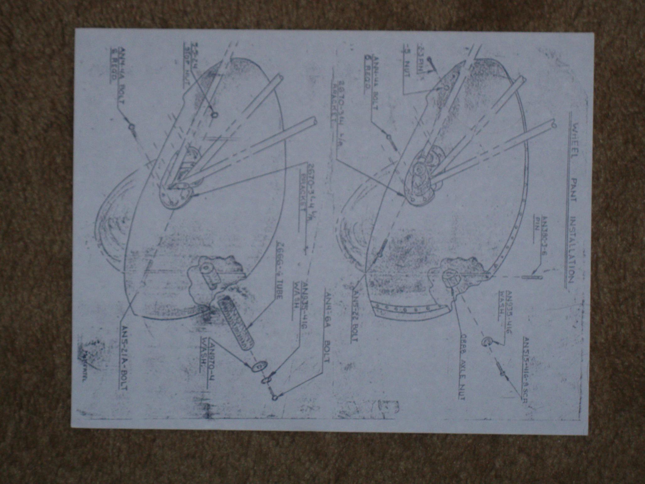

      I found the following in my old Taylorcraft stuff box. I have no idea where it came from but it might make some things a little clearer.

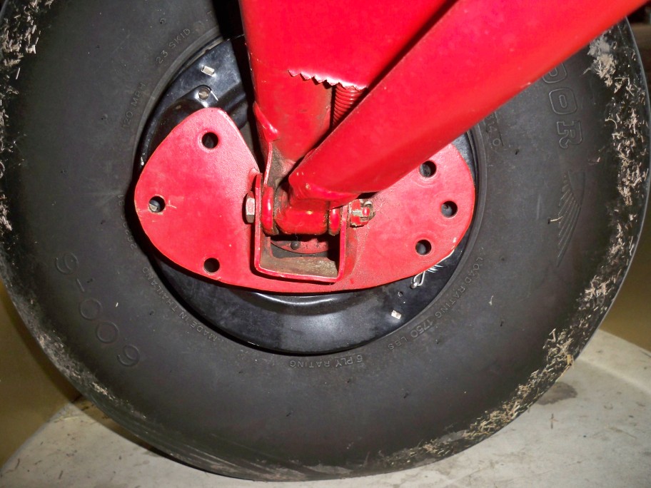

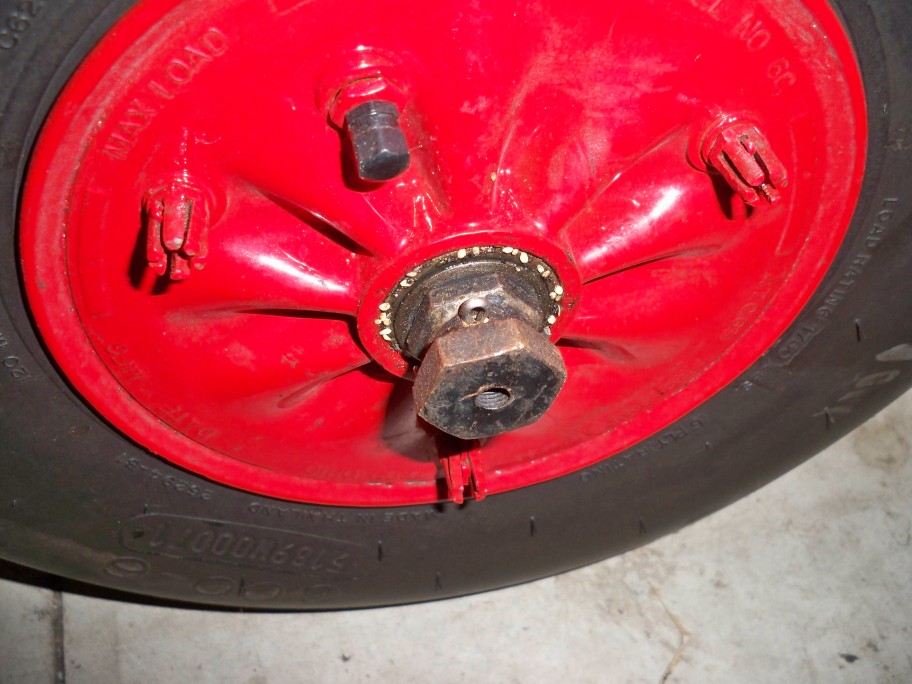

        Finally, I was able to get a couple of pictures taken today. One is the pant bracket and the other the pant nut.
        (Pardon the seeds, I picked those up on landing when I brought her to her new home).

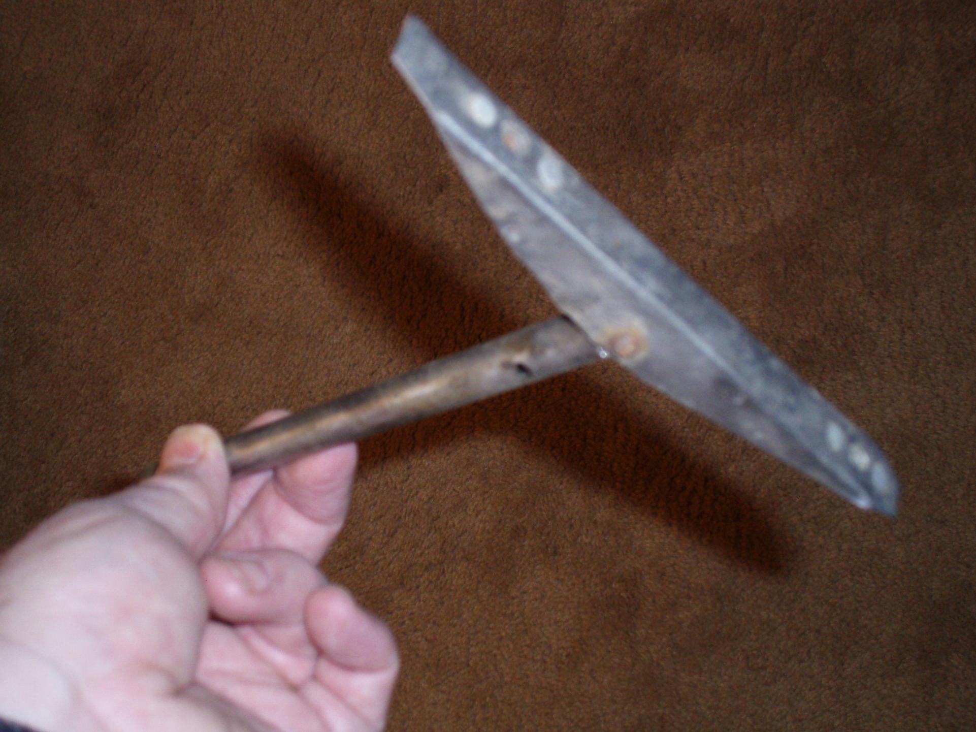

            Re: wheel pants

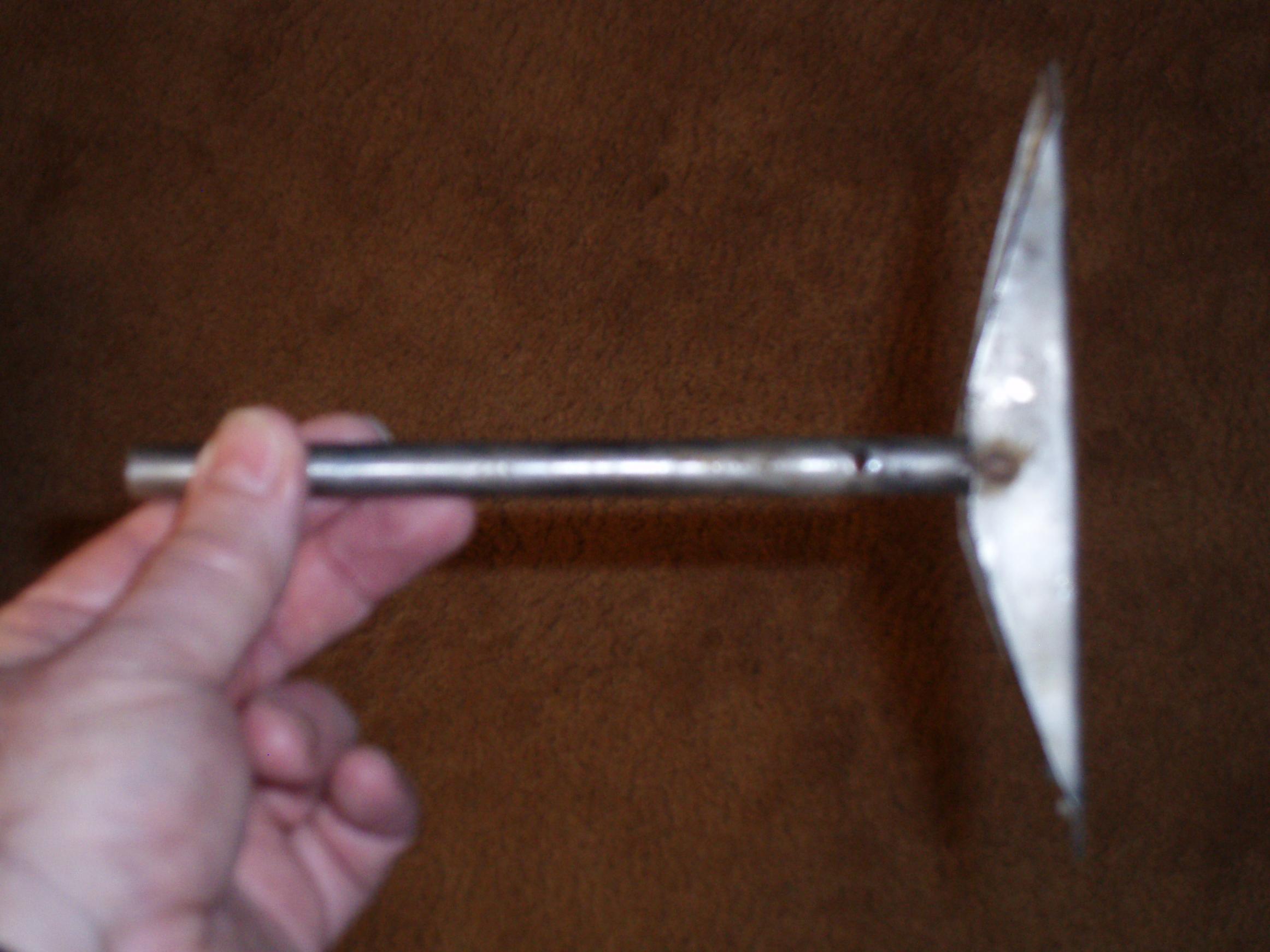

            Found these in the parts box today (found a LOT of stuff today!)
            These are the type of outer pant mounts that slide into the axles with the tube and bolt to the pant with the top of the "T".
