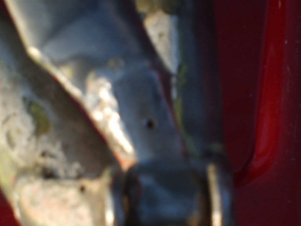

                Gang i had extra left gear leg so i cleaned it and took a photo of the drain hole
                chuck
                1940 BLT/BC65 N26658 SER#2000
