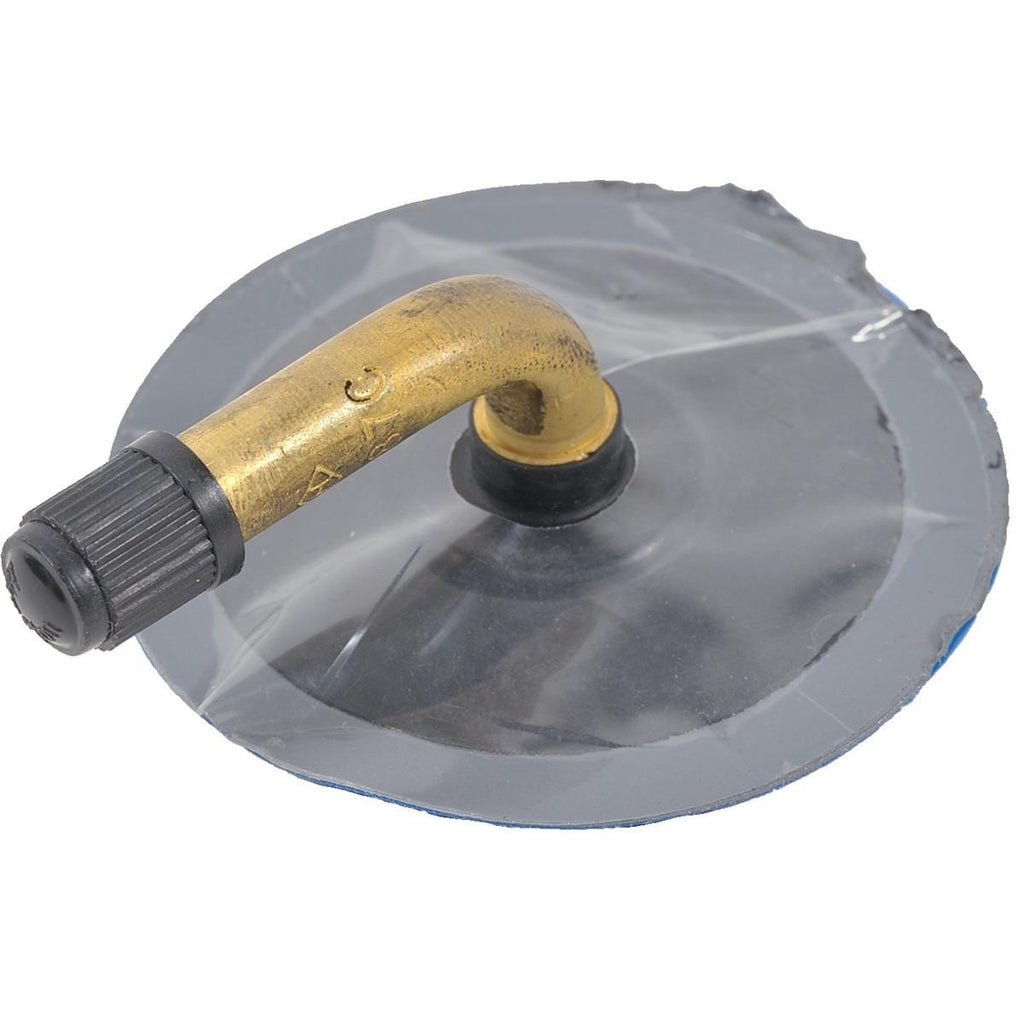

Very interesting, the Gempler valve stem, long 90 degrees. It appears one glues (vulcanizes) this item onto one's tube? Do you cut out the original valve stem and glue this over the hole? Have you done this successfully? Thanks for the idea, I'll have to try it. I can "custom fit" my 6.00 x 6 tubes to the old Shinn wheels!

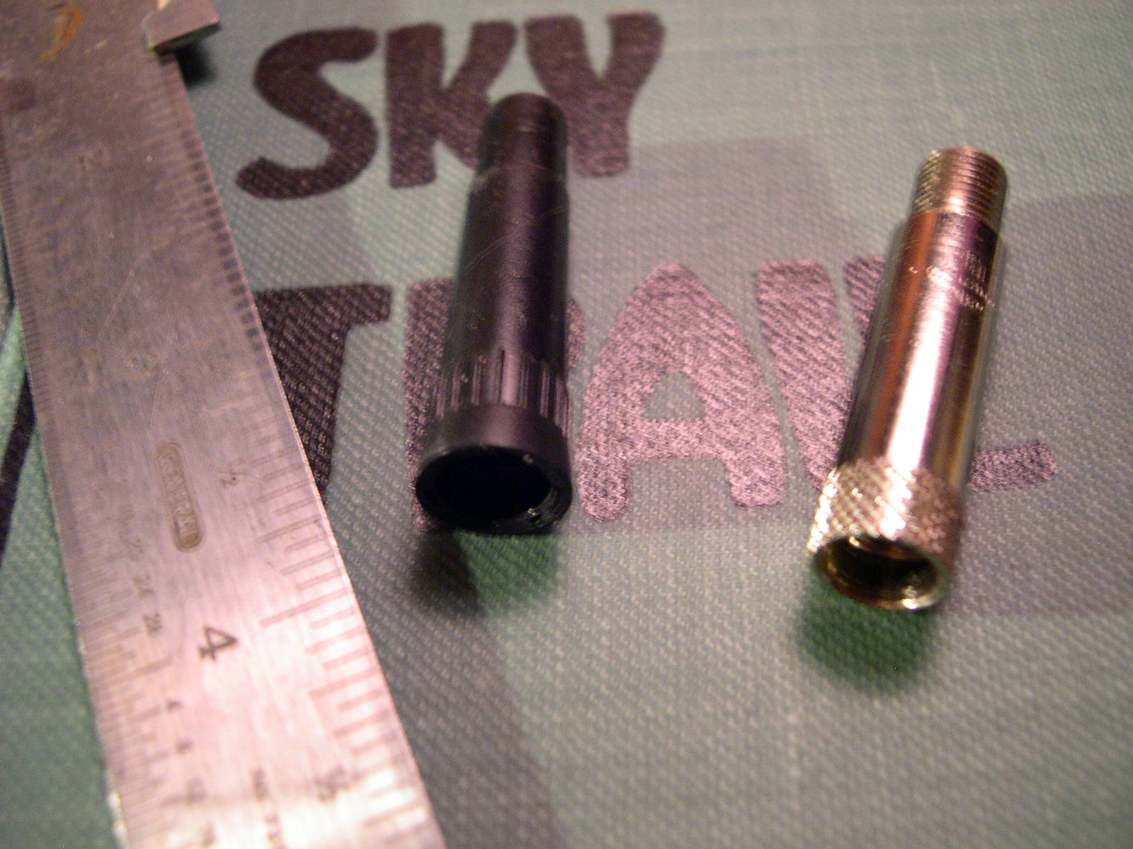

I used valve extensions. Picture shows two types: on the left is a made in China WalMart extension, cheap plastic but works just fine.
On the right is a brass, machined, chrome plated, knurled beauty (made in USA!) from the farm supply store. It's heavier and costs twice as much as it's plastic chinese competitor...but hey. Guess which one I used on my Shinns.Attached FilesBob Gustafson
